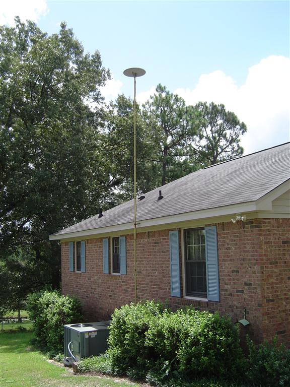

   / Antenna for FM, UHF, VHF? #23
I got tired of messing with rotors long ago. They always lock up and something more to go wrong...not to mention more wiring to worry about.
You can also get an adjustable amplifier if your antenna does not seem to pull in some stations, although the omni does come with one. The one below has more gain, if needed.
Antennas Direct | Micron Variable In Line Amplifier Kit
That's a darn good idea about putting it in the attic instead of outside. Now that's thinking inside the box!
Let us know how you do...

Rotors sound like a PITA. I can see the need for them but thankfully we don't have the need. :D We have a big splitter in a wiring box that has COAX going to each room in the house. I think that box has an amp but it has been awhile since I opened up the box to see. The Directv signal has not had a problem with the splitter. What I am going to do is hang an old loop antenna in the attic and replace the COAX to the Directv dish with the COAX going to the loop. Depending on how the works, I will go from there, but an omni directional antenna seems like it might be the best solution. This TBN conversation has moved me from a more directional antenna to an omni.
We have had multiple lightning strikes around the house with the last one being 16 months ago that took out a large Oak about 125 feet from the house. That oak shaded my wood splitting area and I was supposed to be splitting wood the day the bolt hit. The bolt hit out of a clear blue sky. There was a storm front 20-30 miles west of us and I had decided that I would not split wood because I would likely get rained out before I wanted to quit. I was talking on the cell phone and looking out the window when the flash of white happened followed by the bowel releasing boom! :D Bark blown from the tree almost hit the house.
Putting up a lightning rod, errr, antenna does not seem like a good idea. :D An outside antenna is even more problematic because we have large roof overhangs. I dont' want the antenna mounted on the roof so it would have to be held at the roof edge which is well away from the house wall. Furthermore the side of the house that would have the antenna would require a pole at least 20-24 feet to get to the peak of the roof, much less above the roof line.
