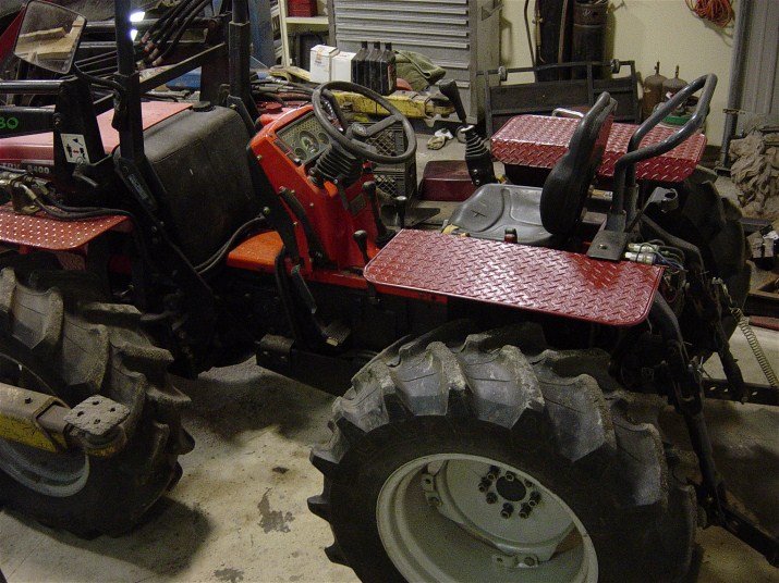

Thank you for all of the supporting e-mails and concern.
There is no way even a meth head could mistake front end loader bolts with frame bolts.... The frame bolts (except for a few) are completely inaccessible because they are hidden behind the body sheet metal... The bolts that would have shown any tool marks must have rattled off of the back of the ramp truck on the 4.5 hour drive...
I would like to show you why I got so excited about buying this tractor.... I spent 2 years looking for a new tractor and I was in a position to buy new. When the dealer I had been working with sent me the Antonio Carraro Tractor People magazine, I saw the tractor I wanted... The TRX set up with the forestry package!!!
I also took the dealers advise and bought the Sigma loader that was designed for it.

If I were on the jury, I'd think that the bolts were never tightened in the factory. That's a heartbreaker of a story. Any possibility that the guys that installed the loader had to remove and replace those bolts? Jake
   / Antonio Carrera Tractors #37
I don't think that there would be a chance for that since half of the bolts are completely inaccessible due to the fact that the body sheet metal completely covers the frame. I'm not sure how one would be able to inspect all of the bolts for tightness either... Thank you for your sympathies.
I think it is extremely telling that they have gone out of the way to ignore the specific indications and paint this as your fault. It is pretty clear that that either by design or faulty parts or assembly your tractor was unfit for actual realistic use with an approved implement. If it is design then the whole line is suspect for anything but rolling around and pulling on stuff.
