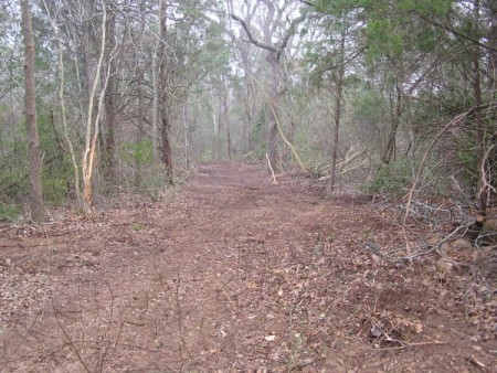

Had some clearing to do and some root diggin' ... the bottom tines on this root grapple worked like a charm /forums/images/graemlins/laugh.gif I've been using my old bucket with a toothbar ... but after digging in the length of the teeth - then the bucket edge hits and now I'm digging with it. Makes it harder to reach those roots and pop 'em up. With this thing - the teeth go down about 12" - pops up all those yaupon by the root and doesn't dig a big hole doin' it. It's Great! Here's a shot of a path I cut for the water truck to reach the creek for my new well getting drilled in a few weeks. --- about 150' - 200' and cleared in 1 1/2 hr. -- amazing to me .... I'm really really happy with this new toy. /forums/images/graemlins/grin.gif
