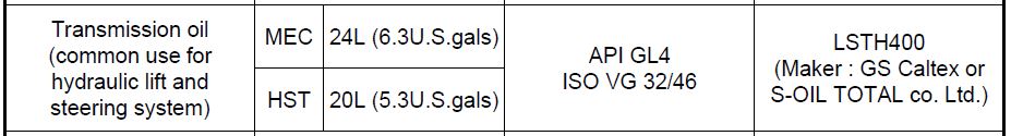

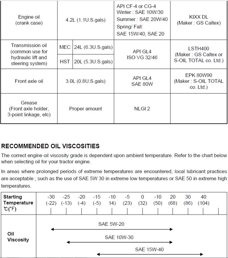

Good catch... I just grabbed the image from the online manual after doing a quick service intervals search, didn't look at the trans type.
