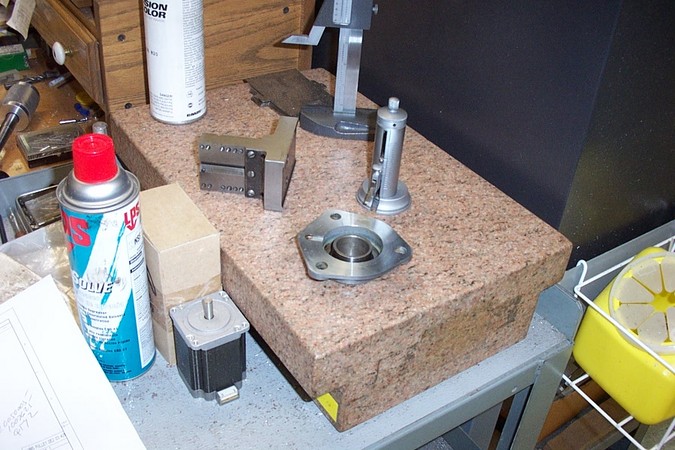

I started putting gear lube in the bull gear pans, the transmission and the belt pulley attachment last night. Looked at the back of the tractor and I was leaking gear lube out of the belt pulley attachment :(
I pulled the bearing retainer/ seal off and layed it on my surface plate at work. The darned thing was warped :confused: so I put it in the lathe and resurfaced the inside face. Looks good as new now :)

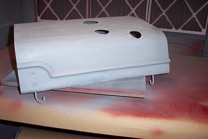

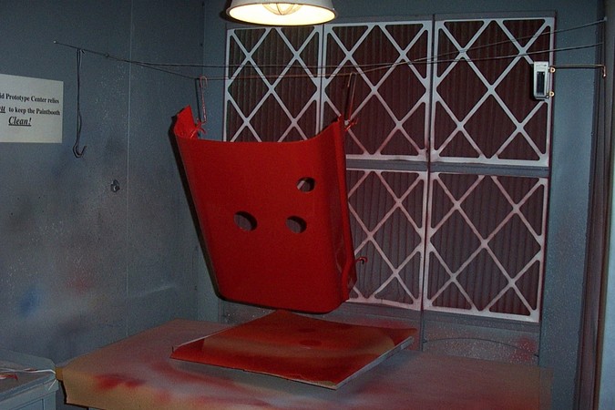

I did some body work on the hood, it was bent up pretty good but its not too bad right now and Im not spendin $125 for a repo ! Here are two shots, one of the hood primed with most of the dents fixed and I shot the hood with paint this mornin !

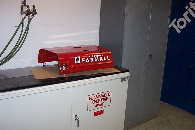

Whats a hood without decals ? :)

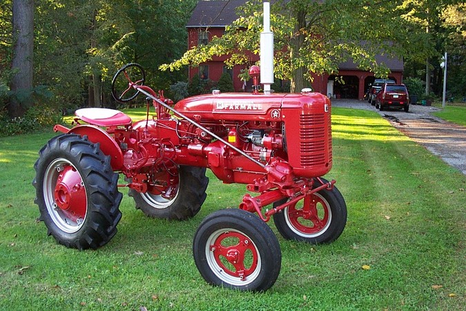

Well, the old girl is up and runnin :) Not without some frustration :confused: No sooner than I get the tractor running and the hydraulics are acting strange, jerky operation or no operation at all :confused: I rebuilt the Touch Control unit along with the hydraulic pump on the tractor and all I can think is that I have to rip this whole unit apart again :( For the heck of it, I opened the upper petcock on the oil pan and all my hydraulic fluid comes pouring out :( Im havin a bad day !!! So the problem gets narrowed down to the hyd pump. So sunday morning I take the pump off and dissassemble and low and behold I forgot to put the main seal o-ring on the driven shaft :eek: Thats where all my hydraulic fluid went via the timing cover directly to the oil pan ! I put it all back together the proper way and everything works great :)
So here is a pic of my new 57 year old tractor on the front lawn at the Ct house. It still needs a few things done to it yet, like the right rear weight and the control rod that goes from the touch control to the rear rockshaft. Oh yes, Im not happy with the hood because of some crinkles and bends so when I get some extra dough I will be getting a new one :)
