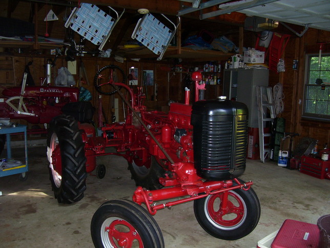

Well I put the repro grill on the Super A and it looks more like Darth Vader than a Super A :)
I guess I better get the spray gun ready :)
The good news is that Im not getting any coolant leaks :)

   / Any Day Now....... Any Day #34
That is looking real good. I am glad to hear that people are making repro parts even if they are pricey.

Hi Beam,
Thanks. Well actually they are only making certain parts for certain tractors. Obviously these guys that are making the stamping dies for these parts know very well exactly how many tractors of that vintage were produced before they spend thousands of dollars on tooling. On the Farmall A, Super A and C these grills on interchangeable. Just the A and B alone accounted for over 200,000 tractors, not counting the C. You can also get the hood, but there are no repro gas tanks. Mine had a significant amount of rust and I ended putting a box of locknuts in the tank along with some solvent and tumbled it for a few hours. Clean as a whistle now :)
Bottom line, certain tractors and certain parts :)
   / Any Day Now....... Any Day #36
Showroom condition Scott...indeed you have the touch!!
Nice calender in the work shop. ;)

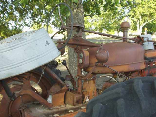

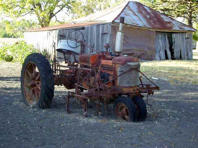

Hey Scotty. I'm not a great Farmall expert, but a friend of mine sent me these pictures of two old Farmalls he passed on the road between Forney and Terrell, TX. I think it's funny that they are rusting away, but they have washtubs protecting the seats. :)
