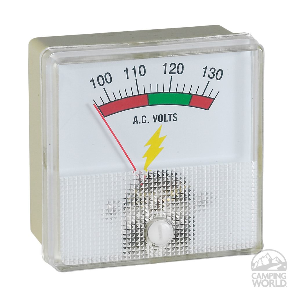

Mystery solved. The problem is in the underground line that runs from my house to my shop. Apparently, it has two lines in it and one is not hot. He moved some of the breakers around and now I have 110 everywhere in the shop again, the only thing I lost was my 220 outlet. I never used it anyway. Thanks again to all you guys for your help. It was fun.

But he didn't tell you why it is not hot now?
Get a plug in AC voltmeter and keep an eye on that leg, it may go away also.
Many years ago we lost one leg to the horse barn. Found it was caused by a nick in the insulation of the direct bury aluminum cable, water got in and the wire oxidized away to nothing.
Camping World has these.

Here is his first post, I took it to mean that it had been working:
Went to use my table saw couple days ago, and no electricity on one side of my shop. Have two breakers and one main breaker; tripping the breaker didn't help. It's kind of strange, that only one half of the shop has no electricity...I'm no electrician, but it seems that maybe the breaker is bad? Can't imagine what would cause that; only thing that runs continually on that breaker is a clock and a telephone. Lightening cause something like this maybe?
