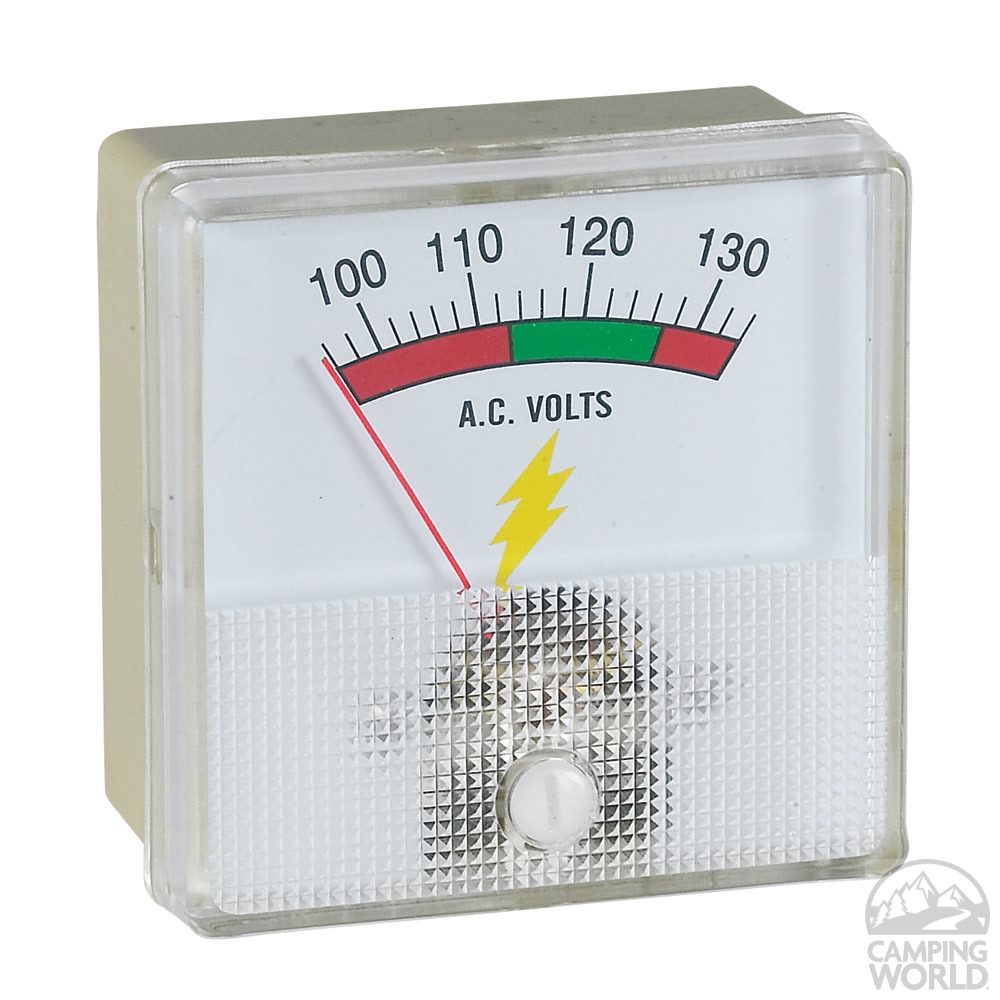

But he didn't tell you why it is not hot now?
Get a plug in AC voltmeter and keep an eye on that leg, it may go away also.
Many years ago we lost one leg to the horse barn. Found it was caused by a nick in the insulation of the direct bury aluminum cable, water got in and the wire oxidized away to nothing.
Camping World has these.
