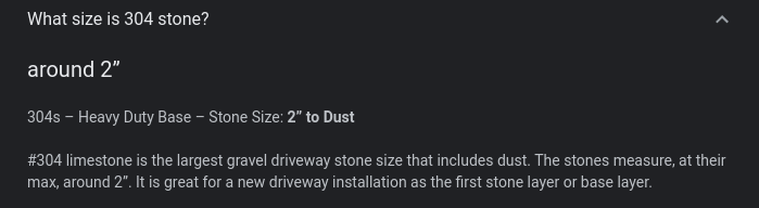

57s are not good top coat for parking, 304 is better option.
   / Any Excavation Professionals Feel Like Giving Advice? #20
For those of us that don't work in the excavation or road building fields, what is #57s and what is 304? (The #1 and #2 stone is defined in post #9.) I've heard of "3/4 minus" being used for "road base" which I've found out there is a particular percentage of sizes from 3/4" down to "fines" and that there are 3 or 4 different screen sizes involved.
