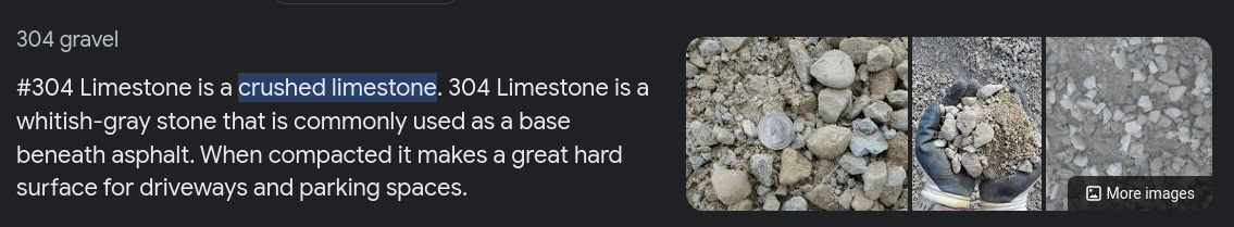

For those of us that don't work in the excavation or road building fields, what is #57s and what is 304? (The #1 and #2 stone is defined in post #9.) I've heard of "3/4 minus" being used for "road base" which I've found out there is a particular percentage of sizes from 3/4" down to "fines" and that there are 3 or 4 different screen sizes involved.
so what is 304 ?
Never heard of it; road base terms are crazy regional. We probably have a similar material, but we might call it screenings; #83; crusher run; rail rock; ect, and I just don't know of 304.
Add to this; asphalt, the number is the size, in mm, of the largest aggregate size; (Sp-12.5=super pave, 12.5mm/0.5" or FC-9.5=friction coarse, 9.5mm/0.375") But old Marshall mix a S-1 is 1/2" and a S-3 is 3/8"....
yes i see this myself out here it be describe as granular A, B, the B2, B3 ectera … I think 304 it’s granular A (1” minus) but not sure.
