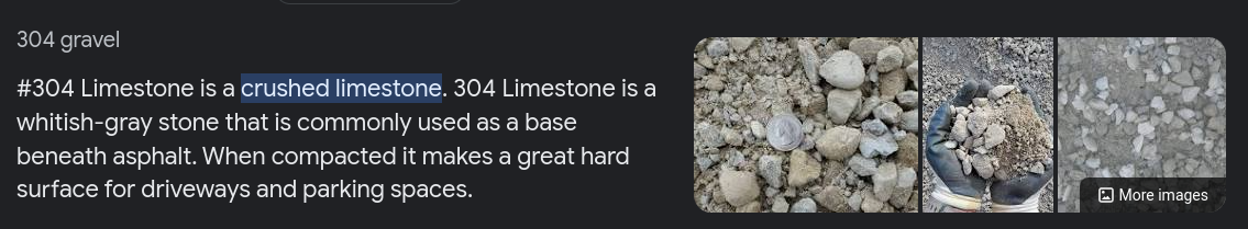

2” minus is the best of the best, it is super heavy and compact super good therefore super expensive. It is use as a base like it said and since the biggest pebble are two inch it’s hard on tires so it’s best to cover it with 3/4 inch minus.

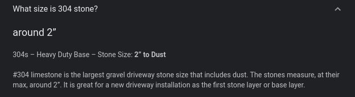

So,,,, someone explain to me how 2" minus gets called 304? Or 57?
Where's the correlation to logic?
#57 is 1.5” to 1” (pure stone)
304 is 2” minus …
i don’t see the logic

304 is odot specification number since op is in Ohio. It is one inch minus.
57 are stone sized between the 5 and 7 standard sized sieves
