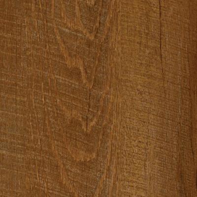

OK we ordered the Allure Ultra Arizona rough cut and it will be here at the end of the month. Told you we were using tile :D
My girl has 100% control on this remodel since I handle the farm. See, I can take direction!
I figure my install time and effort has been slashed as well.
My baseboards are white, with this color floor I'm not sure if the quarter round I will have to install should be white or a similar color to the stain? I need advice on that.
I also have some plywood that is different heights at a few seams so I need to deal with that. Would it be a fools errand to take a belt sander to them or should I use a leveling concrete or similar? The people at Depot really didn't seem to know because the chemical they gave me to remove the glue from the previous tile in the kitchen and bath says not to use on plywood and the powered concrete they gave me says pretty much the same.
Here is the sample.

The quarter round color is a personal choice. I've seen it both ways and prefer it to match the casing and baseboard color. Let the boss decide. :D
   / Any floor tile installers? Putting down a tile floor.. #20
Just get some wood putty type compound, I like to use Rock Hard, but that is a specific product that may not be available in your area. Take the " putty" and spread it over the low side of the seams to feather out the transition with a 12" Sheetrock trowel. If necessary sand smooth.
That should give a much better transition than just sanding the edge down, and probably be a lot faster. Good luck
