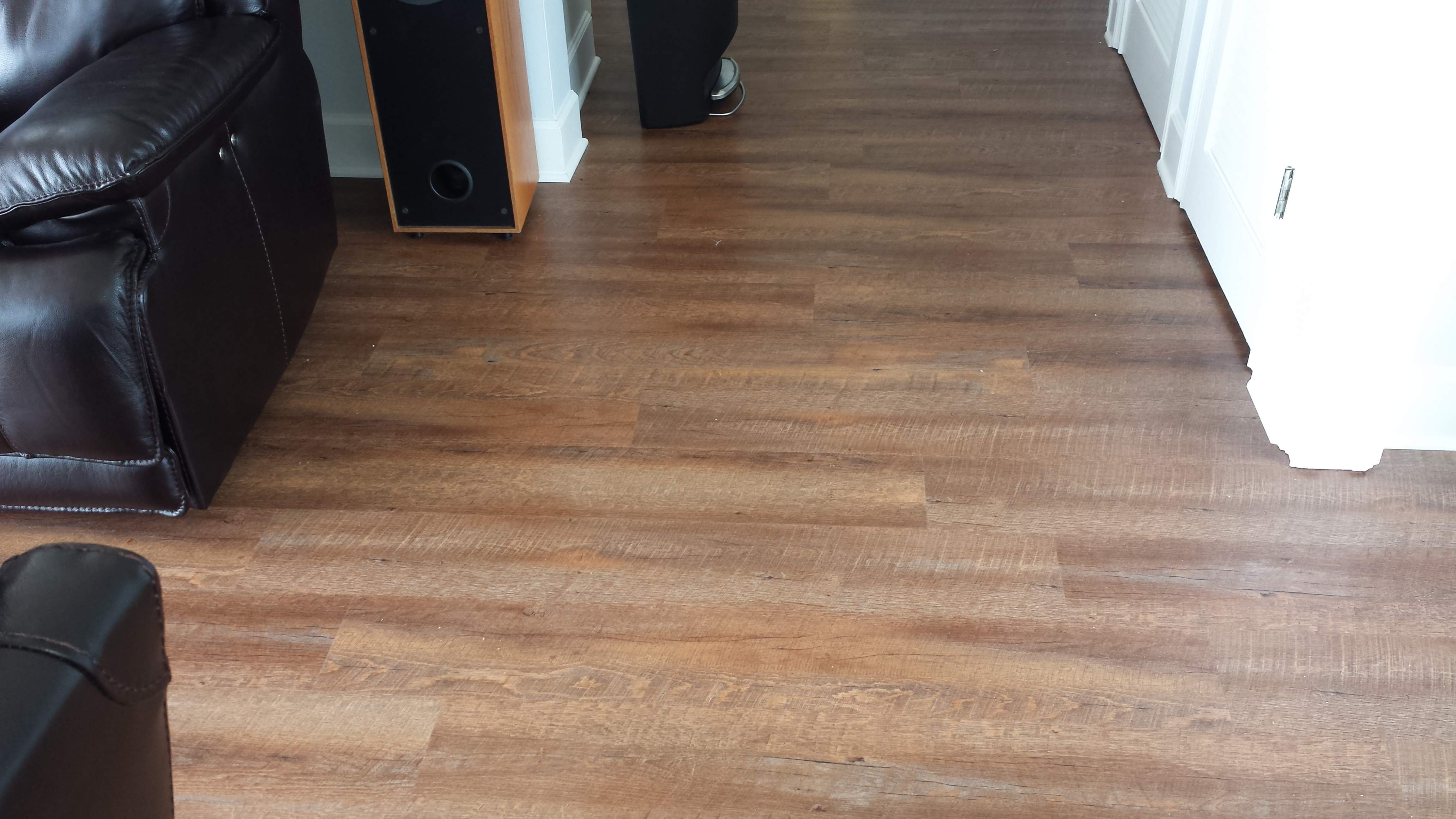

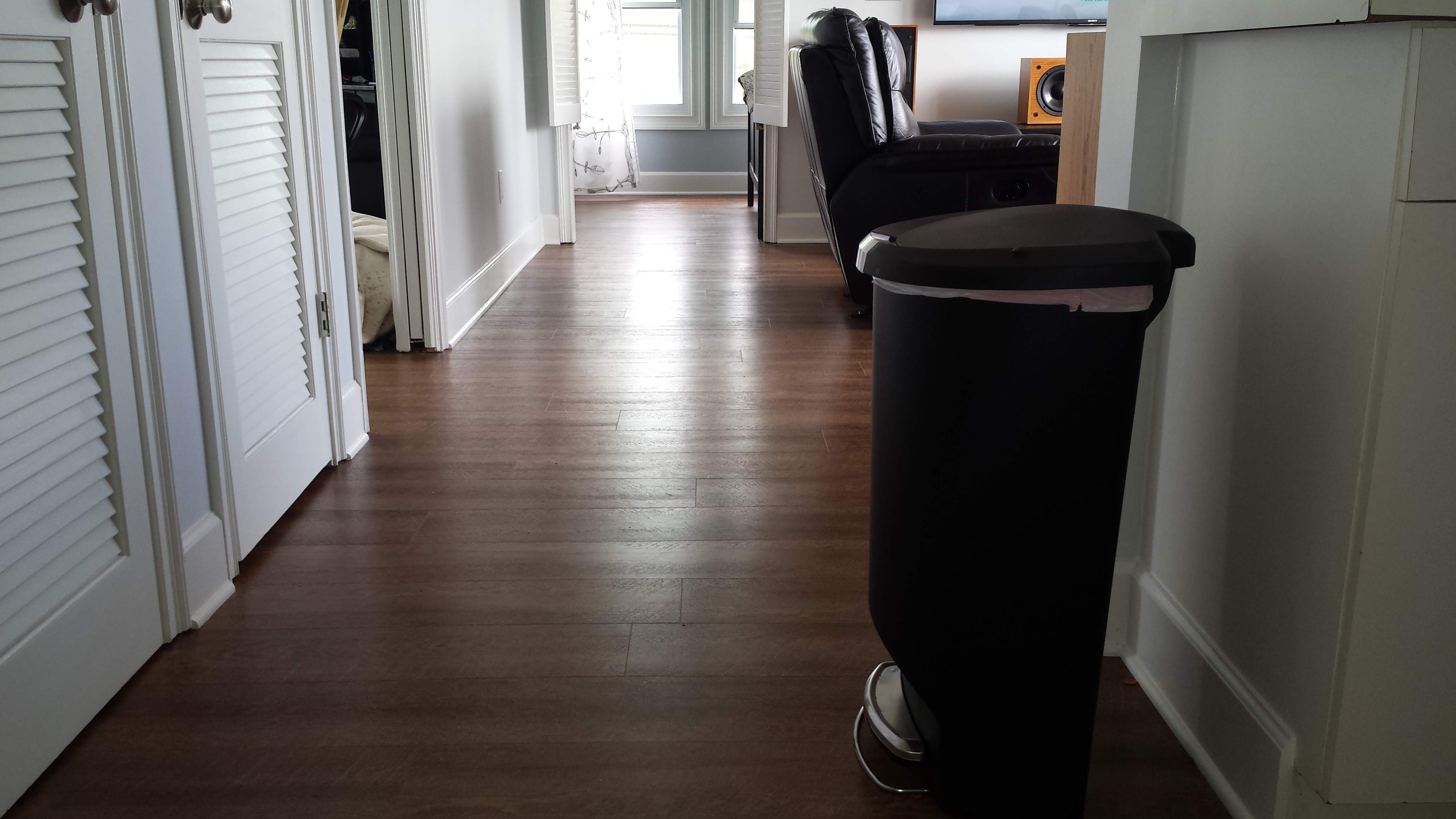

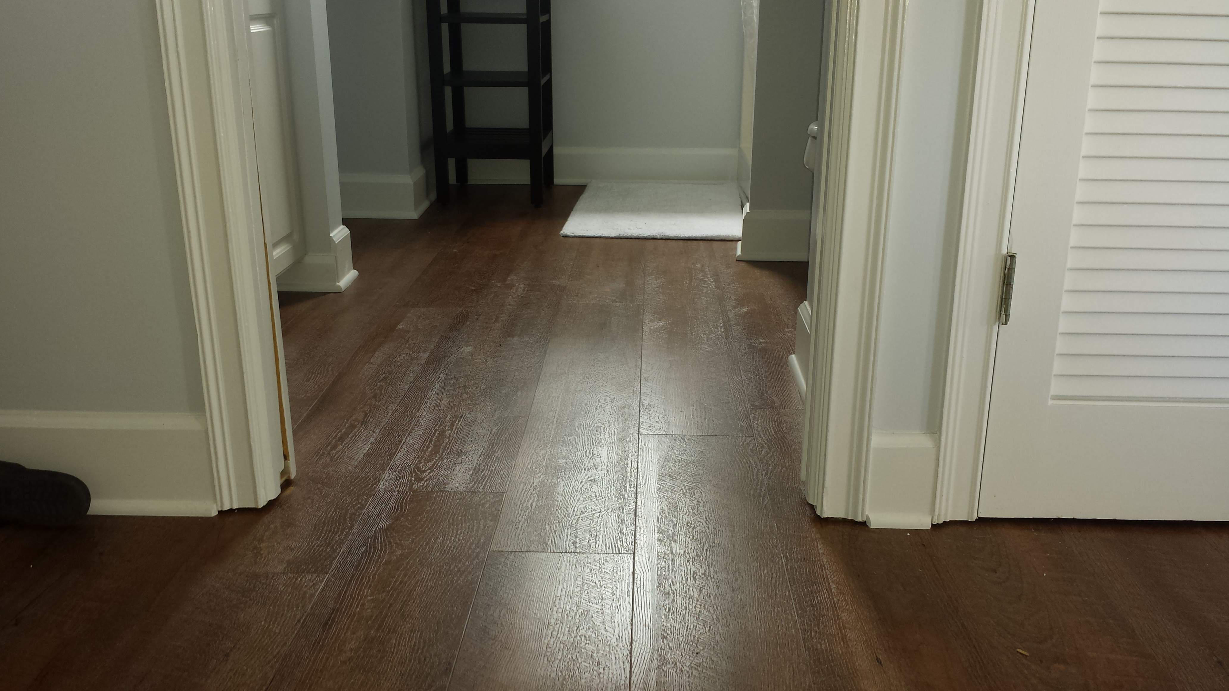

I finished the Allure Trafficmaster floor a couple weeks ago and wanted to share my experience after receiving the same help here.
I really liked installing this. You just need to make sure all the seams are tight. Don't notice a loose seam an hour later and have to remove a ton of planks to fix a mistake! I did but I got lucky. I was able to drive screws into the subfloor next to the baseboard and tap the seam into place.
It's not to say some doorways weren't a challenge. I had 3 areas where I spent easily an hour or more to get it right but I did. I'm not sure a contractor wouldn't be looking at his watch and opting for a shortcut.

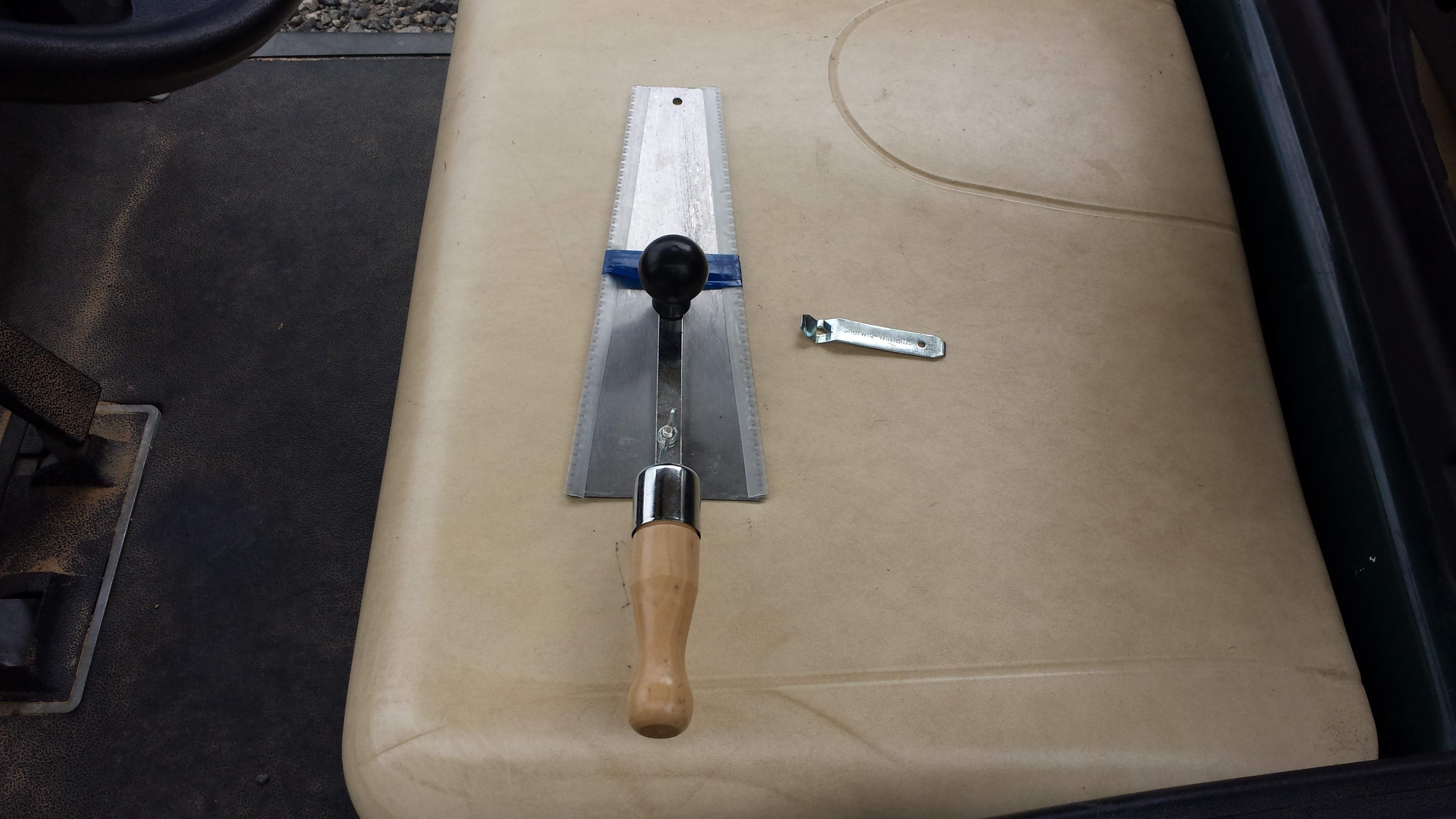

Here are 2 tools I found very important. An undercut saw for cutting door moldings and a paint can key from Sherwin Williams. The paint can key was a lifesaver getting the last plank to snap in near a wall. I used and abused 2 or 3 of them. Just go into a store and ask for one, they will give it to you. The action end of the key was used to pry from the baseboard. I'm not sure how others did it but this worked perfectly.
As far as the glass doors, we ran the planks right up to the aluminum frame. Hopefully when the floor expands and contracts, it will move in the other direction sufficiently. Time will tell, I'll update later if needed.
I wanted to shoot some video while installing but all this was done while still operating a horse farm 7 days a week :laughing:
Here are some pics and a video of the 99% finished remodel.
Oh, we put new Hardy plank on the barn too :D20140906_173012_Richtone(HDR).jpg20140925_140821.jpg20140925_140450.jpg20140925_135418.jpg20140925_135350.jpg20140925_140846.jpg
