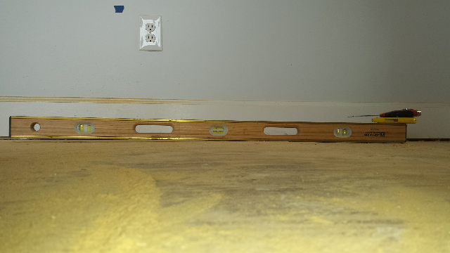

I need more advice! In the picture, the right handle is directly above the seam. I have it flat
now, but on the far left of the level it is 9/16 lower.

I fired up the laptop and found the instructions for installation. Page 4 says 1/8" in a 4' span needs to be leveled or the interlocking wont be secure.

Looks like you have trouble.
You would have never been able to put ceramic planks in that room, the way it is.
Luck isn't going to help much here, you will need skill. Hope you are up for it.
Thin set is still an option, but would require skill.
Self leveling cement would be another option. It's expensive, and requires you to make certain you plug every possible exit point. Any small hole you miss, will result in cement migrating to the areas below. It's also not totally fool proof.
Another option would be to pull the floor up, shim, grind, or plane, the floor joists, until they are level. Then, install new tongue and grove plywood.
The last option is probably the better way to go. But it's hard to say from here.
Floors like that, are why carpet was invented.

Well, the good news is that the heat pump was replaced this afternoon giving me a reprieve and now we have a cool environment in which to work.
The culprit is a beam from front to back on the right 3rd of the space. I've started grinding the plywood down but even if its 3/4 that hardly leaves me much, making up for a 9/16 ridge.

Look and see if you can find a supplier in your area of self leveling cement. That's going to be your best bet.
