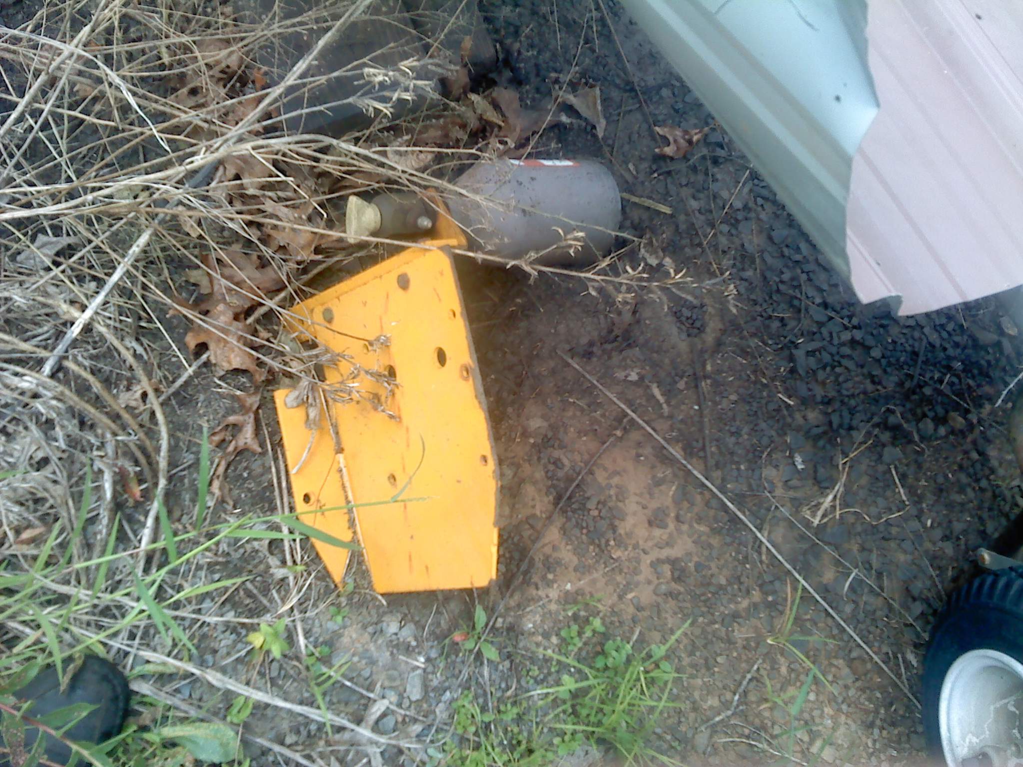

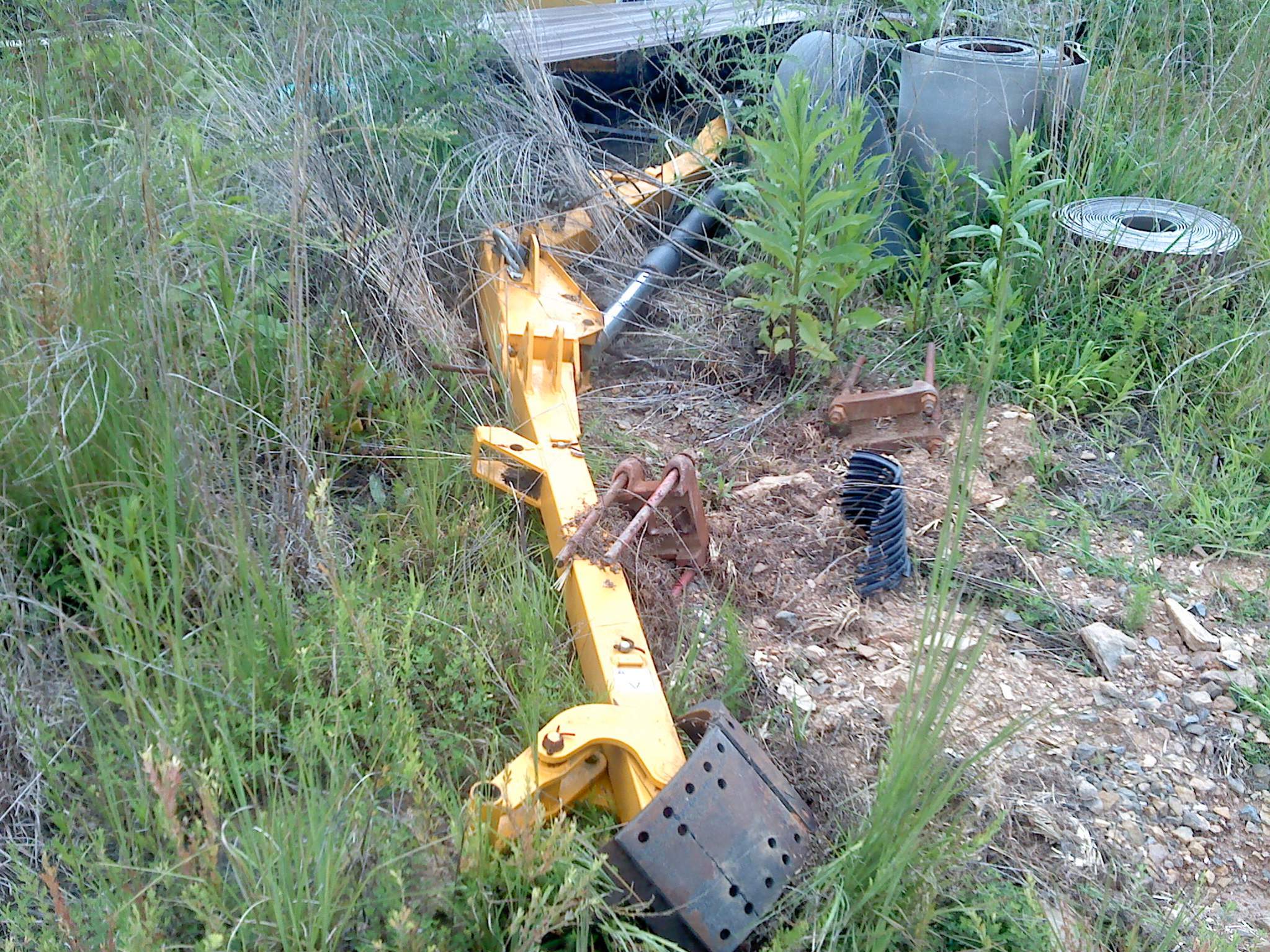

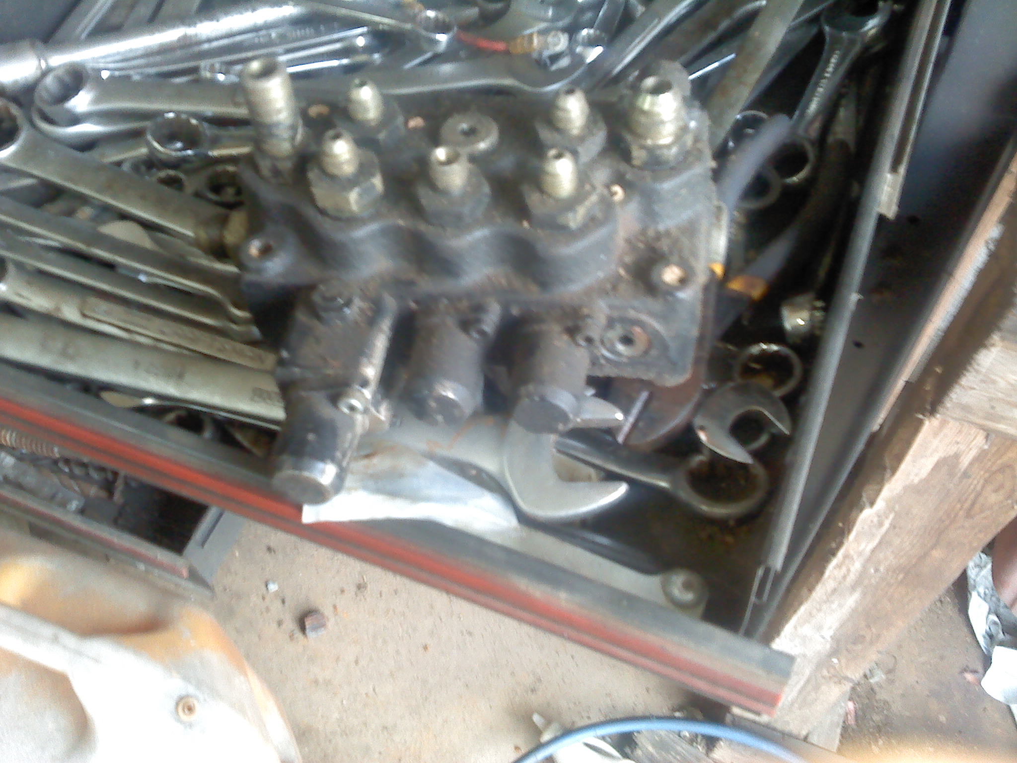

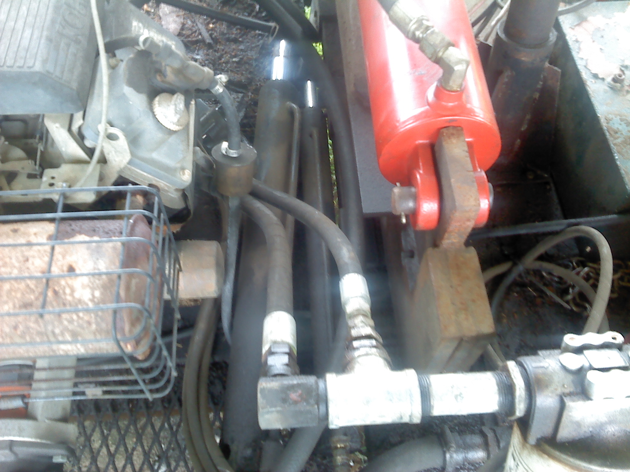

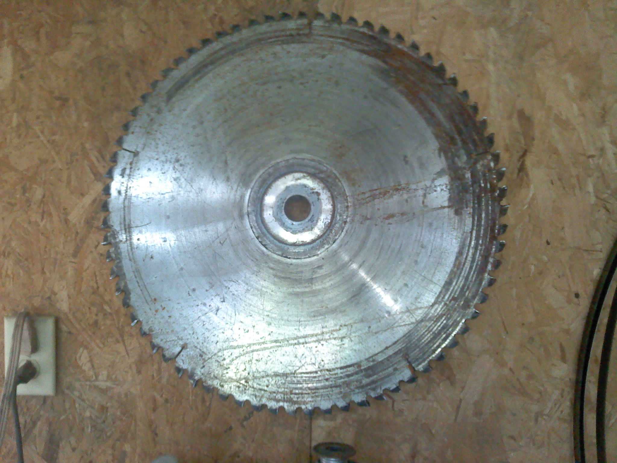

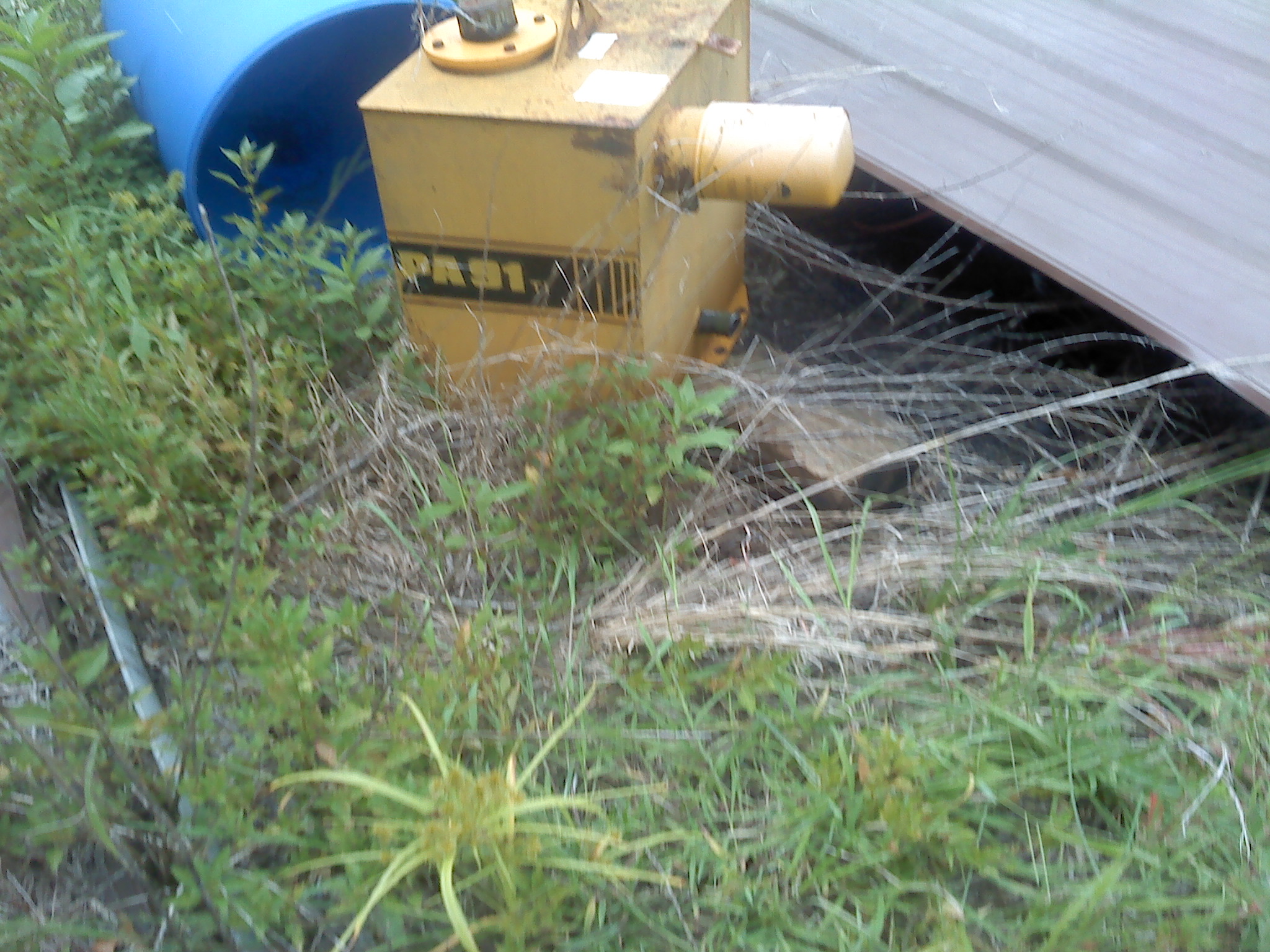

Well, grabbed a few pics of boom and blade, plus what remaining parts I knew I still had. 0829151331.jpg saw blade is 24in, 70 tooth, carbide tipped, 1 1/2in bore, with probably half the carbide missing. Hit some concrete I think. Blade can be retipped about half the price of a new blade. 0829151333.jpg boom is about 12ft, give or take a little bit. It does have the flex back in middle. Not sure I still have the pins for it, I donot have the base where it hooks to the 3pt, nor any of the pumps.. 0829151334.jpg cable controls, Cables where sticking when removed, but they can be replaced reasonable. 0829151338.jpg control valve, is not power beyond capable.0829151335.jpg Hydraulic tank, 25gal I believe. 0829151337.jpg accumilator, have no ideal if its still good. Was working when removed, but been setting where you see it now for 4 or 5 years. Rest of the boom cylinders. I had them hooked up to a boom on my wood splitter but swapped out boom for a different one. These cyl are still hooked up because they use a odd ball #5jic fitting and I didnt have any caps to fit the hose ends. No, the hoses are not some metric something or other, they are #5jic, done been there and done that when looking for fittings.
Anyways, if anyone is interested, pm me for info how to get here.
