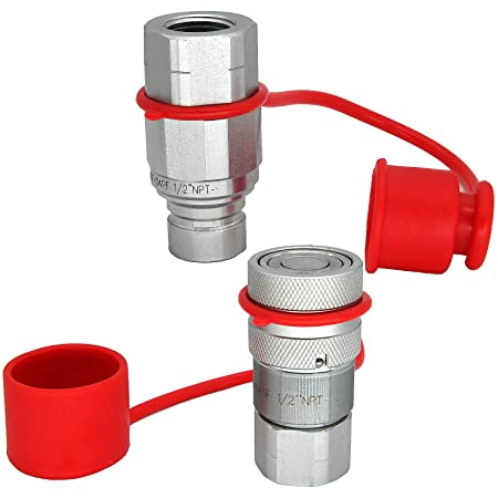

Can someone look at the photos and tell me if this is the skid steer quick connects. I honestly thought my Ford 4630 had those but it’s a little different than what’s on this grappler. Will upload a photo of the 4630 connects in a minute.
   / Any idea who made this grappler #25
skid steer quick connects:
Also called flat face couplers.

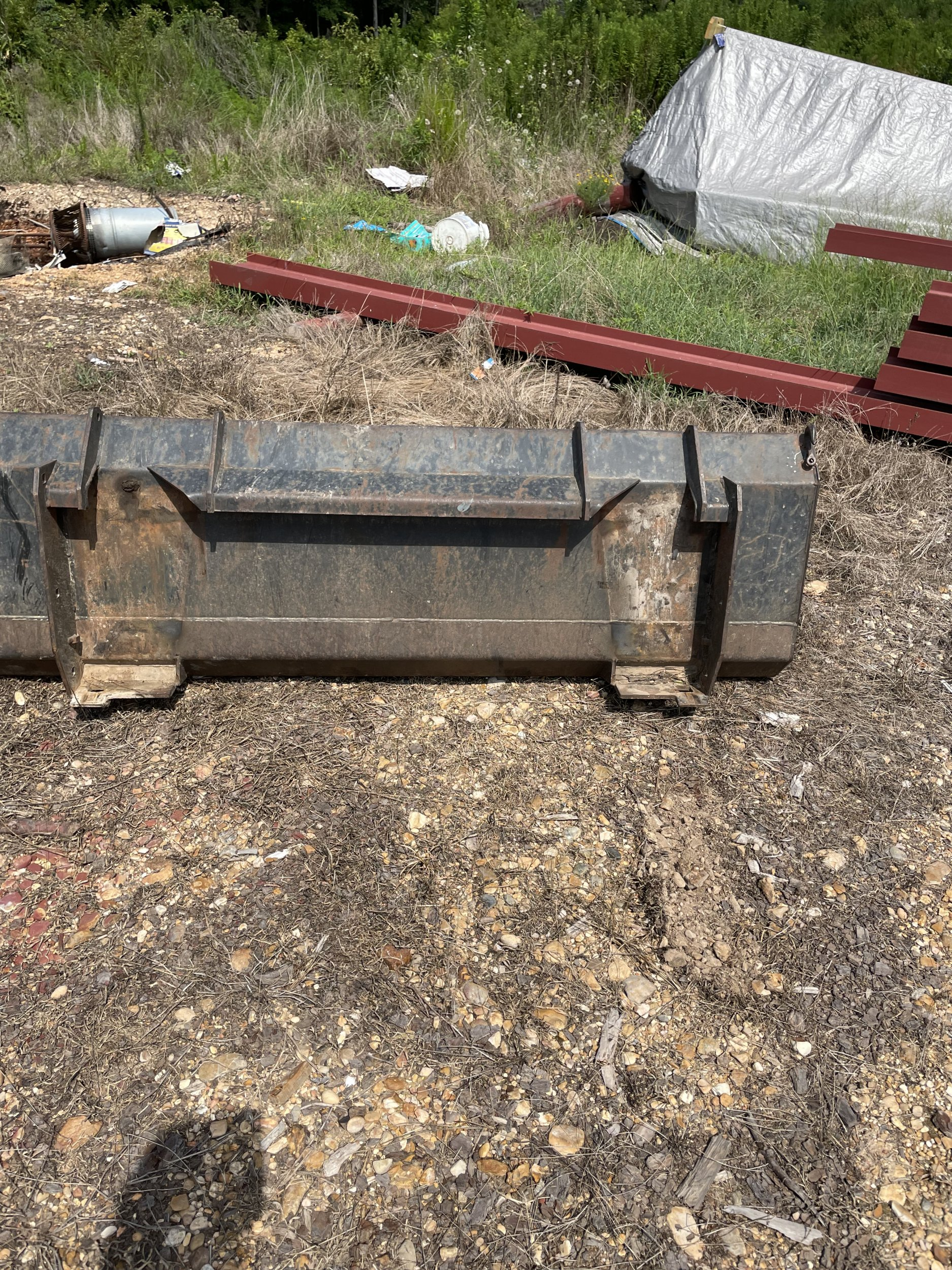

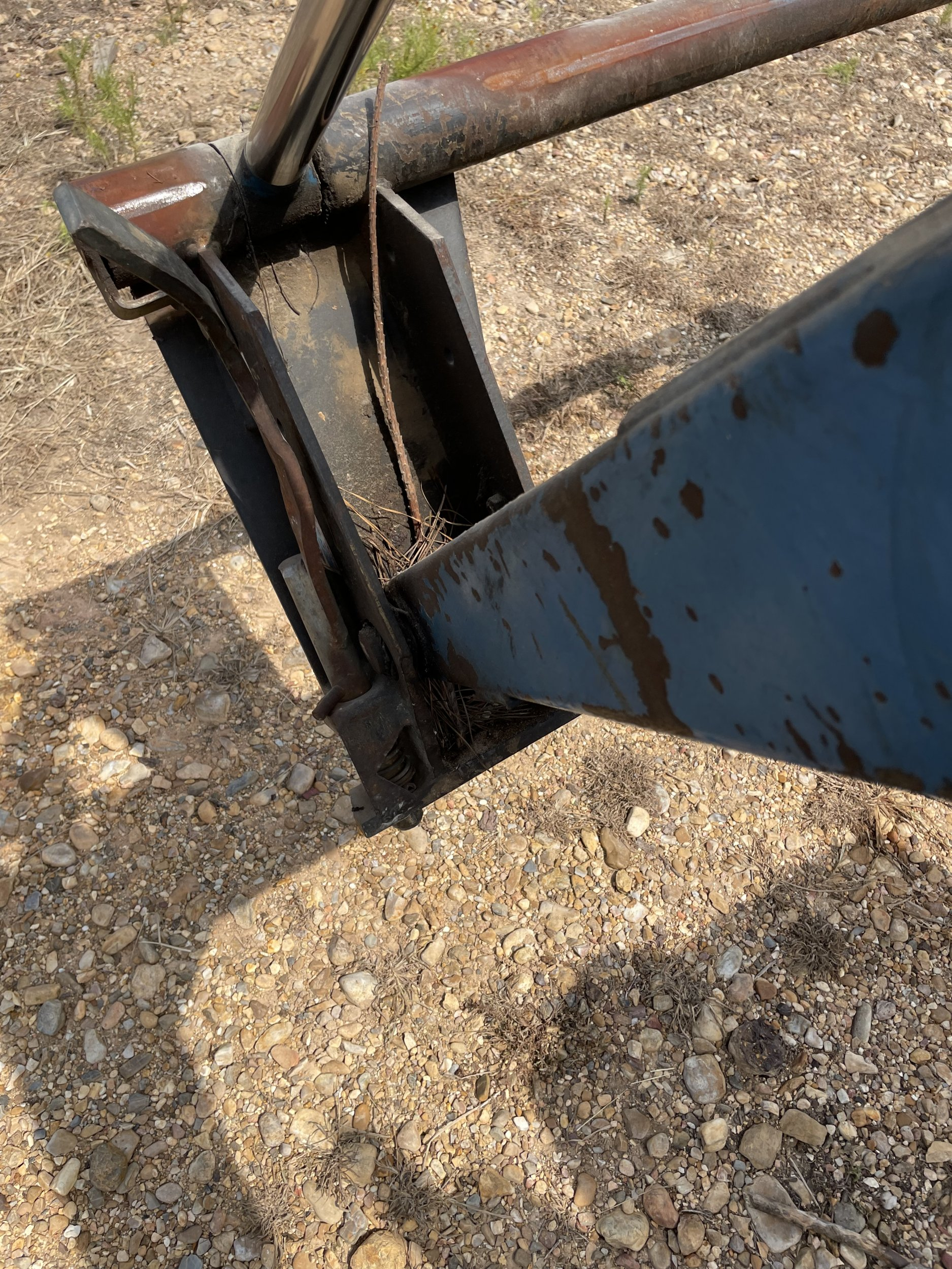

I’m talking about how it hooks to gel. Here is my bucket

OK, you mean skid steer quick attach.
Yours looks like a home made QA.

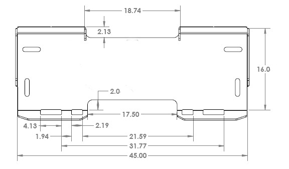

Here is the SSQA dimensions that will be on the grapple:

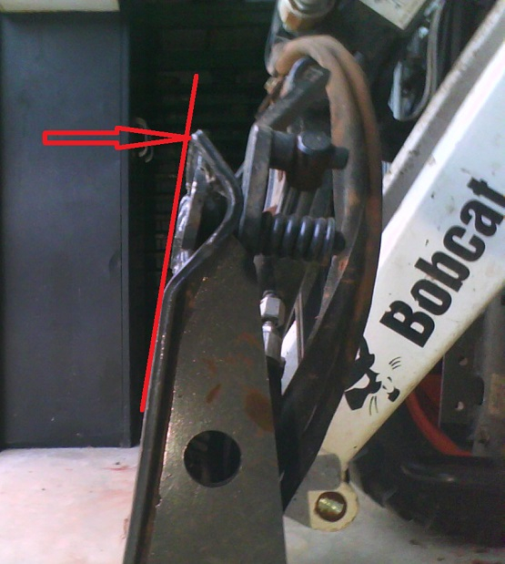

Also yours appears to have a round bar at the top.
This is the side view of the top of the SSQA:

Yes sir I understand now. I thought my old tractor had ssqa. Understand now it doesn’t.
