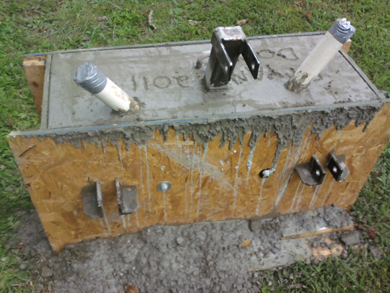

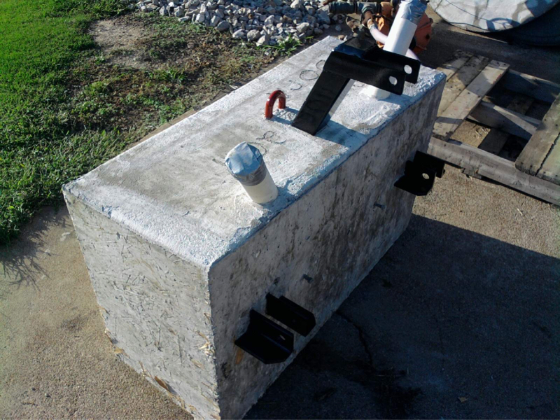

I did a form and framed up a hitch inside with a 2" receiver even. It's been working out great. It's 1300-1400 lbs.
That's very nice. Could you make another one and bring it to Utah? I'd barbecue ya a steak! :licking:
Seriously, I'll be making something very similar this summer.
