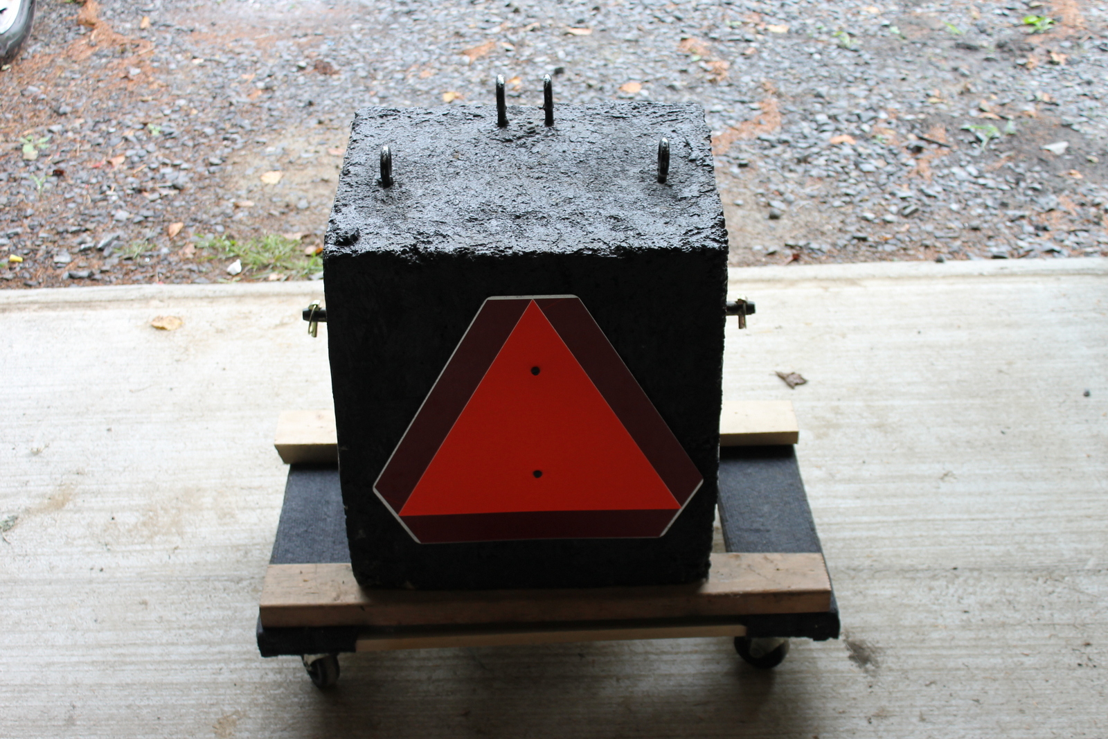

What size form would I need using concrete fill to get around 1200 lbs. Thanks for any info.
   / Any Ideas for a Cheap Compact Rear 3 Pt Counterweight? #43
Mine is
40" Wide
24" Tall
16" Deep
For 8.89 cubic foot at about 1330 plus the steel makes it just shy of 1400
   / Any Ideas for a Cheap Compact Rear 3 Pt Counterweight? #44
Here is mine, made a form out of plywood put a 24" draw bar inside for the 3 point arms to lift, Eye bolts welded to some rebar and filled it with leftover
4000 psi concrete with fiberglass when I was pouring the concrete pad for a now garage. You can just get a few bags of ready mix and do the same.
Front eyebolts are for the toplink, middle eye bolts are centered so I can lift it the the front end loader.
Cured concrete is ~150# per cubic foot. So you would need 8 cubic ft. (which would be a container that holds 60 gallons). A 55 gallon barrel filled to the brim (which is closer to 60 gallons) would be right on 1200#. Or any other shape that equals 8 cu ft.
A 2' x 2' x 2' box = 8 cu ft = 1200#

Not all concrete is 150#/cf. I contacted the Sakrete people to ask them a question and what they told me worked out to 128#/cf, about 15% short of the 150# rule of thumb. Just so ya know.
