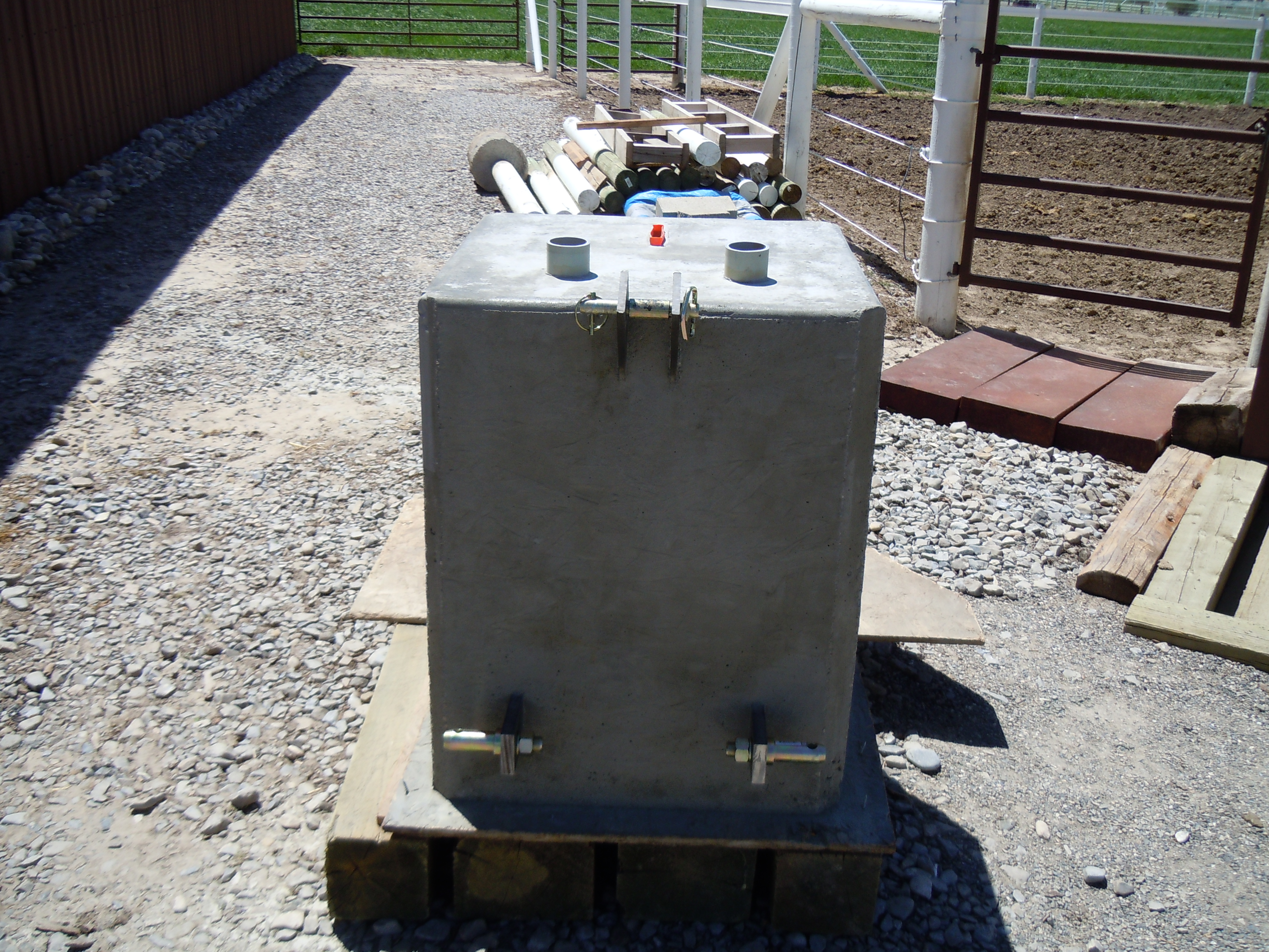

Now getting back on the subject of this forum topic, I too am in need of a substantial rear counter weight when doing heavy work with my FEL and am convinced to build a form and use concrete. And take into consideration some of the new ideas helpful contributors have come up with. ;)
   / Any Ideas for a Cheap Compact Rear 3 Pt Counterweight? #32
That's very nice. Could you make another one and bring it to Utah? I'd barbecue ya a steak! :licking: Seriously, I'll be making something very similar this summer.
might just work something out. :)
   / Any Ideas for a Cheap Compact Rear 3 Pt Counterweight? #33
There are so many different designs people have come up with its amazing, ones with basic handle storage like mine, to ones with storage for tool , saws, chains , ect. I built mine with square corners, some have done rounded or angled as to keep them from chipping off if they get bumped into something. WITHOUT getting into the whole you just need to search B.S. If I'm thinking of doing a project like this, I will usually do a google image search and get all types of ideas on a project ( I too will get on here and ask for ideas also), then I may take several ideas that I like and combine them into one design that fits my needs. Another thing you may consider doing is placing the form on a trailer , heavy enough to hold the weight after it's been filled with concrete, and talk to a local concrete supplier about bringing it to there plant for filling.
