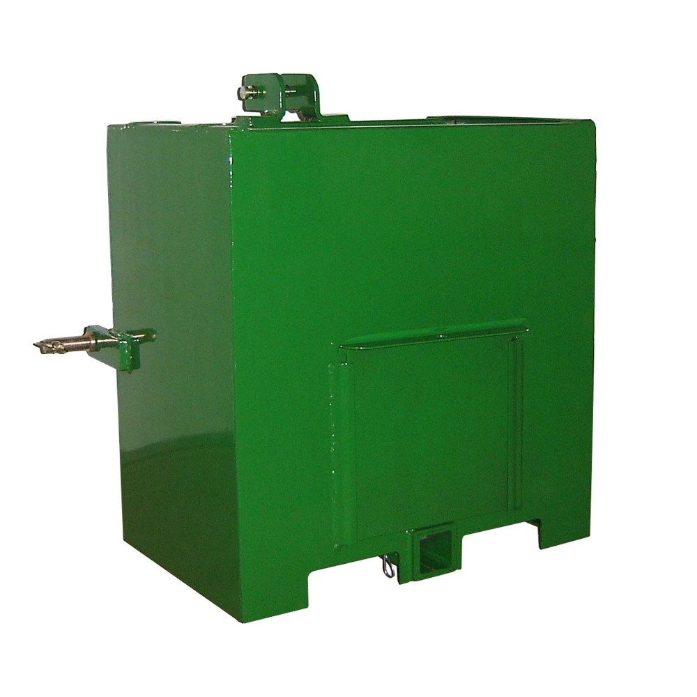

Question: Does anyone have experience with this Titan Ballast Box?
Amazon.com: Ballast Box 3 Point Category 1 Tractor Attachment: Home Improvement
At $255 with free shipping through Amazon, it's hard to justify spending time building one. It seems to be well reviewed but appears to be made of rather thin metal. I suppose it could be filled with concrete if it started to fall apart.
My neighbor just bought one. Ordered on Tuesday at 11am and it was at his door on Wednesday by 5pm with standard shipping. We live in PA though.
The box is very nice and has a number of nice features. Receiver built in. Door to empty. Tubes for shovel/rake/etc. pallet forks fit underneath. Quality and thickness of steel is on par with OEM's.
Suggest ordering direct especially after signing up for their news letter and receiving 5% coupon. Plus it was slightly less on their website.
Bottom line: highly recommend.

Lots of great ideas. Thanks everyone for your input.
Titan seems good value for the dollar, I just bought their 5/16" thick skid steer blank plate. Nice heavy stamping, grit blasted to bare metal for welding and paint, and top edge welds are very well done.
Comparing that to my other 1/4" thick plate, the 5/16 pates seems way thicker , even if is only another 1/16" thick.
$255 is a bargain
It does look nice,.... new.... but ...
I hate rust,... and who is going to store a ballast box inside?
It may be a bit of a nuisance to build one, but I vote for a plywood form with molded edges/corners, and filled with as much concrete as desired.
It will NEVER get rusty!

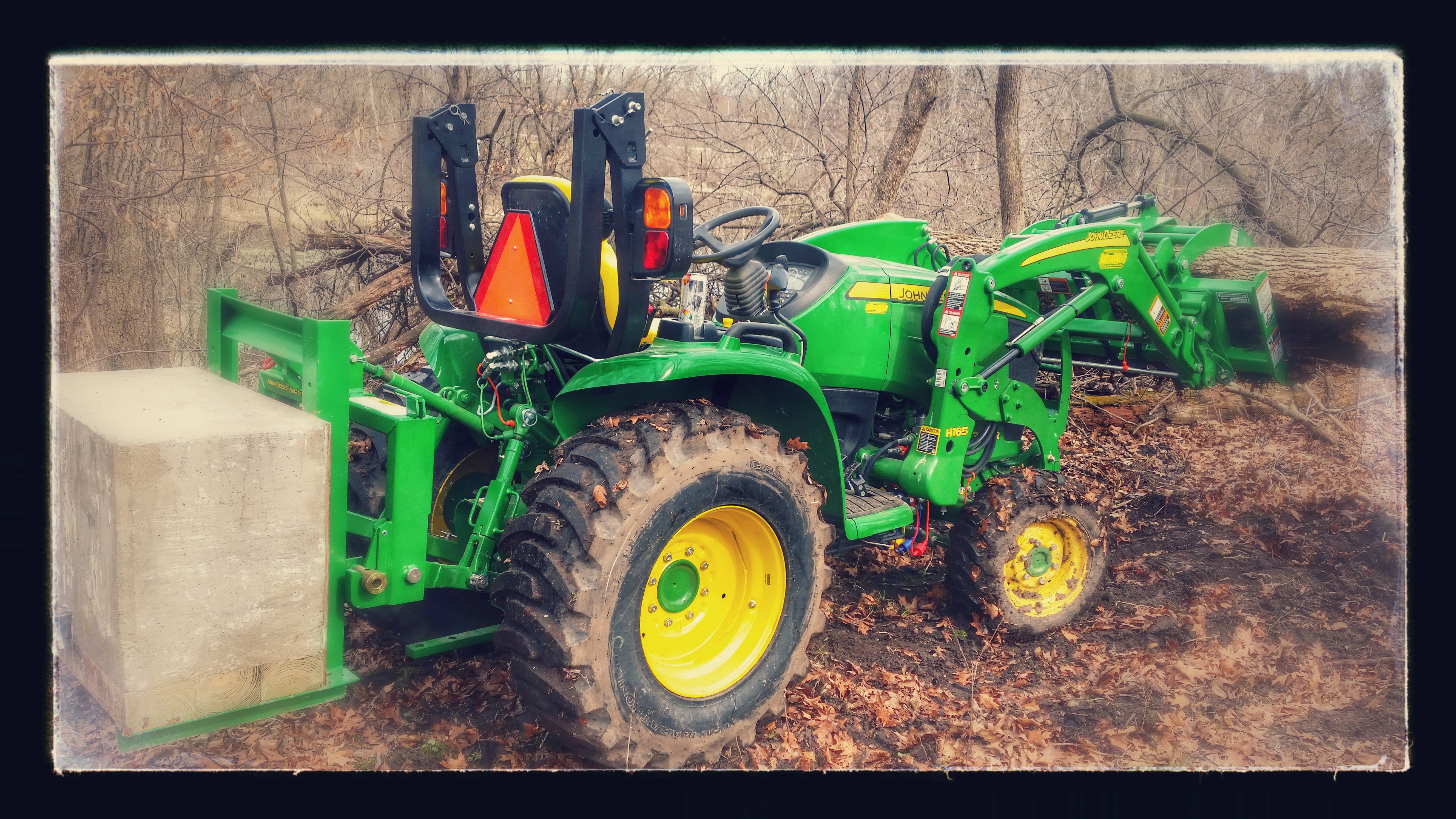

Mine does, About 300 lbs of Concrete, +400 lbs of steel. In need to paint the outside of the concrete to seal it.
