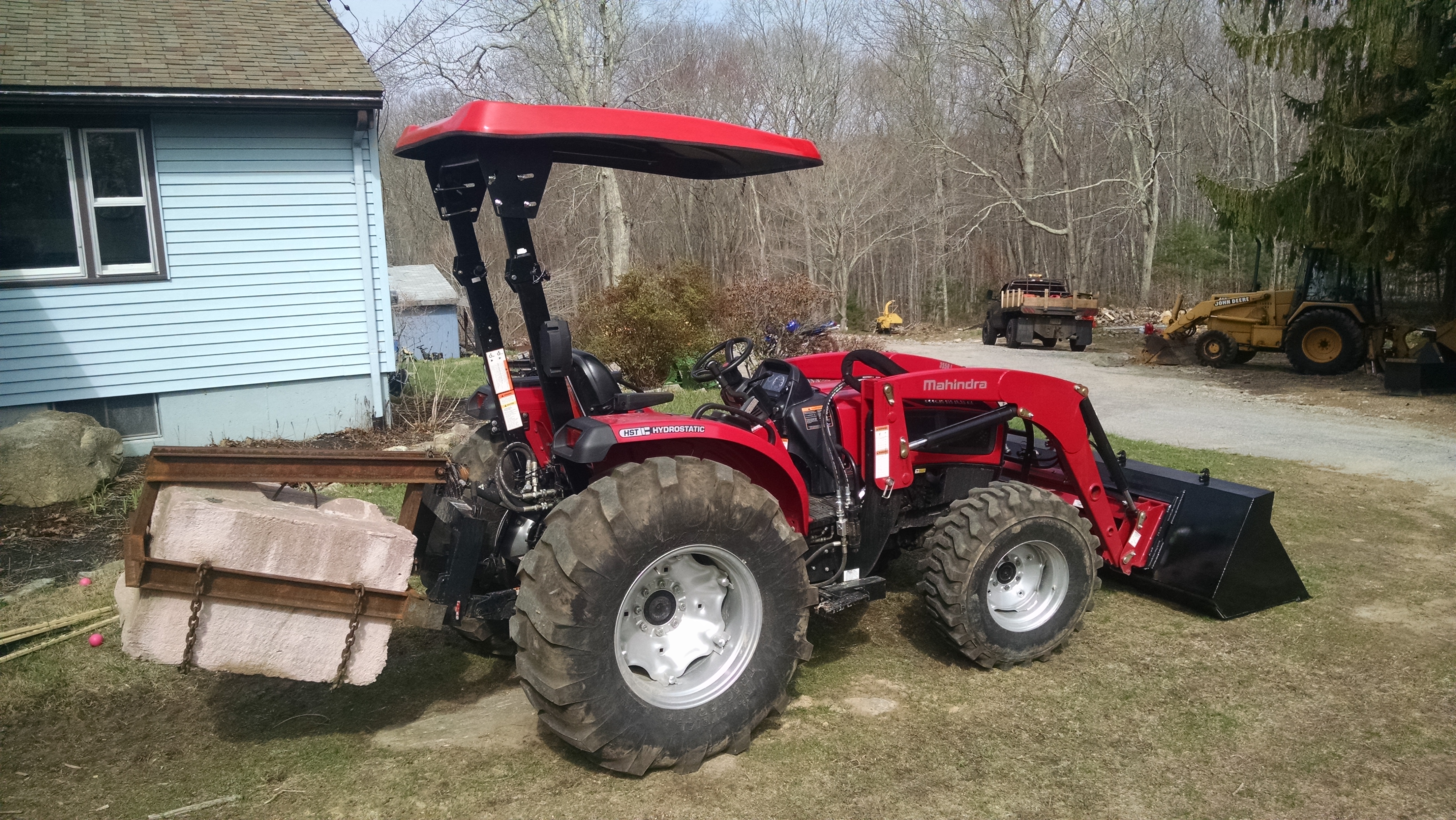

I run a 2000 pound concrete block. These can often be purchased from a local concrete supplier. I think I paid $20 for this one. Building the frame around it is pretty simple. If you wanted to turn it sideways it would not protrude as far, but would apply less force. I do not find it difficult to maneuver as is, so I left it lengthwise for the increased ballast.
Occasionally it's not quite heavy enough.
