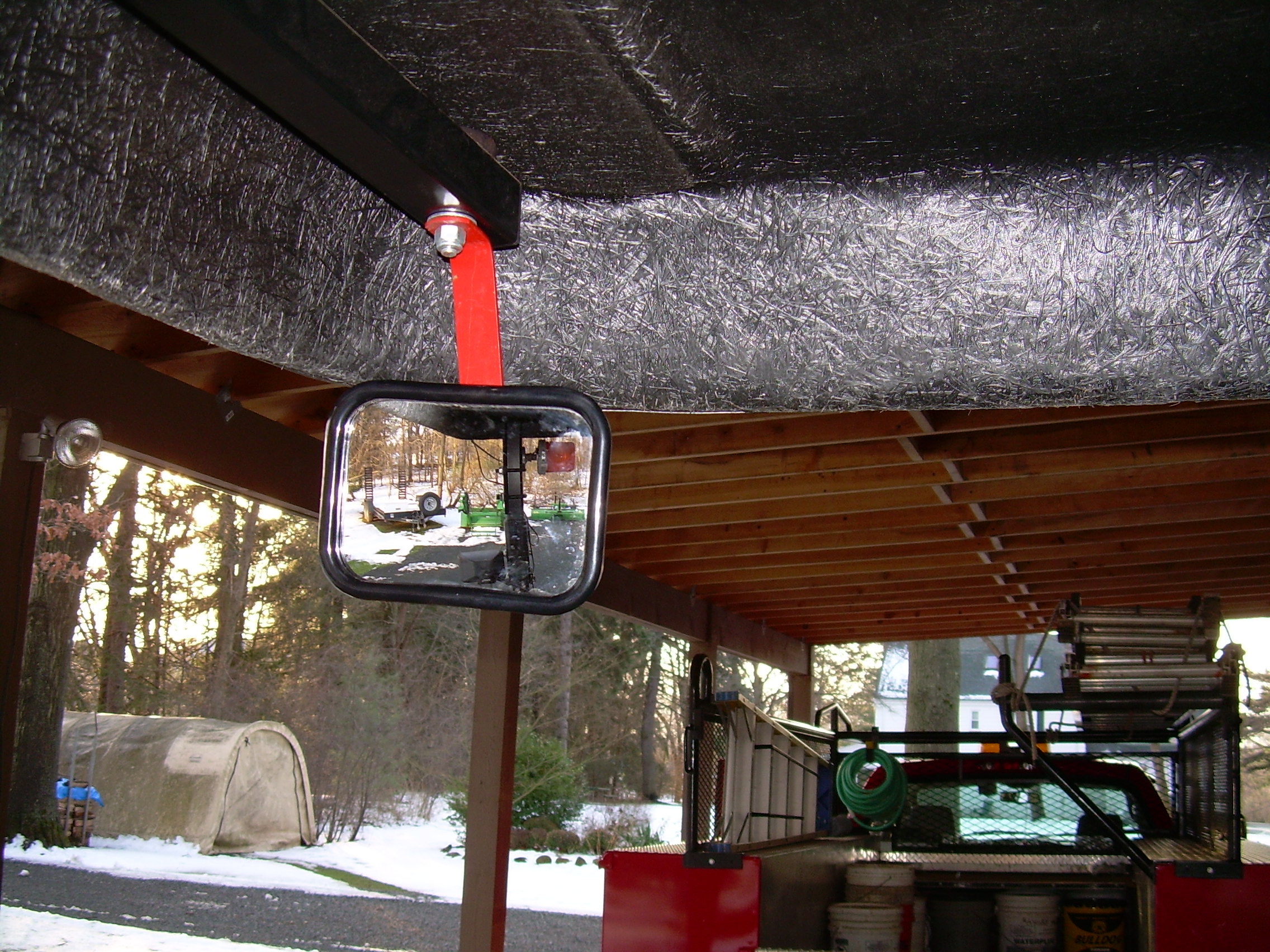

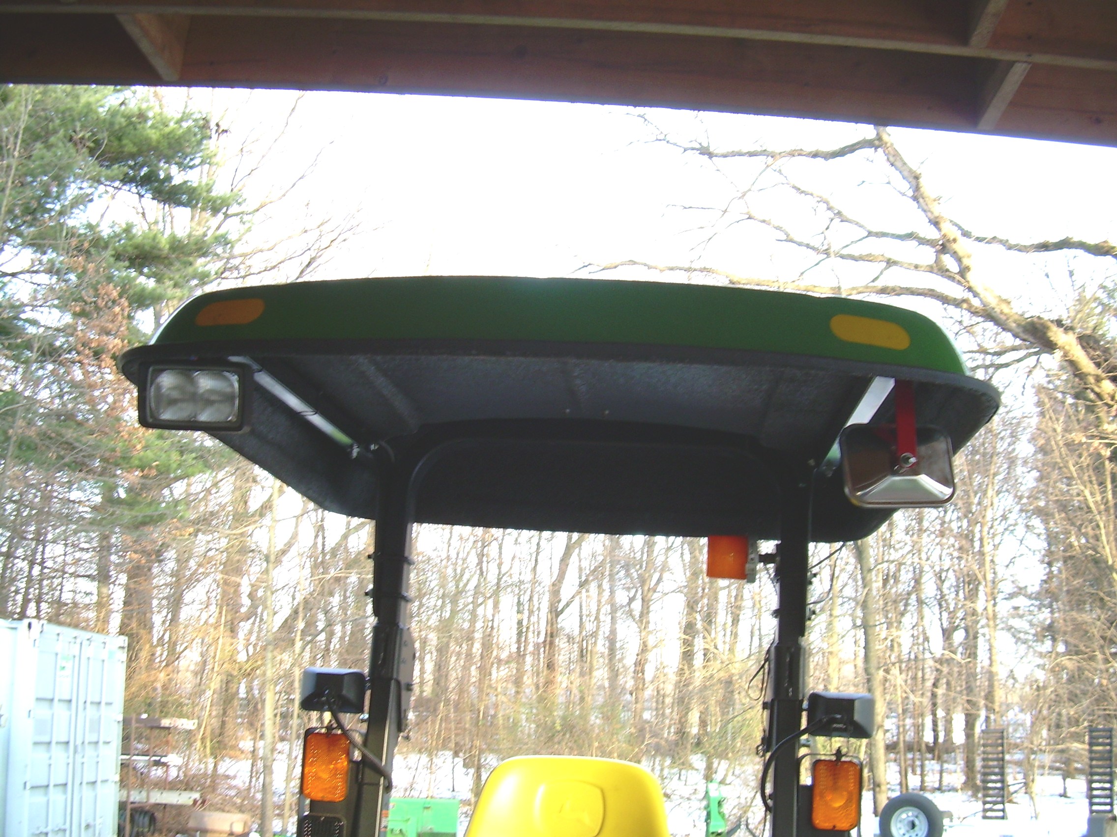

This is the one I put on the canopy, haven't even tried it on the road yet, But I think it's gonna work.

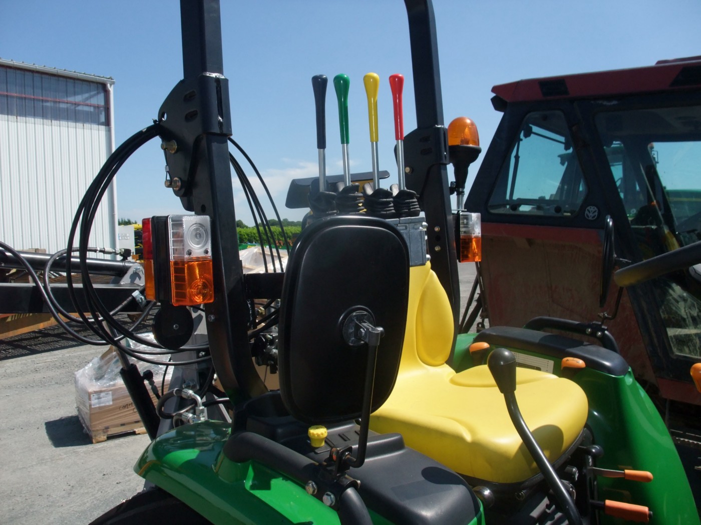

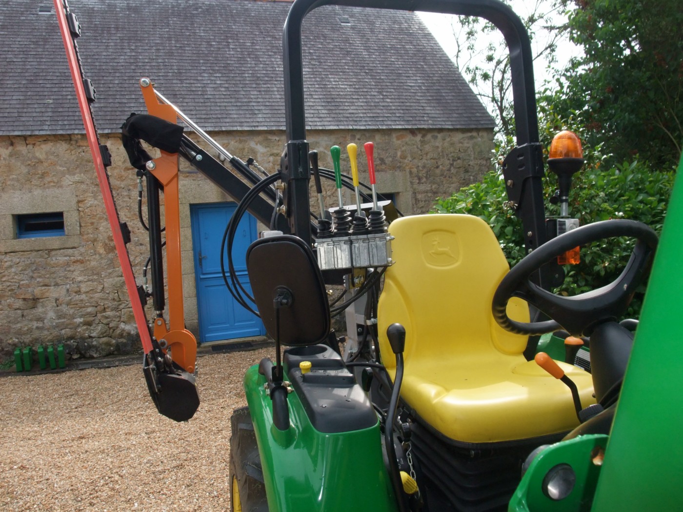

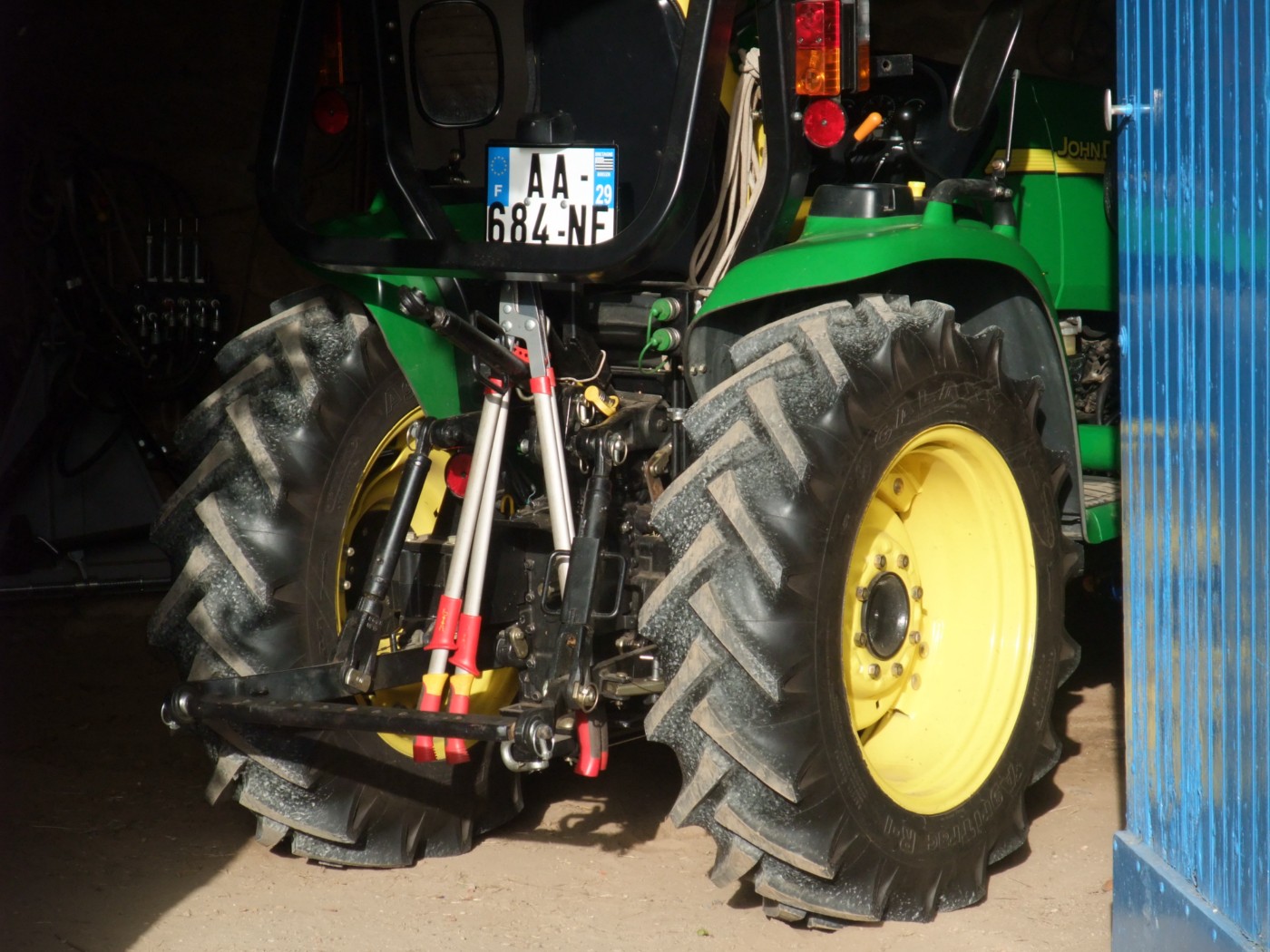

In this country JDs come equipped with 2 mirrors mounted on the fenders. You're not allowed on the road without them. They are not too much in the way and give you a very comfortable view of what's going on behind you. What's more, I have managed not to break them so far. They seem to be very expensive at JD dealers, but I'm sure comparable mirrors could be found elsewhere for a fraction of the price.
Those look like they would be very effective, never thought about clamping to the hand grabs. I do use mine to grab though, guess there's still enough there.
I've seen some pictures of your tractor before is that a 3pt mounted hedge trimmer on a hyd boom? Must be for a special app.
   / Any ideas for mounting a mirror on F. E. L ?? #17
Yes, you are right, it's a 3pt hedge trimmer on a hyd boom and with a hyd engine. Nothing special about it, many people have them here. With about a kilometer of various hedges, some of them very high, and not being as young as I used to be, I insisted on buying it with the tractor. Spend quite a lot of time using it in the summer months. Not as noisy as a mower but requires much more attention.

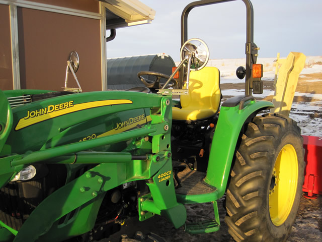

Well, its been a while, I actually made a mirror a while back but finally took a pic the other day. Made out of 2 welding magnets, a shelf bracket from Wal-Mart, and a replacement mirror from Autozone. I had to drill the holes in the bracket a little bit bigger for the magnet bolts. Its been very handy while driving on the highway, and easy to attach and remove.
