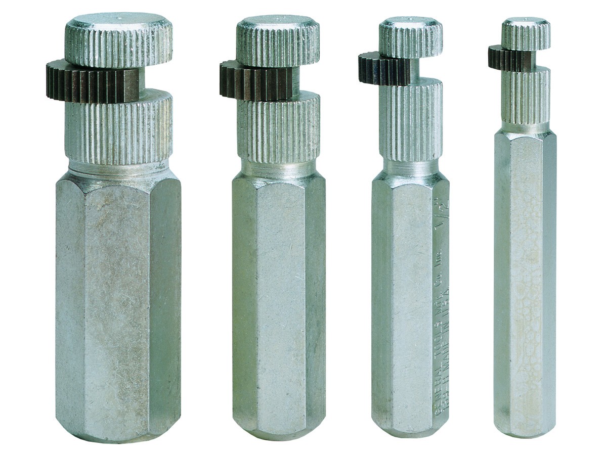

And just in case you don't know about Internal Pipe Wenches:
   / Any lubricant for undoing galvanized pipe? #28
Those are neat. But judging by the way I have gouged and crushed pipes using a pipe extension on a pipe wrench, I would imagine the forces could be extreme. Could those things not get jammed up in the pipe?
