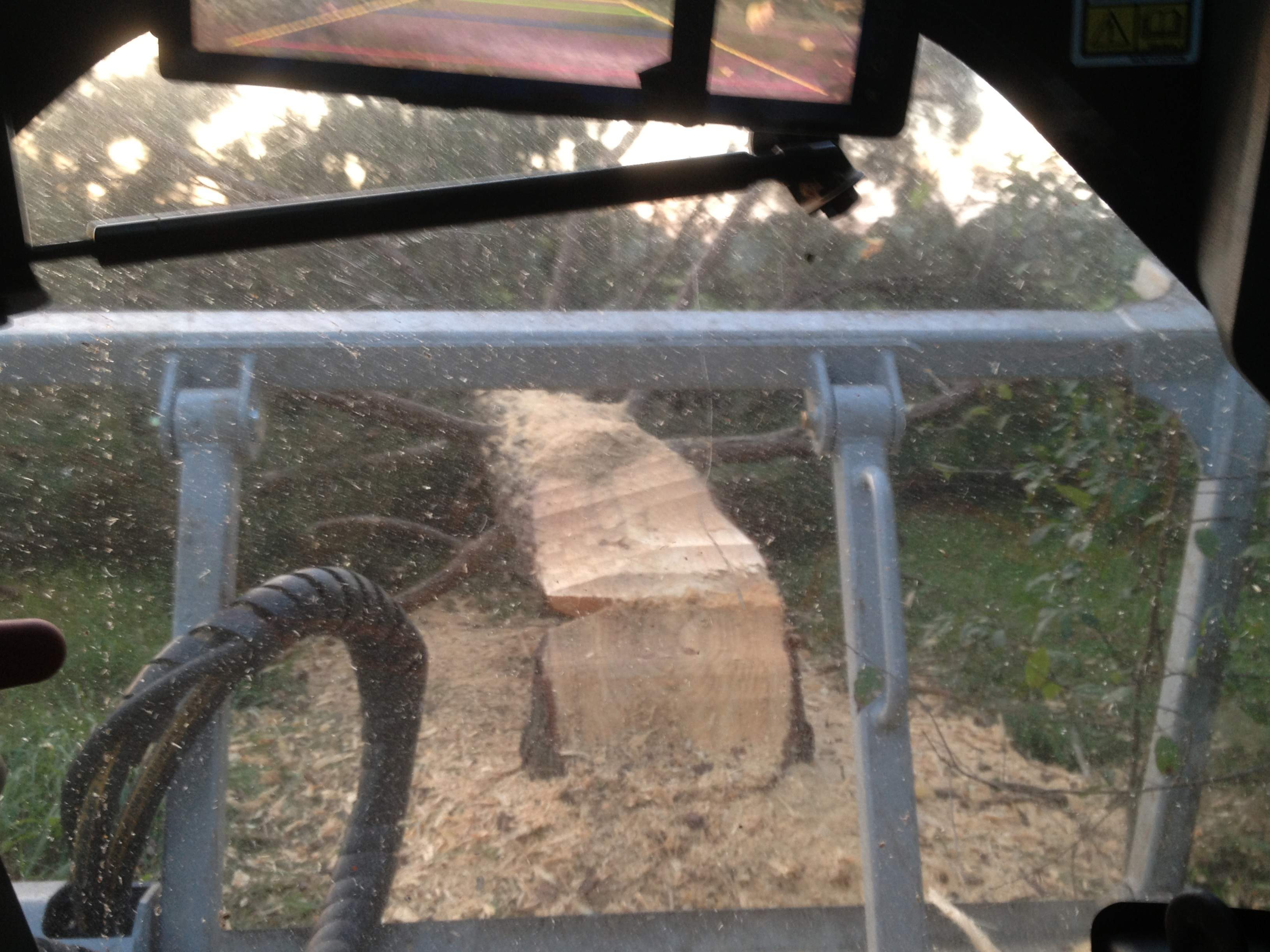

CAT297; What's make & model of the backup camera in your picture?
Man i bought that off of ebay, im not in the machine today looking at a couple jobs today if i remember ill look tomorrow

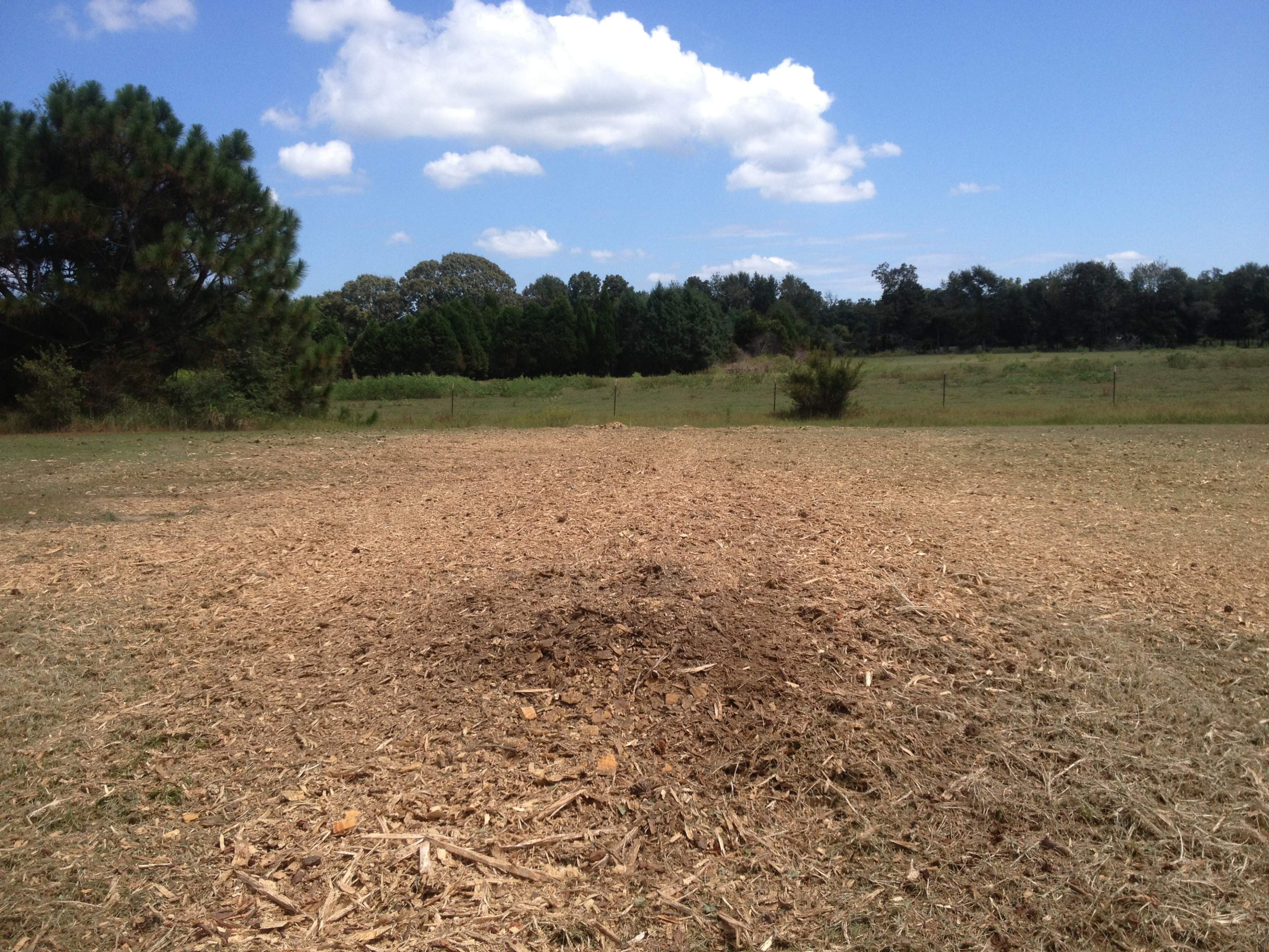

Sorry, oldbarn has a bad experience. Yes, Jon is a fast talker but the service department has been great along with ph support. The only issue so far is that I was not able to keep the bottom shark teeth tite. After calling the service dept. They recommend me switching to bullet teeth or removing this teeth holder completely, since I'm in a rocky terrain (ozark mtn's with flint rock and limestone prevalent) Switching to the bullet teeth did the trick. I have had my ECO for over a month now since my hydro ax 730 burnt to the ground. WOW! This attachment is great! I was concerned from going to a 10ft ax mower to this machine but it almost as fast. And now I can get back to hauling my own equipment. I was leery of the teeth reliablity but the quadco beaver teeth are holding up. I have not broke one tooth yet and have ran into a few hidden boulders. The thumb nail bottom teeth have chipped but they are easily replaced. You do have to touch up the beaver teeth at the end of the day with a grinder. This machine will suck up a 6 inch tree soft or hard in a blink of eye and spit it out in mostly small chips. Eastern cedar will slow down the disc if not careful, Other than missing the soft ride of a large rubber tired machine I'm glad I added this to my lineup instead of getting another hydro ax. I still use my FAE drum mulcher in really rocky areas but the quality of work just not the same.
   / Any one run an AFE SS Eco #28
From the videos, the ECO chips/shreds look a lot longer and rougher than the finished product of an FAE. Are you running your FAE with the door closed to get your finished product or does the ECO produce that good of a chip?
