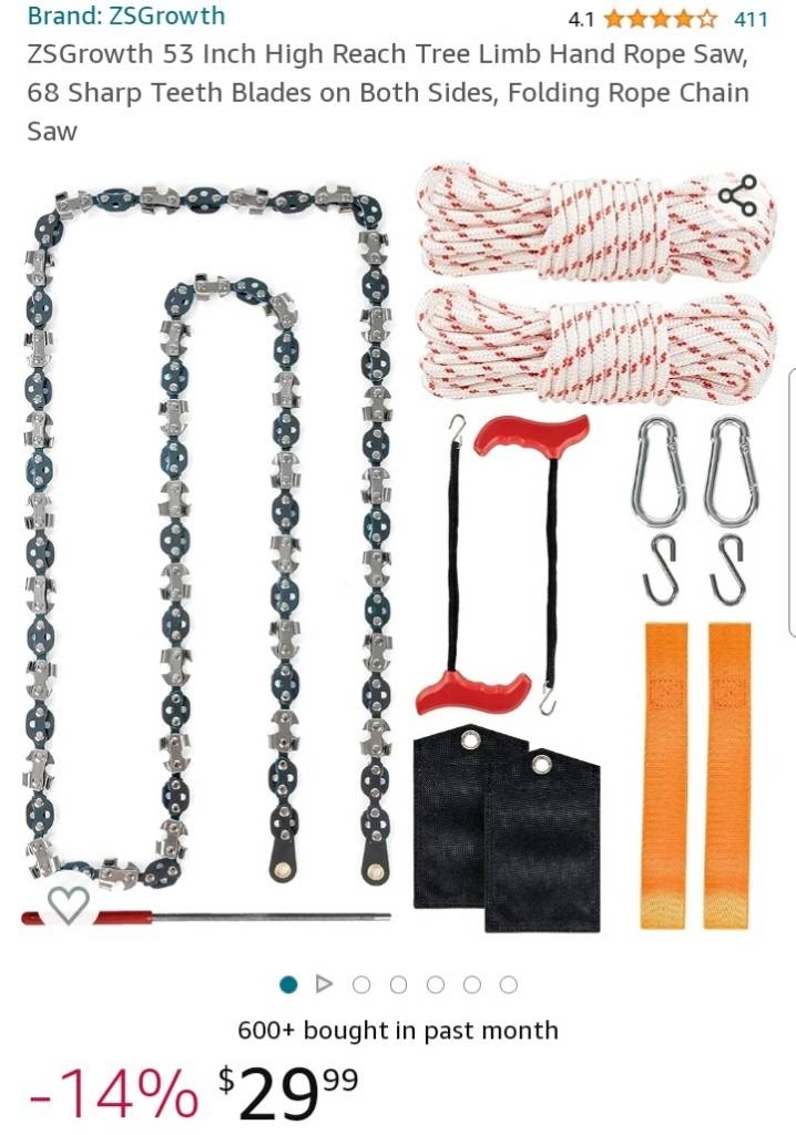

If you like exercise these rope saws are great. Use heavy leather gloves and throw the sandbag high up where it's 14"-16" diameter. You stand 20+ feet away so it's safe. The only thing I have to be careful with is you don't want it to pinch...
The less upper part you cut the safer it is to cut lower part.
In fact looking at your picture you probably would be able to rope cut where it's split, it's probably only half diameter.
In fact looking at your picture you probably would be able to rope cut where it's split, it's probably only half diameter. View attachment 816073
Neat Idea... that will give ya work LOL.
