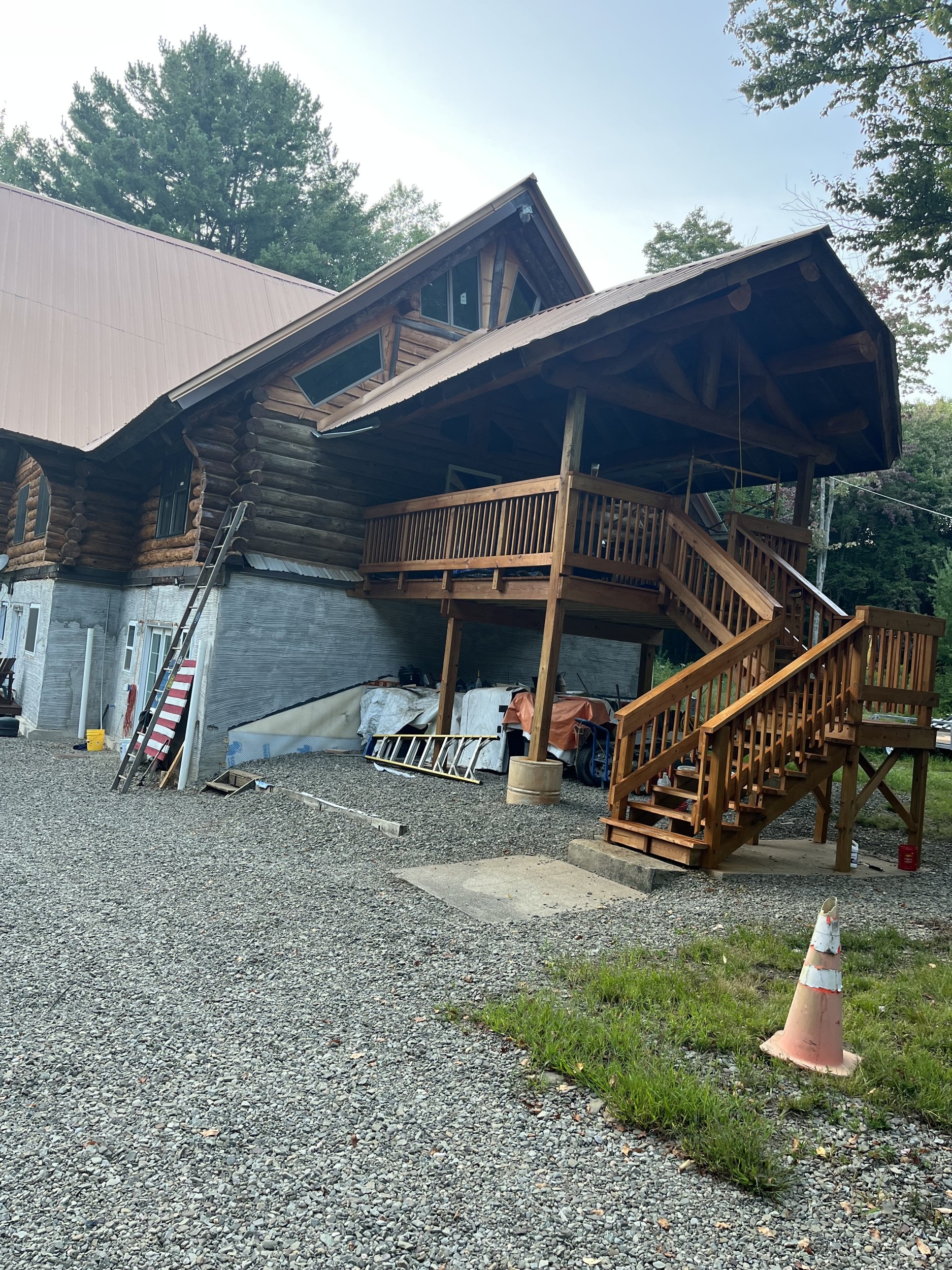

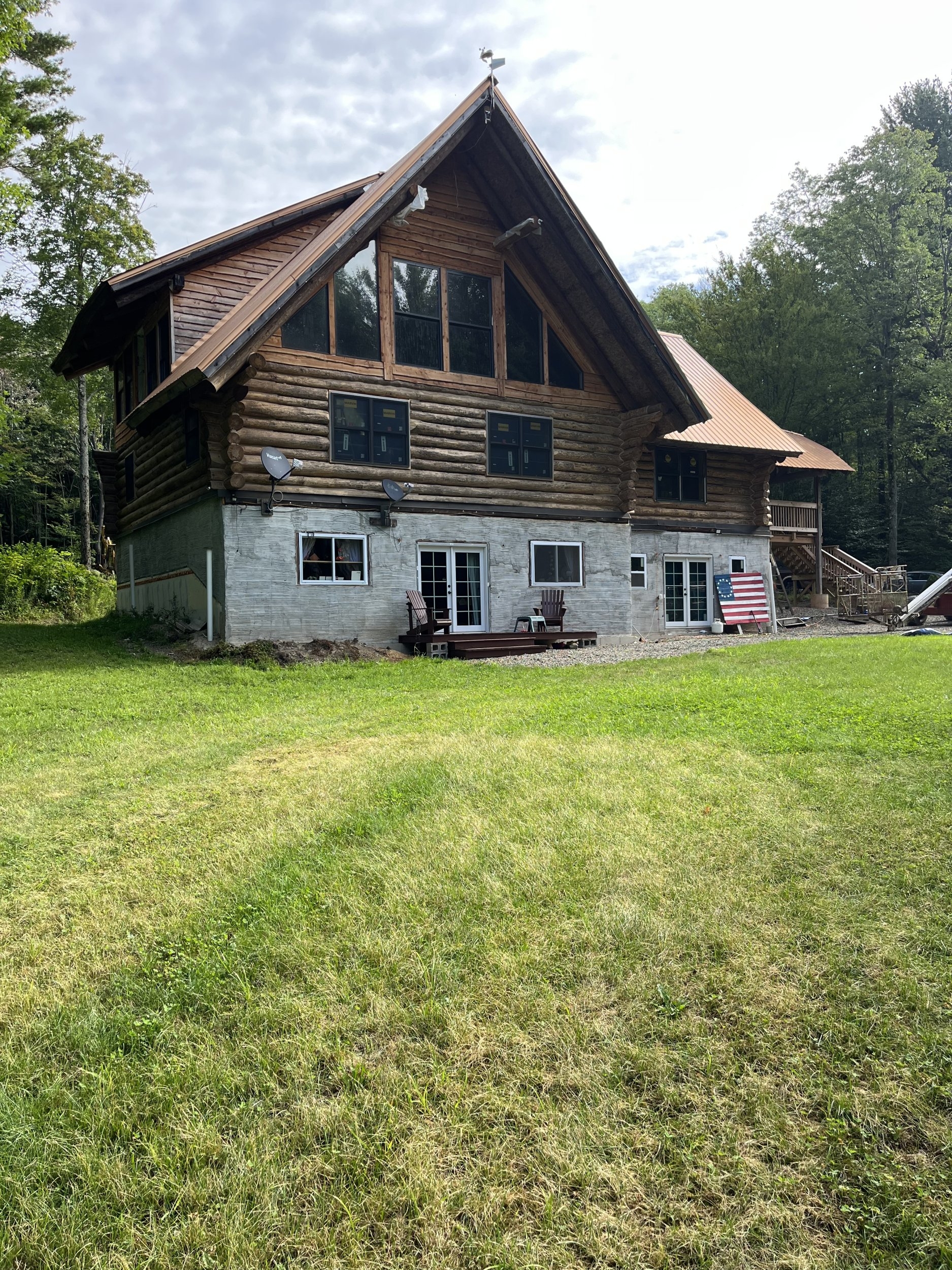

About 10 thousand dollars plus to install the metal roof on the garage, there is no doubt in my mind that I can do the work myself but I am scared to get up there because of the 8.12 pitch.
I’ve tried, can get my foot off the ladder but even with the safety rope I can’t seem to get the nerve.
It’s about 19 ft to the peak and 12 ft walls.
I know it’s a 4 day job for my inexperienced hands.
The home will not be an issue, I’ve had plenty of experience climbing roofs and have replaced many of them but all asphalt shingle or wood shingle.
I’m determined to do it as cheap as possible ( I’m not cutting corners on materials) because we’re paying out of pocket for everything and have only so much set aside and the savings of doing it myself will pay for a trade that I won’t touch.
Any suggestions?
I did my 9:12 asphalt roof when I was 38 y/o. At 60 y/o, I won't consider it without safety harness and ropes over the peak anchored into the opposite peak.
Metal at 8:12 is much more hazardous than shingles, I used 1x3 set 30"o.c. between the shingles and new metal. It provides a safer step system. Also buy special metal roofing shoes that stick better to metal. Make sure metal is dry and clean or you'll slip at 8:12.
