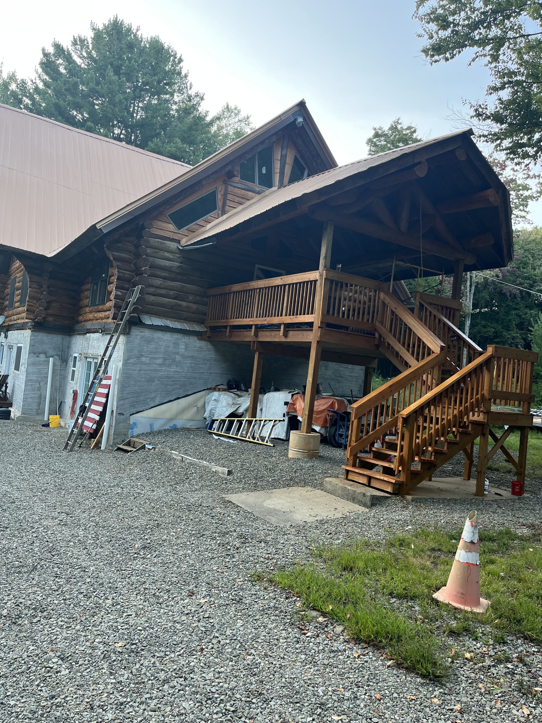

Rent a boom lift and use vise grips to clamp on the top edge of the panel . Lift and lay the sheets down onto purlins which can be used as a ladder to screw the sheets down. And by all means get some help ,2 helpers plus your self . I put on my own metal roof this way , 12/12 pitch , took 4 days to cover 5500 sq ft . All panels were cut to length, only cutting was for the valleys.

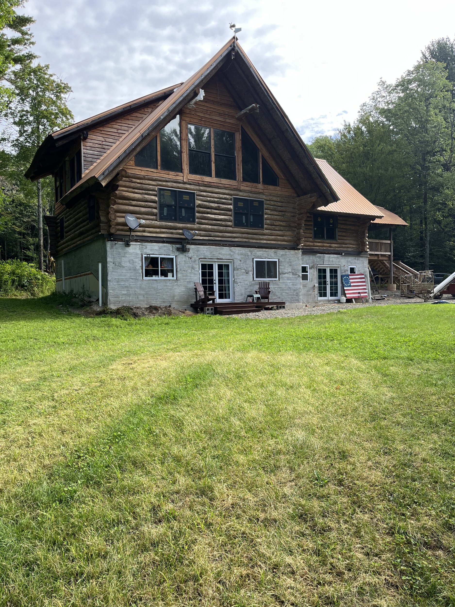

About 10 thousand dollars plus to install the metal roof on the garage, there is no doubt in my mind that I can do the work myself but I am scared to get up there because of the 8.12 pitch.
I’ve tried, can get my foot off the ladder but even with the safety rope I can’t seem to get the nerve.
It’s about 19 ft to the peak and 12 ft walls.
I know it’s a 4 day job for my inexperienced hands.
The home will not be an issue, I’ve had plenty of experience climbing roofs and have replaced many of them but all asphalt shingle or wood shingle.
I’m determined to do it as cheap as possible ( I’m not cutting corners on materials) because we’re paying out of pocket for everything and have only so much set aside and the savings of doing it myself will pay for a trade that I won’t touch.
Any suggestions?

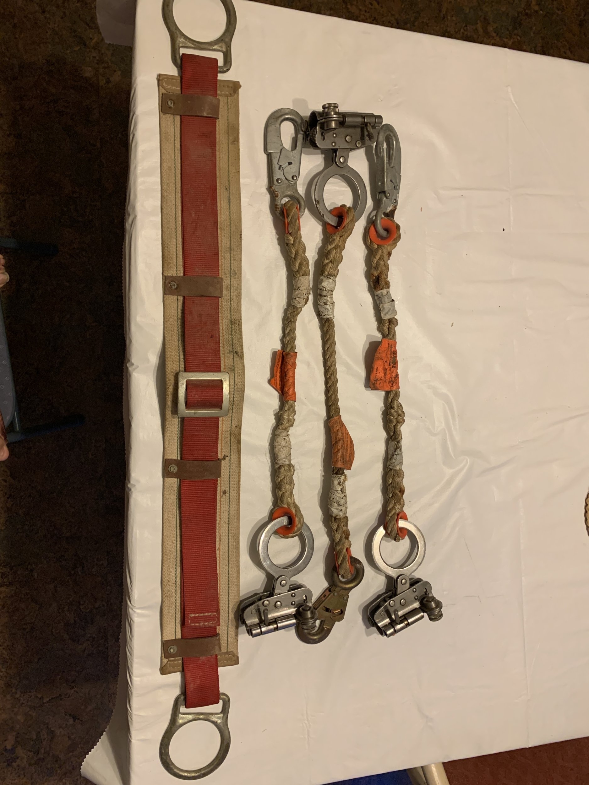

Thanks for all the replies, I have not done it yet but I have climbed up there numerous times and unsteadily using a rope to pull on attached to tractor on other side of building.
The underlayment on there is good for many months.
For unrelated reasons I’ve decided to install my windows and doors first.
I hope to have them installed maybe by the end of the week?
I’m going to do my interior walls after that so that may be another week or two.
I’ve got a model home nearby that I can use for the time being to answer many of the questions I’d have concerning what local codes require and I don’t want to lose that gift.
I bought this equipment for a great price on e bay.
I trust this gear, the other stuff is getting returned.
I’ve definitely got the roof pretty much figured out thanks to suggestions here.
I’ll post pictures when I get to that point.
Doesn't seem to be any shock absorbion in that picture. The roof protection fall kits selling for around $100 usually come with a harness instead of a belt, too.
