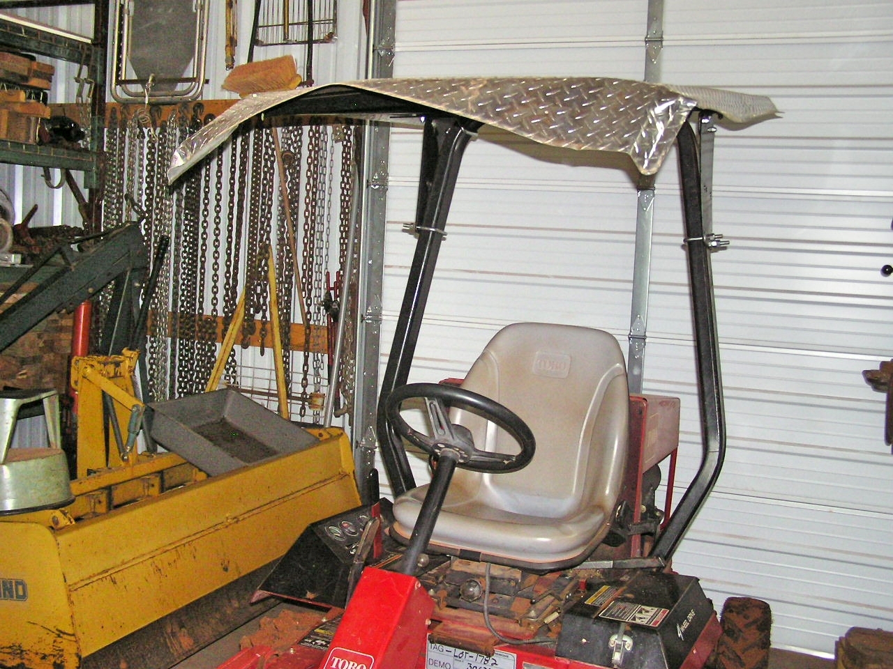

any toro groundsmaster fans on here?

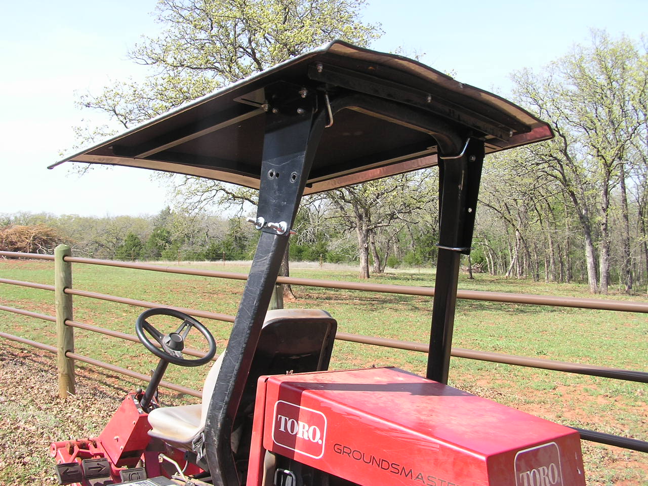

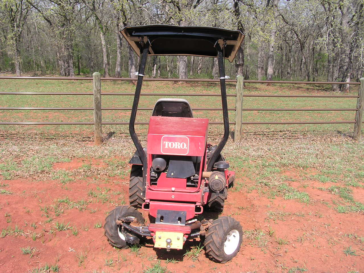

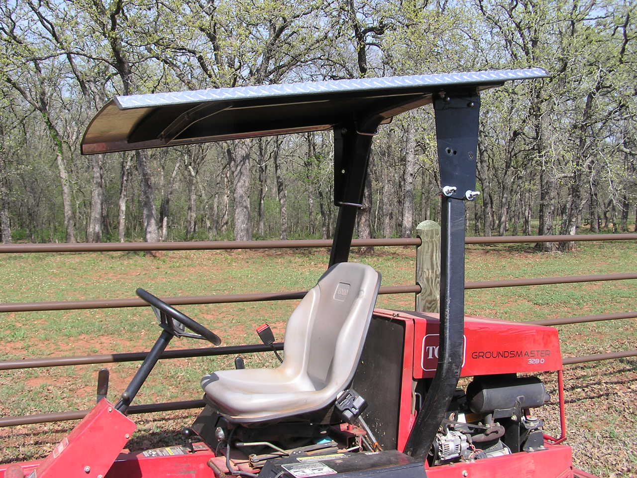

Update. It got customized by some low tree limbs:
But now it does better keeping the late afternoon sun out of my eyes. :D
