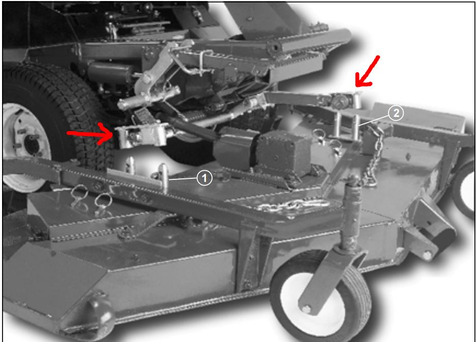

Here is the top half from the operators manual:https://www.toro.com/getpub/15753
