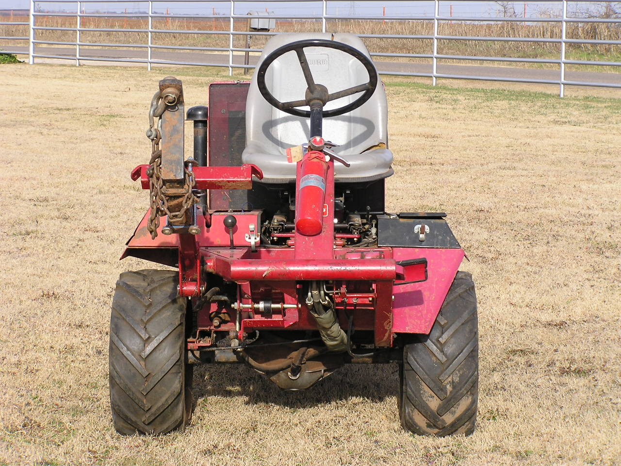

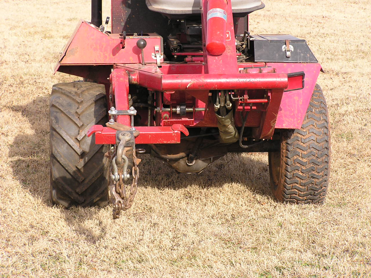

Has anybody installed wider wheels and tires on them?
Yep, I put wider wheels and tires on the 322D before I put the loader on. they came off of an old Craftsman garden tractor:

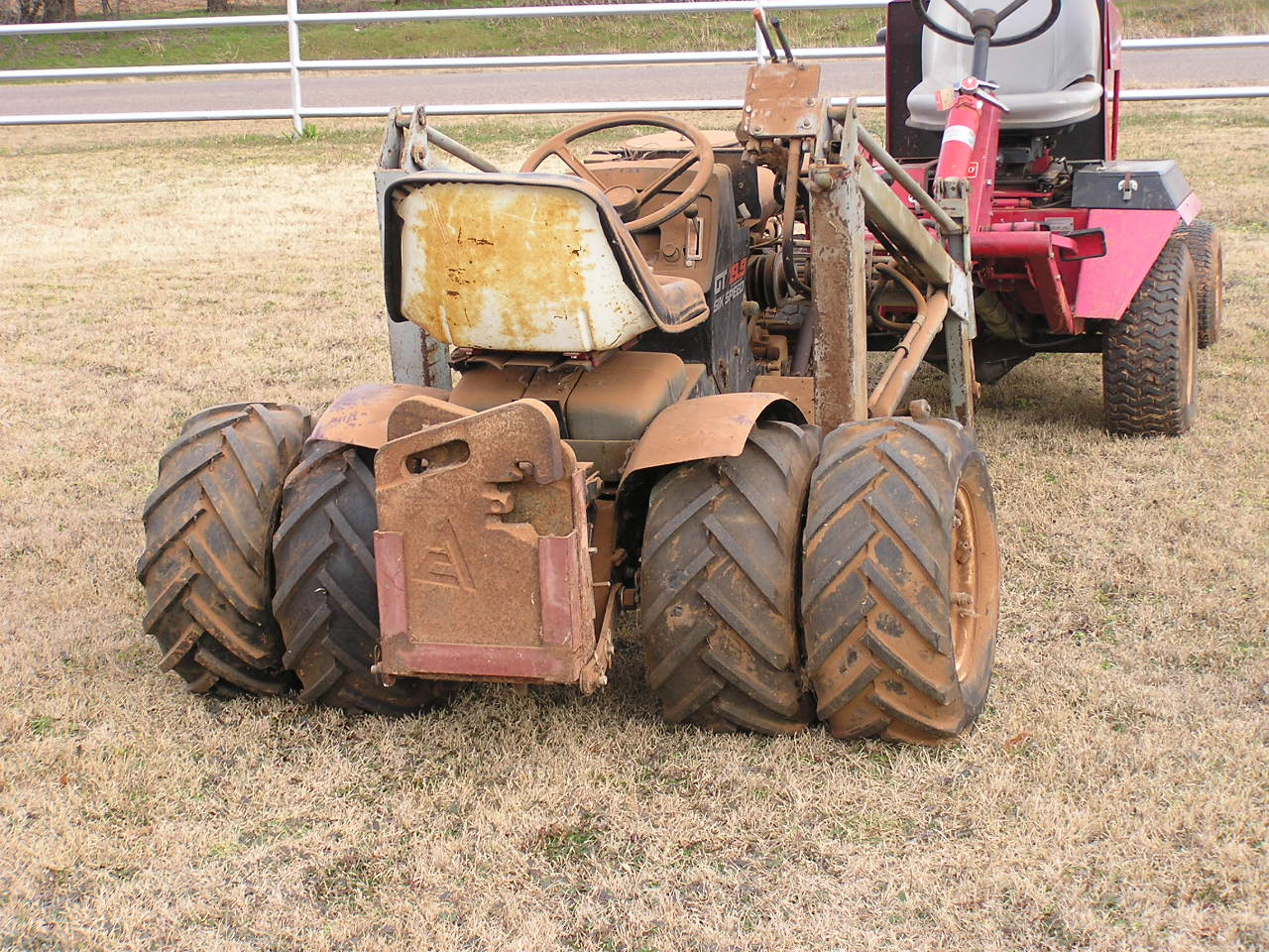

You could also try duals when using a snow blower:
   / any toro groundsmaster fans on here? #985
View attachment 737970View attachment 737971
You could also try duals:

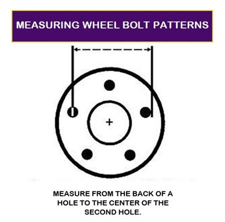

Do you know the lug pattern for front wheels on a Toro Groundsmaster 223D or 325D?
Is it 5 on 4.5?
What about offset? Is it a maximum 5" offset?
I have 23 x 8.50 x 12
The John Deere was 26 x 12 x 12
Is there a wheel tire combo that would be about the same height or shorter than stock but as wide or wider than the 26 x 12 x 12?
Is it 5 on 4.5?
For 5 lug measure this way to get the bolt circle diameter:

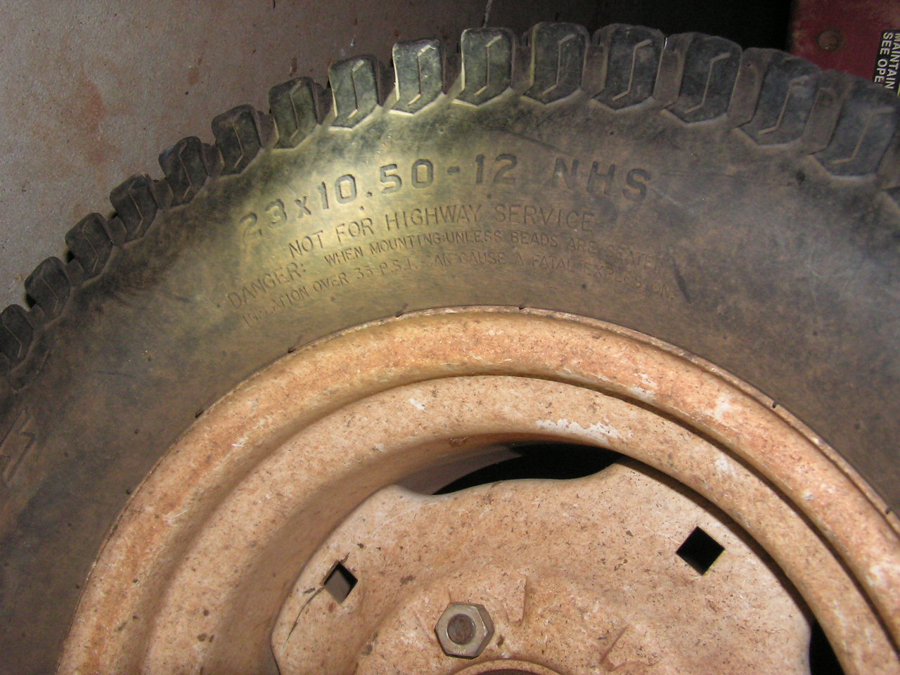

Probably. Look at trencher tires and zero turn tires.
23x10.50x12 is the widest that I used:

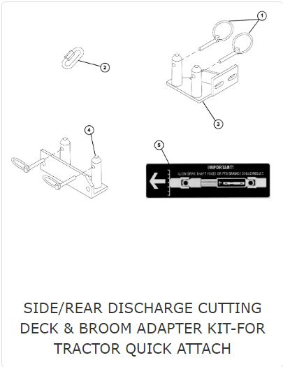

I have a quick coupler here haven't checked the spline count yet.
I am wondering if I can cut the groove in the splined shaft without removing it.

The quick coupler that I remember was on the lift arms, so you didn't use a wrench when swapping attachments.
   / any toro groundsmaster fans on here? #989
I would like to know more about the quick coupler on the lift arms.
The quick coupler I am referring to is for the deck drive shaft.
We seem to take our decks off more than others for service, cleaning and undercoating.
I find it to be a pia to line up the drive shaft without help while dragging the deck back at the same time.
105 0615 1" shaft 15 spline
Quick coupler for Toro deck
