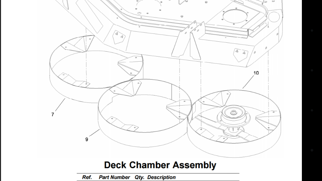

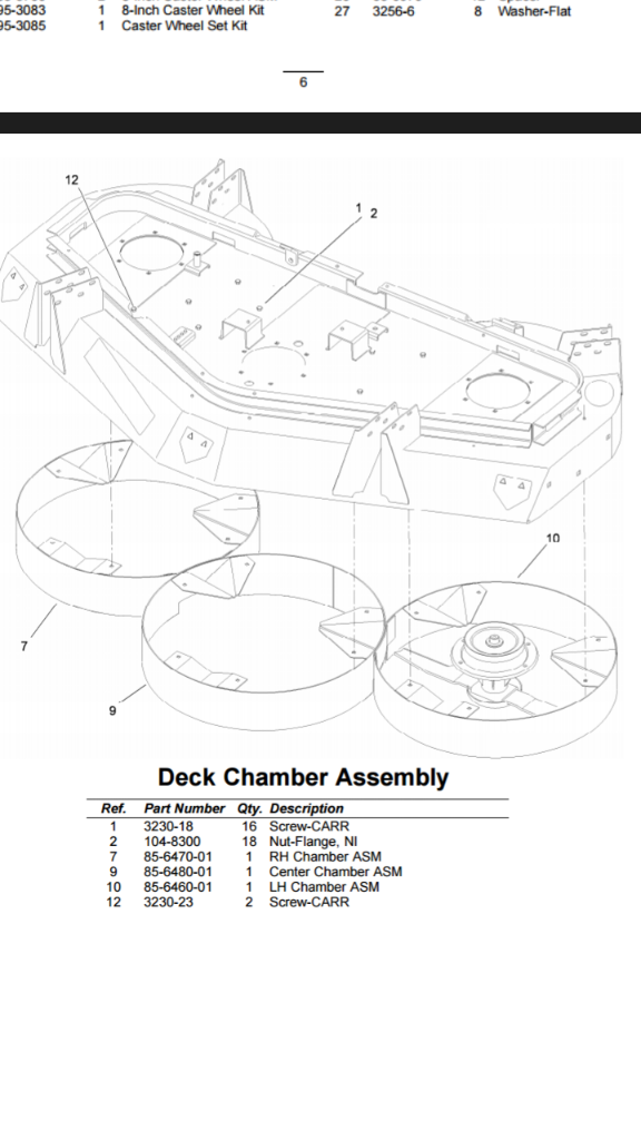

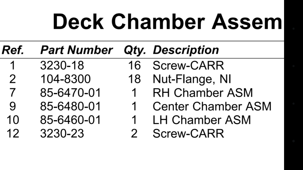

Here are some screenshots from the 72" Guardian Recycler manual, in reference to my question about sourcing deck chambers:
Screenshot_2017-03-14-21-46-02.pngScreenshot_2017-03-14-21-45-37.pngScreenshot_2017-03-14-21-44-28.png

   / any toro groundsmaster fans on here? #184
Xfaxman
Call your local Toro Commercial Dealer. I just checked, 85-6480-01 is a good number and available.

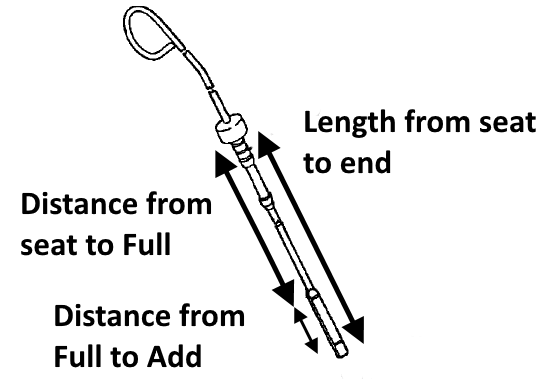

I ran over a long brush stick that came up and pushed out the dipstick, so I need a favor from somebody with a 328D. Need the 3 measurements from where the rubber seats on the tubing, as shown below.
I have a dipstick from a 325D parts machine that I can shorten and use.
