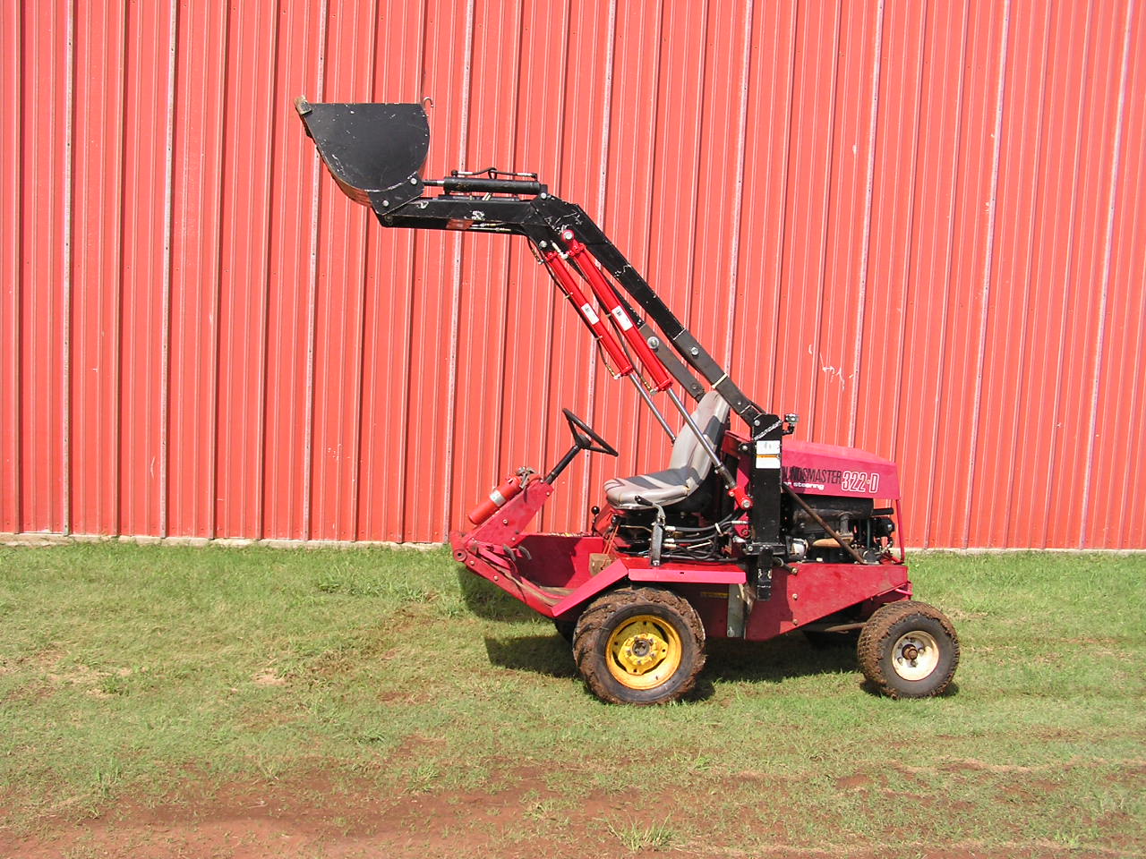

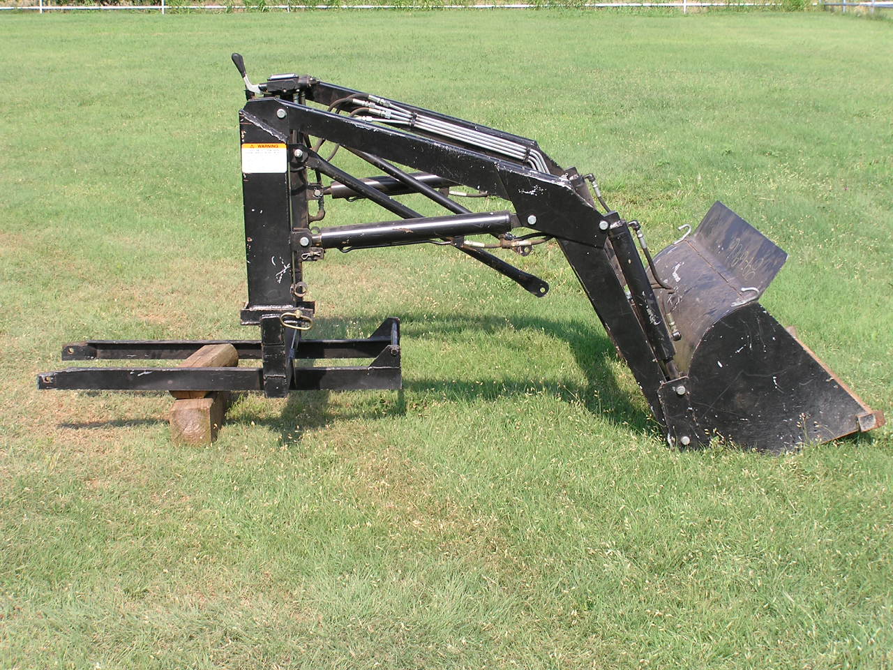

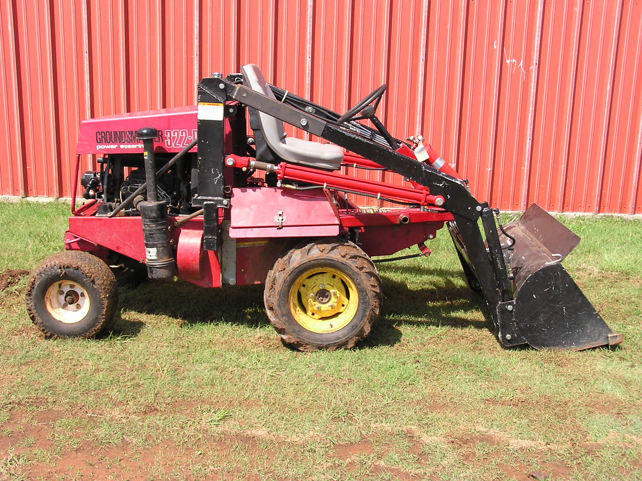

Since it s bigger and 4WD, your 455D would be a good machine to add a loader to, like I did with a 322D:

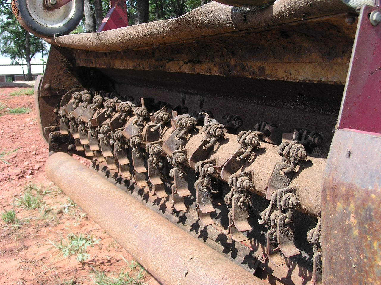

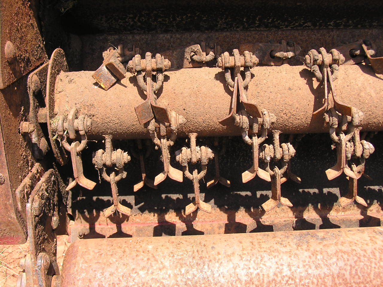

Yep, good deal. They are well built heavy duty mowers. The rotor can be removed and turned around, to use the unworn cutting edge, instead of flipping each pair of blades.

I plan on ordering a a few different styles of blades.
Iowa Farm Equipment has verticut straight blades to mount between the Y knives. I have a lot of thatch, so that would be greatly useful.
They also have both stamped steel and cast broadknives. The stamped steel is great for a better finish cut. The cast ones are heavy, so efficiency isn't their strong point... but they're tough as you can get, especially in heavy undergrowth with 1"+ saplings/etc.
Have you mowed over/around any unseen rock outcroppings with your flail?
I was curious as to how the Y knives hold up to that, as nearly every job I have for the flail will be faced with that issue here in the mountains.
   / any toro groundsmaster fans on here? #180
I have occasionally hit some sand rock with it, didn't seem to faze it. :thumbsup:
