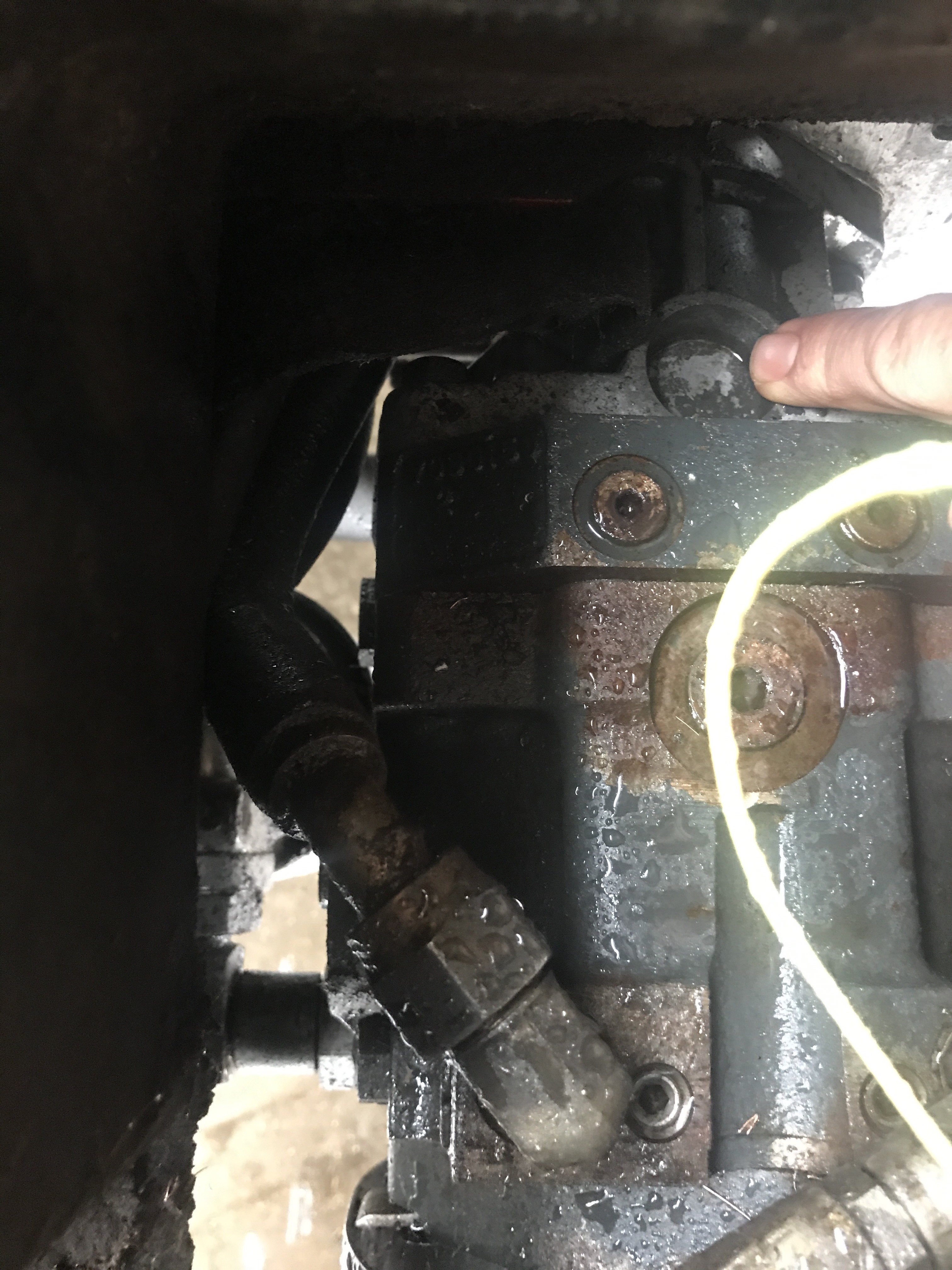

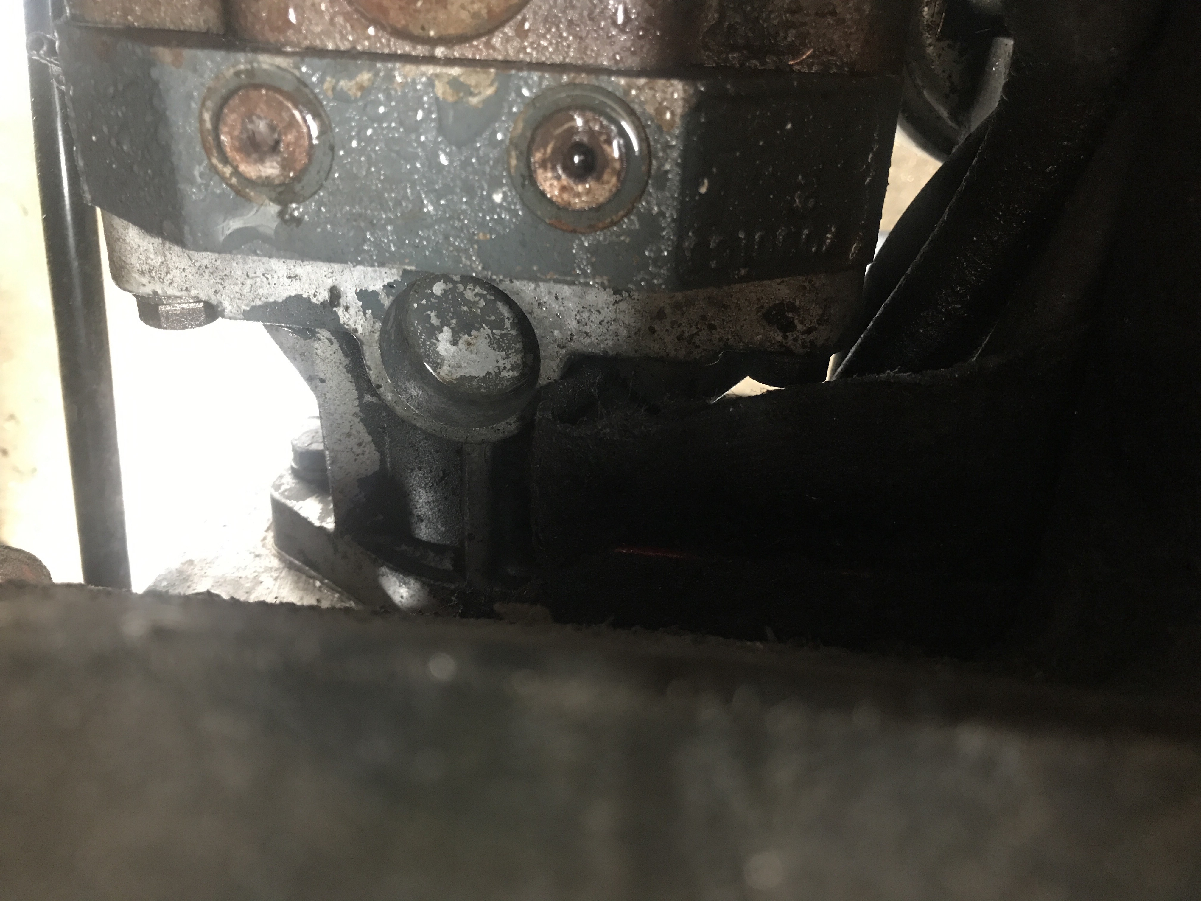

Hello... I'm new to this site but I have been reading through this thread and I'm hoping there may be some folks out there that can help. We bought a Toro Groundsmaster 325d last year to mow some of the lawns at our farm. It has been a great machine. That 72' deck was a real time saver. Long story short the differential (it is the two wheel drive model) blew up (cracked housing, gearing destroyed). I was able to find a replacement on Craigslist that should work. We have discovered that the piece just in front of the hydraulic pump (looks like it is called {67-9080} HOUSING-MOTOR) is cracked and leaking oil pretty badly. I'm hoping some of you guys can point me in the right direction as to where to search for parts and maybe able to tell me what models might have interchangeable parts for my machine as well as what this part is for sure... This is my first Groundsmaster so I am still getting to know it and so far I have loved it. I have been running Toro 8-32's for years and I love them...the first picture is pointing to the part in question...others are obvious...any help is appreciated as well as information about my machine...i think there is more info in the serial number than a bunch of numbers right?
View attachment 511762 View attachment 511763 View attachment 511764
Most used transmissions sell with the part attched.
   / any toro groundsmaster fans on here? #260
Wow, sounds like the 325d was kinda crappy design....i still like it but wish I had known more about it before I paid $2000
The 4wd on these machines was only designed to keep the machine from scuffing finish grade turf. The reason they designed it that way on the 325, was for the sake of efficiency... so the 4wd didn't use power required for the blades until needed, while also allowing for automatic operation.
You may want to put your machine on jackstands and ensure the 4wd isn't seized and engaged full time.
