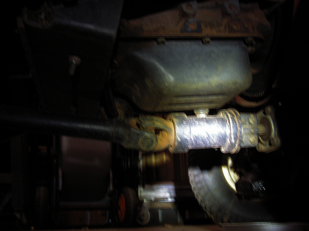

If pump is working properly you should be able to lift the deck at low rpms. When mine was weak it wouldn't lift it regardless of how fast the engine was running. And when the pump got really bad it would go backwards but not forward. I ended up buying another groundsmaster to take the pump off of. I want to take my old pump apart and rebuild it to either have for a spare or put the other mower back together. If you rebuild yours please share your experience, I could use the help! Or if xfaxman has rebuilt one I would love to pick his brain too!
   / any toro groundsmaster fans on here? #239

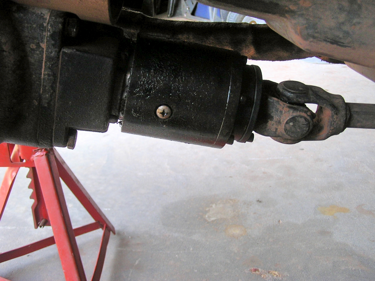

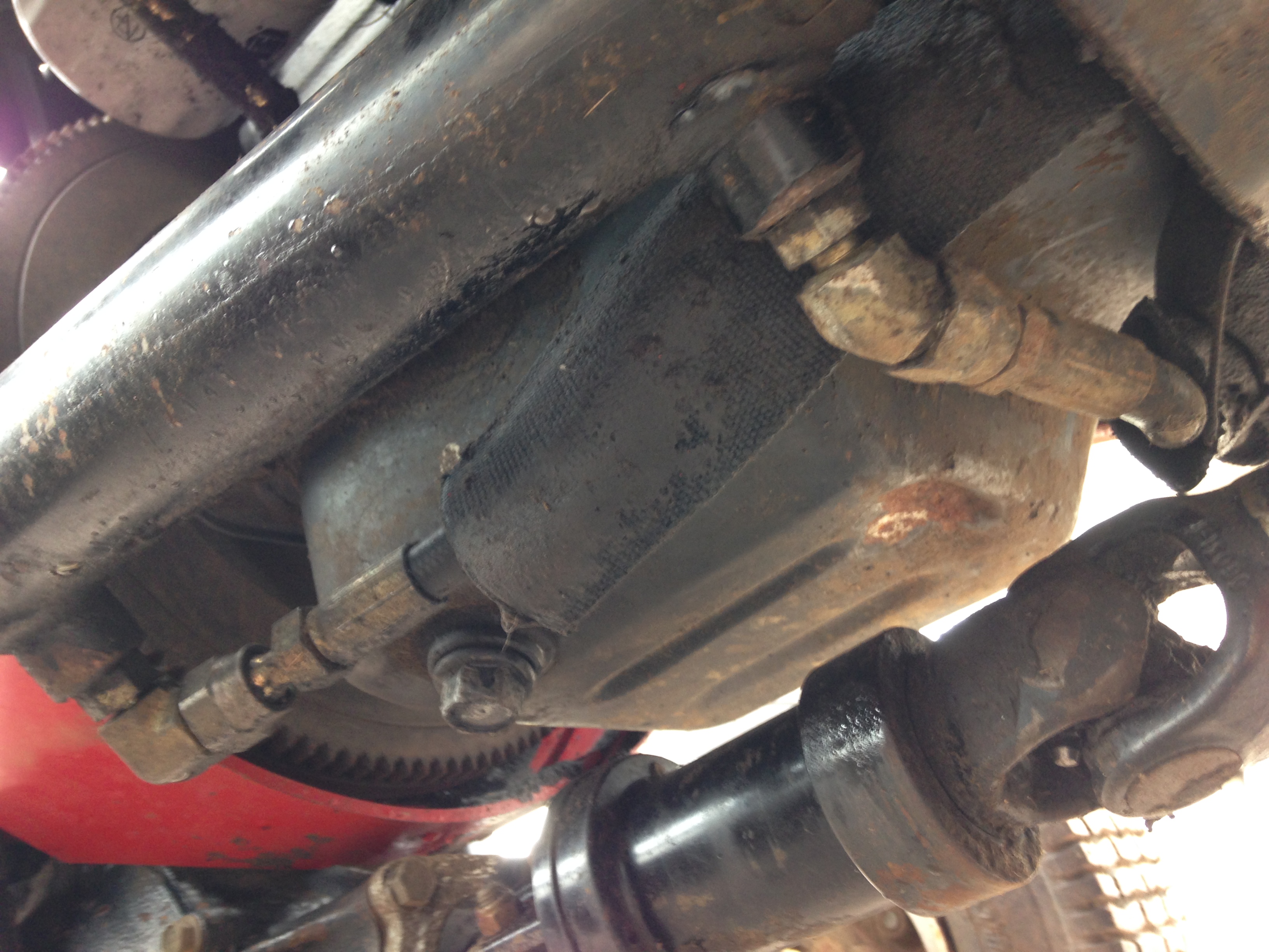

Taking the pump out is harder than working on the pump. Only problem hard to get spare parts, and very expensive.
When I had pump apart all pistons and cylinders looked good. I think I'm going to be looking at the charge pump without taking out the whole pump.
Ill let you know what I find.
   / any toro groundsmaster fans on here? #240
You really think so? It's only like four bolts a couple lines and the link thing to the belt drive. I swapped them out pretty quick. I haven't taken the pump apart because I've been waiting to get a handle on what to look for once I do.
