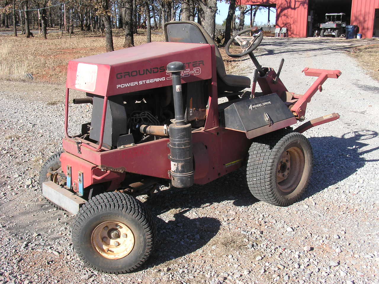

   / any toro groundsmaster fans on here? #246

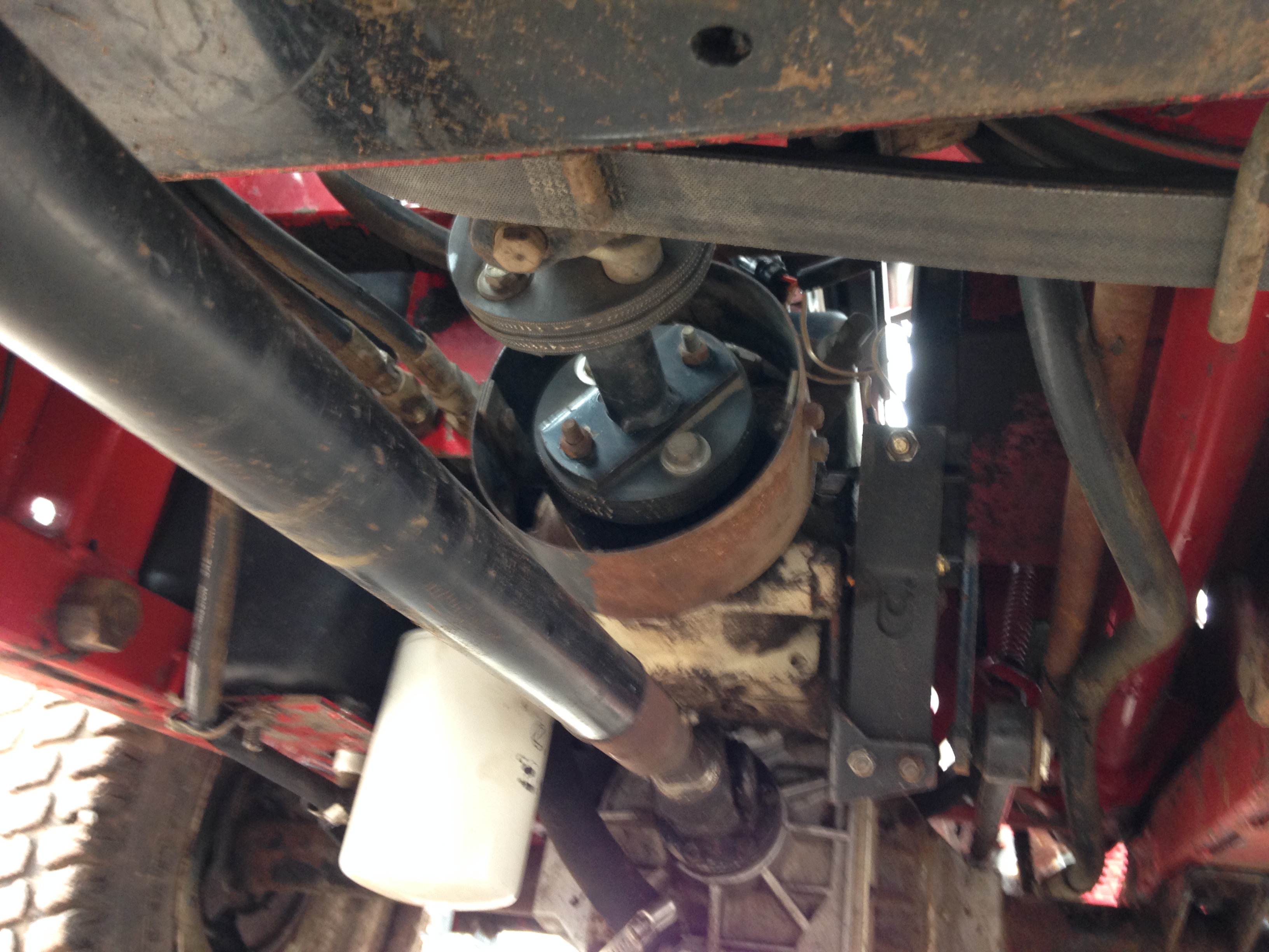

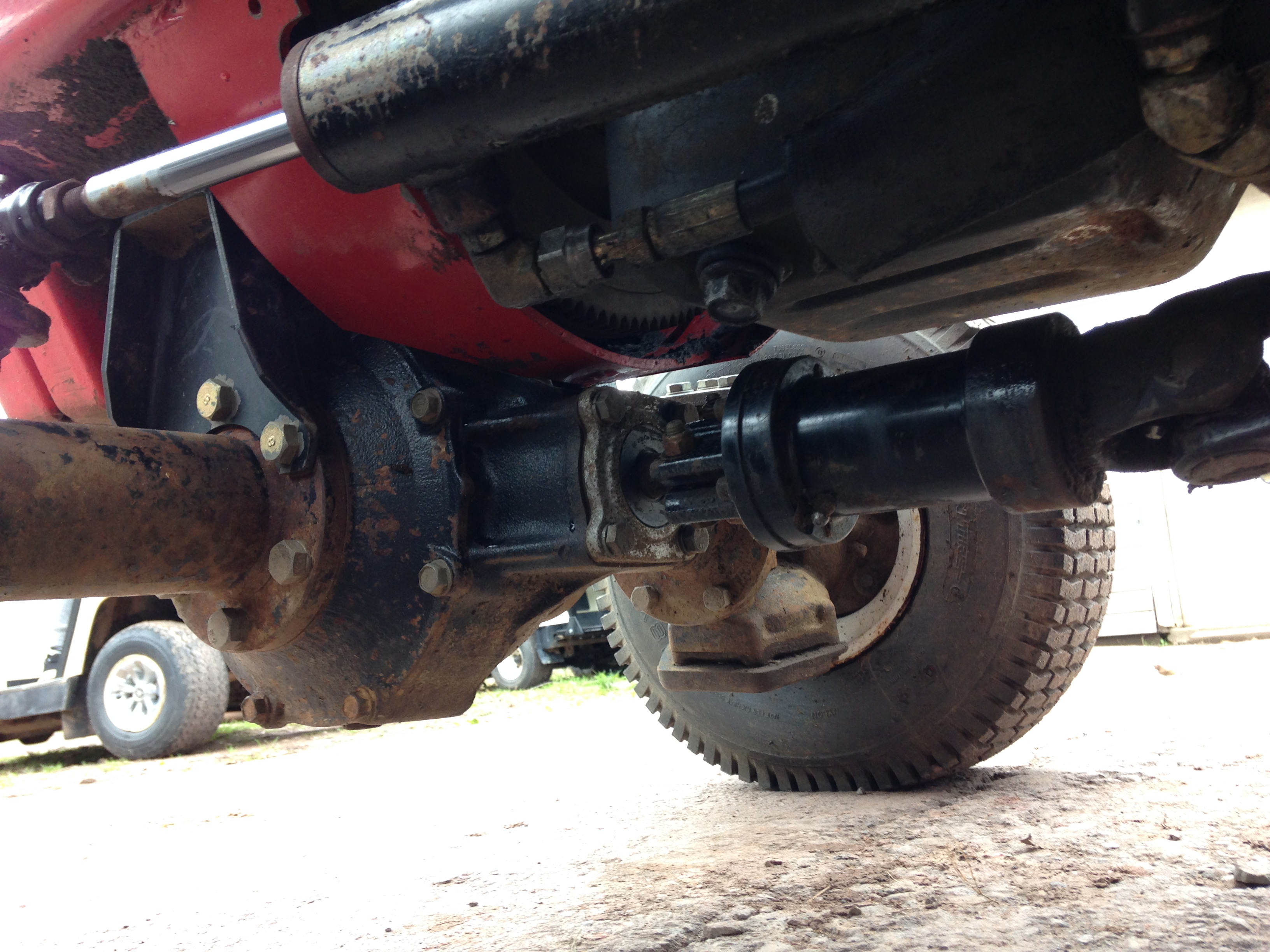

Hi guys
I recently picked up a 4wd 325D from an ebay auction (1200 miles in 2 days to retrieve it) and I'm getting it back in order. Something caused the 4wd shaft to break at the spring pin hole on the rear axle spline shaft (considering it's clamped AND pinned, that was some serious disregard, I still can't figure out how that happened). The rear part of the shaft along with the 4wd clutch got thrown away and the remaining part of the shaft beat the hydraulic filter to heck and back. That also pulled the suction hose off the supply fitting which bled out most of the hydraulic fluid.
Anyway, I got that all sorted out and there's enough pinion shaft left that I will be able to drill a new spring pin hole without having to replace the pinion and ring gear. I found another prop shaft and clutch so I'm good to go.

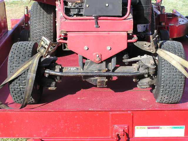

Here's my question: After getting one of the rear tires repaired and replaced, the rear wheels are severely pigeon toed. I know toe in is supposed to be 0-1/8 inch and this is more like an inch or so and there's no adjustment left on the tie rod. There's some evidence that one of the knuckles wasn't put back quite right and I'm wondering if maybe somebody replaced the tie rod with a different part. Before I cut out a section of the current tie rod, I'd like to verify that I'm solving the right problem. Can someone measure the length of the tie rod (excluding the ball joints) and the outside distance on the rear tires?
thanks!
Paul
   / any toro groundsmaster fans on here? #247

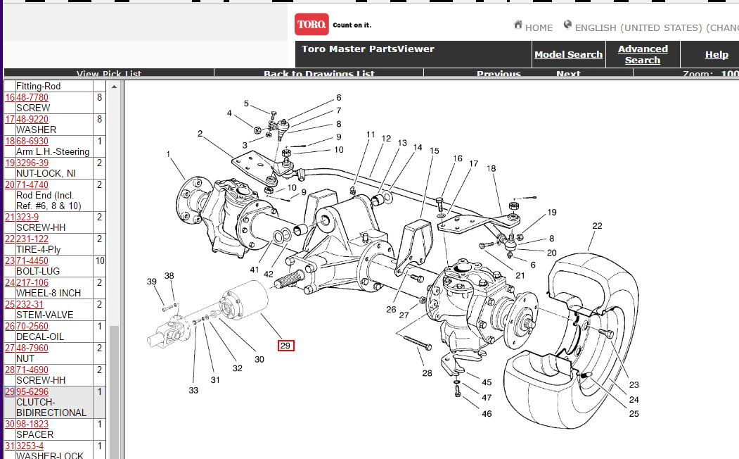

I hope you bought a bi-directional clutch (PN 2995-6296), it will replace the older models forward only clutch.
What year is the 325D?
The tie rod on my 1996 is 26-3/4, measured straight line across the top to the center of the rod.
My fat 18 x 8.50 x 8 rear tires measure 46-3/8 ahead and 46-1/2 behind, using 2x6's against the tire.
Those are 16 x 6.50 x 8 tires in this picture above.
And the bigger tires below:
   / any toro groundsmaster fans on here? #248
I believe I also have a 96 (30795-60460). I ended up with the one way clutch from a reelmaster, but I'll keep an eye out for the bidirectional one.
That's very interesting on the tie rod; mine is 27-1/4 straight across. I was thinking it looked like it needed a 1/2 inch or so out of the middle.
This machine came out of a county park department in NJ and I can't say I've been impressed by the mechanics that worked on it. You really shouldn't need a breaker bar to loosen the oil drain plug. At least it had oil in it.
The air cleaner was missing the bottom piece and had deteriorated badly so I just today finished fabbing a new bottom piece that's held in place by a couple of spring latches and getting that all welded up and painted. I will finally get to try starting it in a day or two when I get back out to the farm.

   / any toro groundsmaster fans on here? #250
Paul:
You may want to try bending the rod, as opposed to shortening it. If you bent it outward (away from the rear of the unit) you could easily get 3/4in reduction and gain some clearance... this way, should you replace the tie rod ends/etc. with proper pieces later, it can be returned to stock.
Just a thought.
