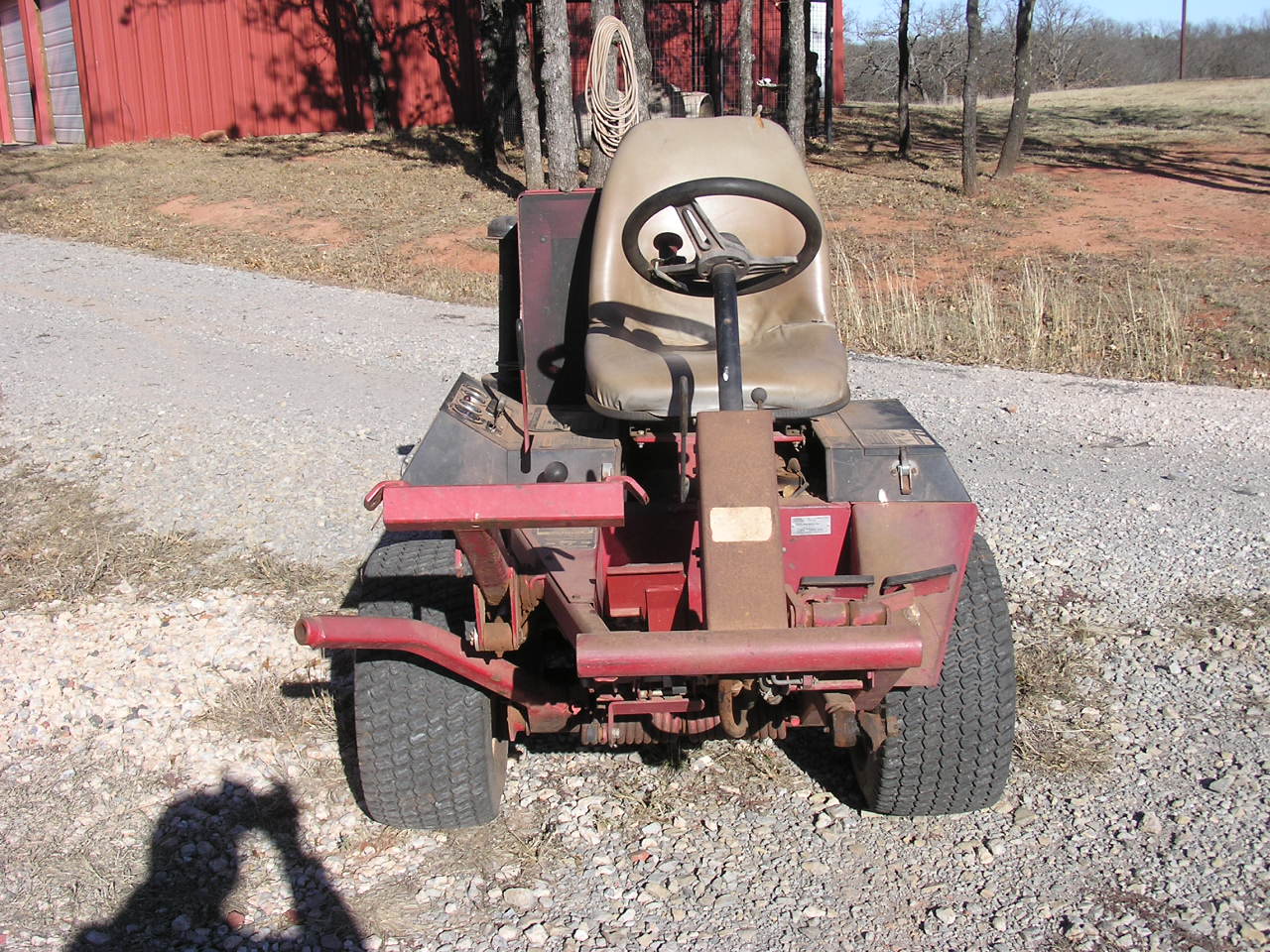

The service manual says there are two types of rear axles, the Insaka, and Dae Wong. This is why they have two types of clutches.
Service manual also says the reason for the over running clutch is during sharp turns the tail end swings out in a wider arc than the drive wheels. This causes the rear tires to turn faster than the front. I’m assuming this would cause binding and such on a full time 4wd set up.

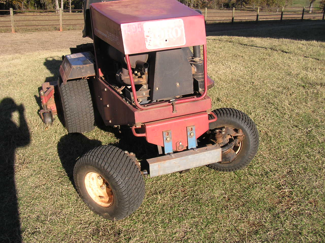

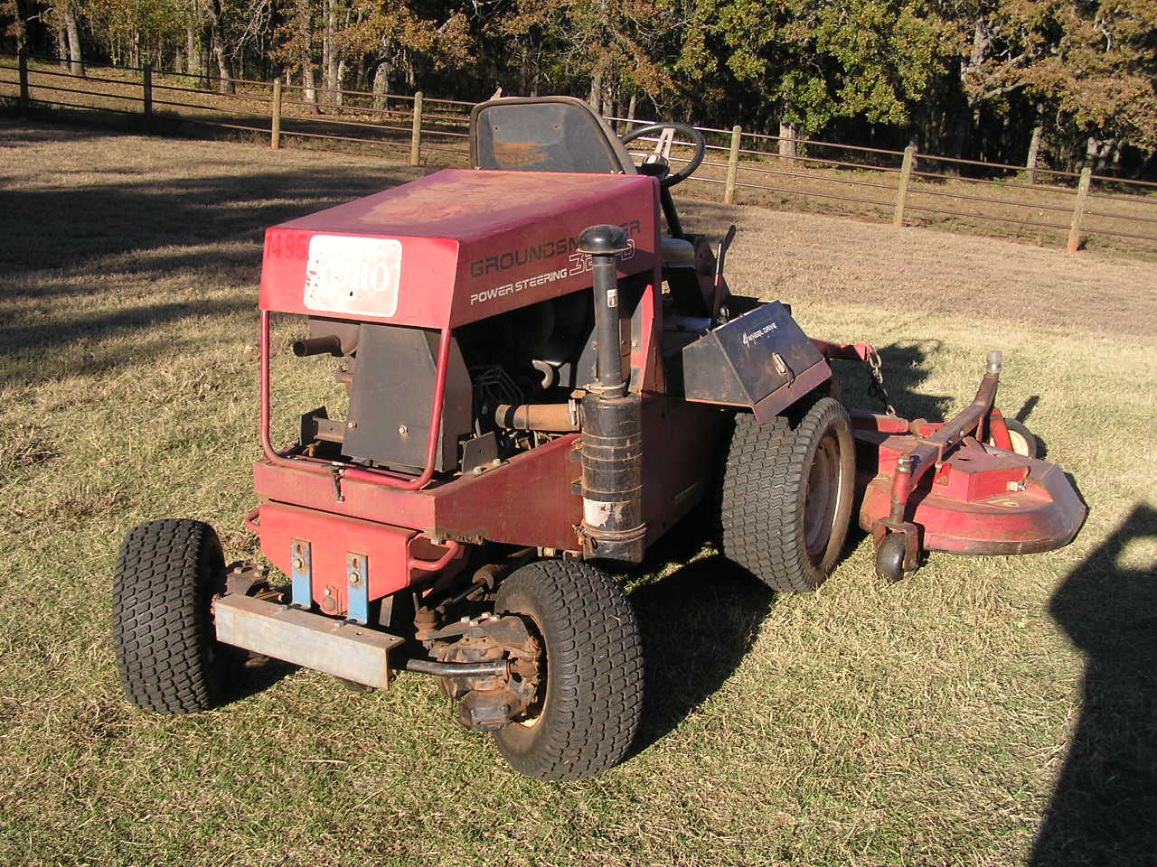

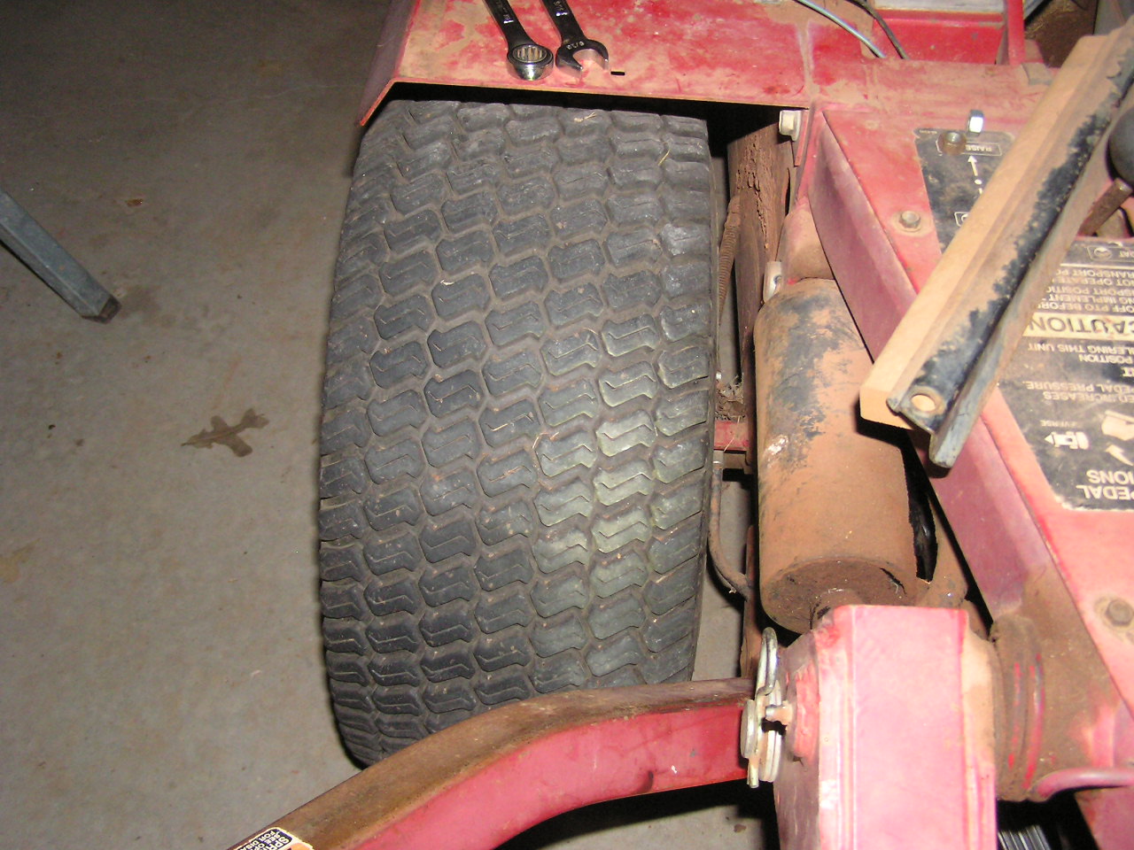

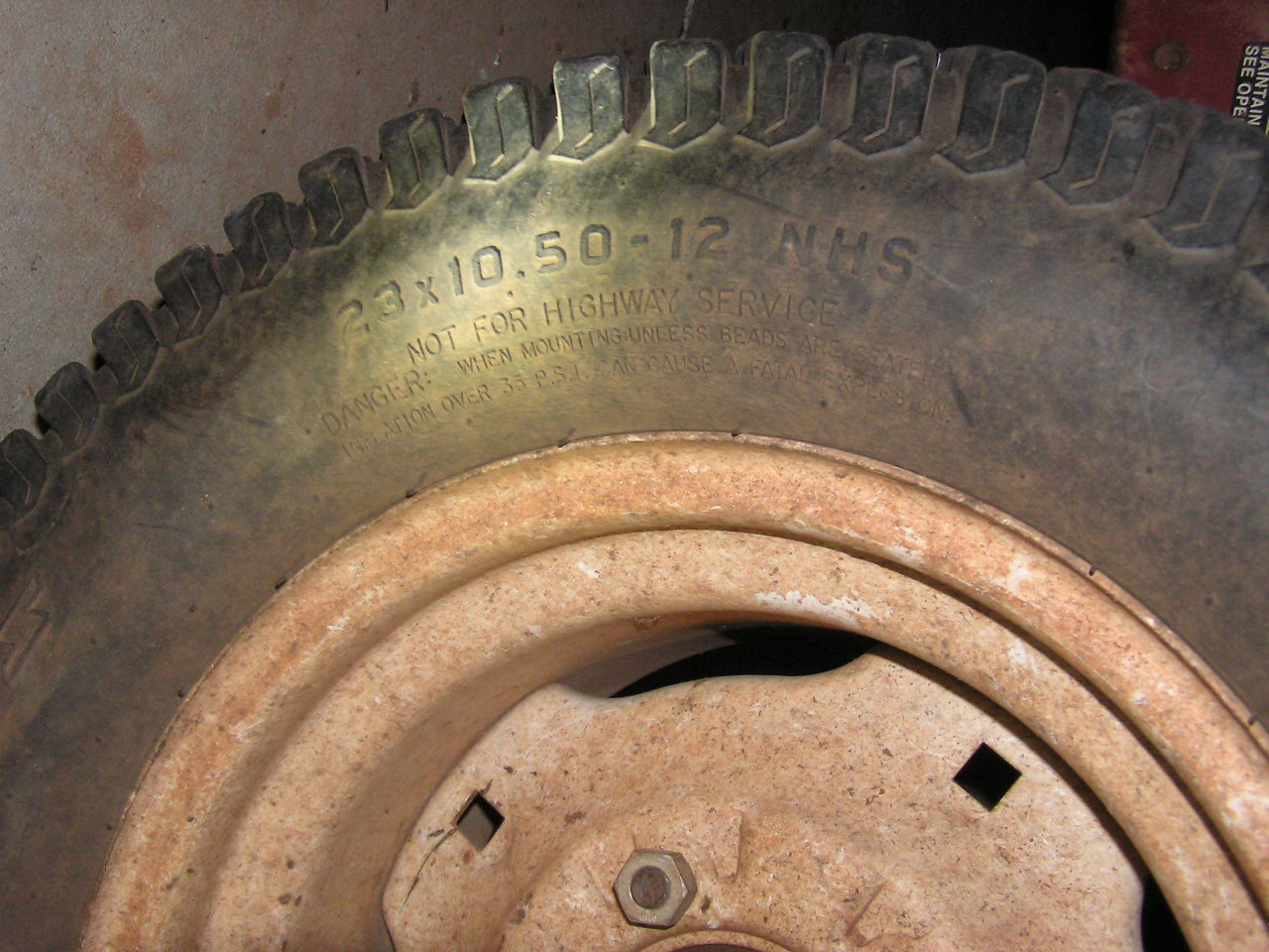

Has anyone put wider tires on these for better flotation over soft ground? I see 23x10.5x12 was an option for these. Would something wider fit?
Yes, with the proper wheel offset.
Would something wider work? Not much wider with most of the mower decks. The rear deck wheels would hit the wider tire.
These are 23x10.5x12:
This shows the tight clearance with the Recycler deck. The rear wheels don't swivel like the side discharge deck does:
   / any toro groundsmaster fans on here? #476
Those look like they would work nice. Are you saying the 10.5” tires would hit the swivel wheels of a side discharge deck though?
   / any toro groundsmaster fans on here? #477
No, the side discharge deck has clearance:

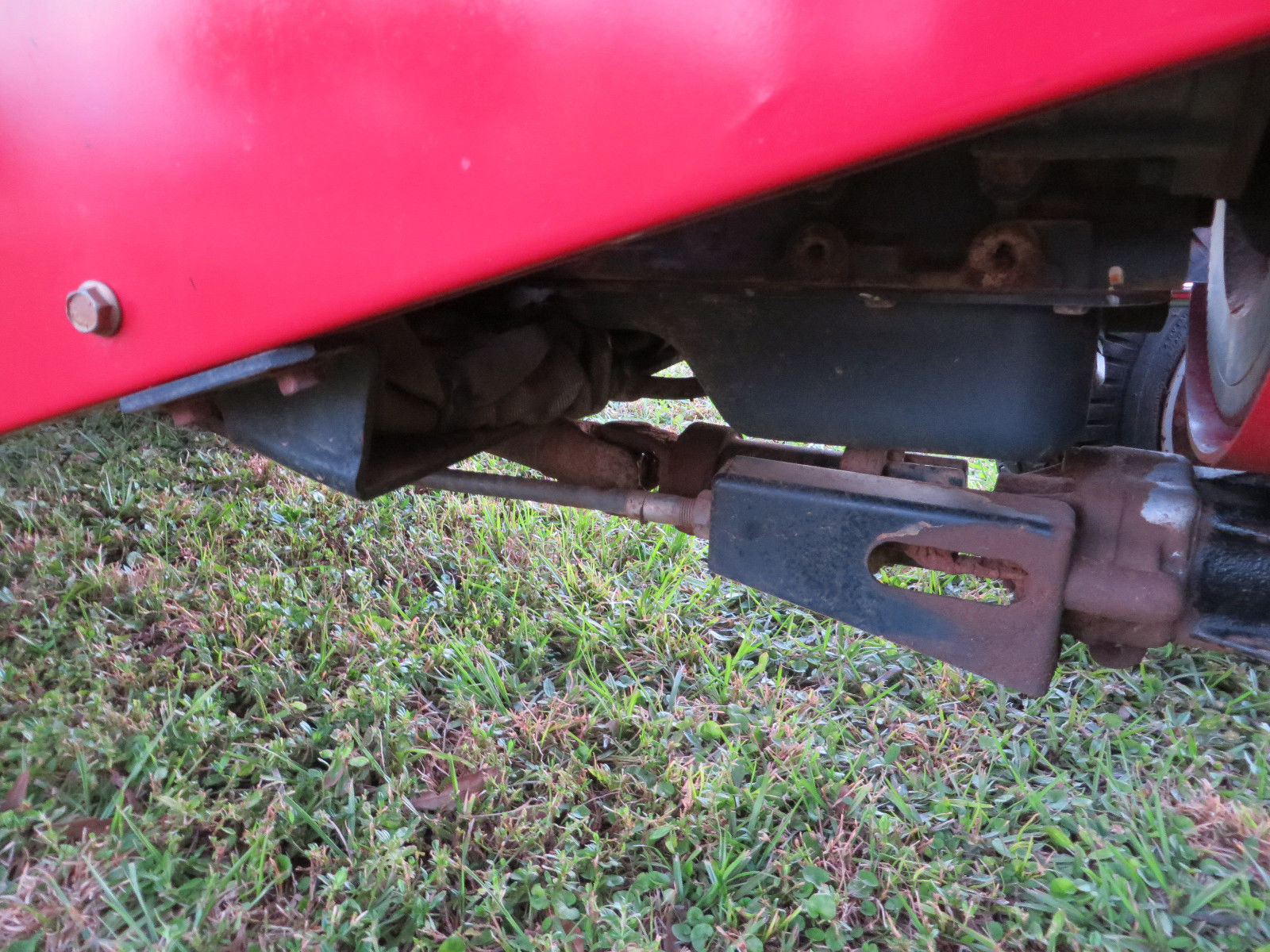

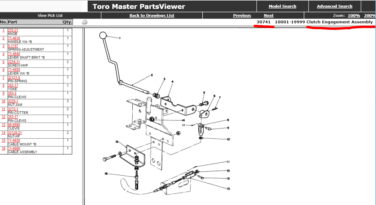

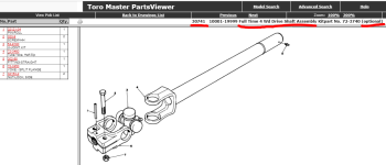

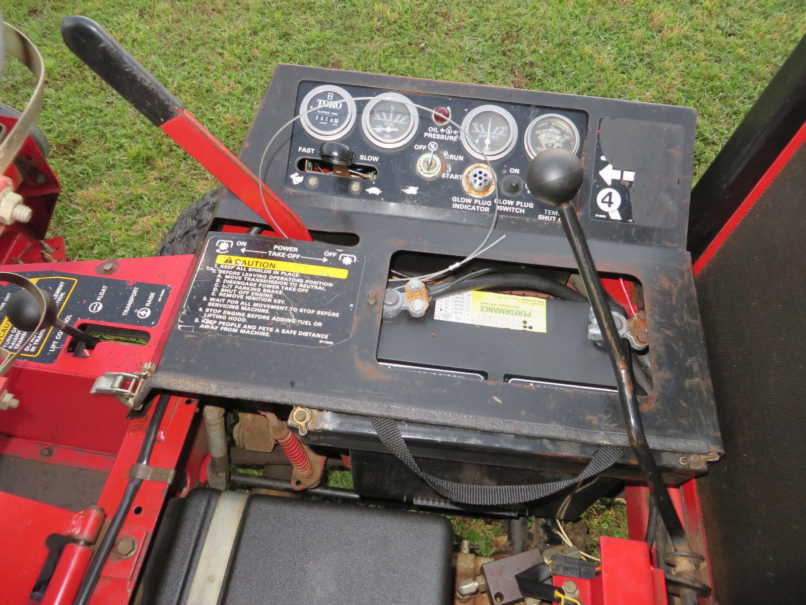

I don't much care for the bi-directional clutch. Is the a rear differential that could be used for a full time 4x4 with a shifter? I'm guessing it would be pretty hard to come up with something without replacing the whole drive unit.
The model 30741 has a lever to shift to 4WD. I have seen one at a repair shop. Don't know any details of how it works. Found some pictures a long time ago:
And a snip from the parts viewer. I couldn't find the clutch that it operates:
And the optional full time 4WD driveshaft that clamps in place of the overrunning clutch:

Thank you for clearing that up. Have you ever noticed your 4wd kicking in on a steep slope or loose Ground? I would imagine it is almost transparent to the operator when it does start to work.

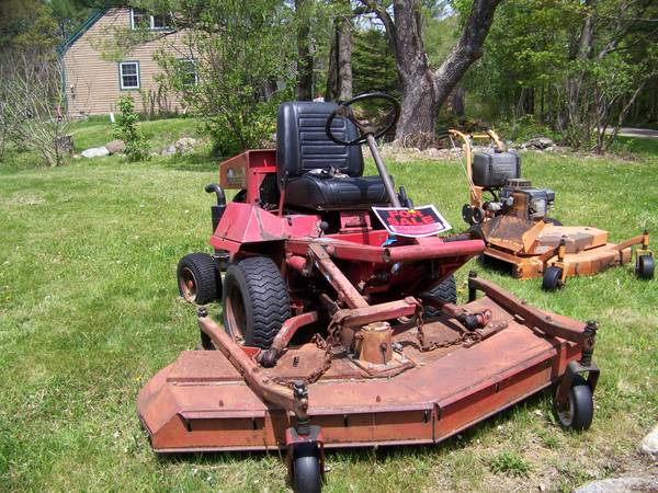

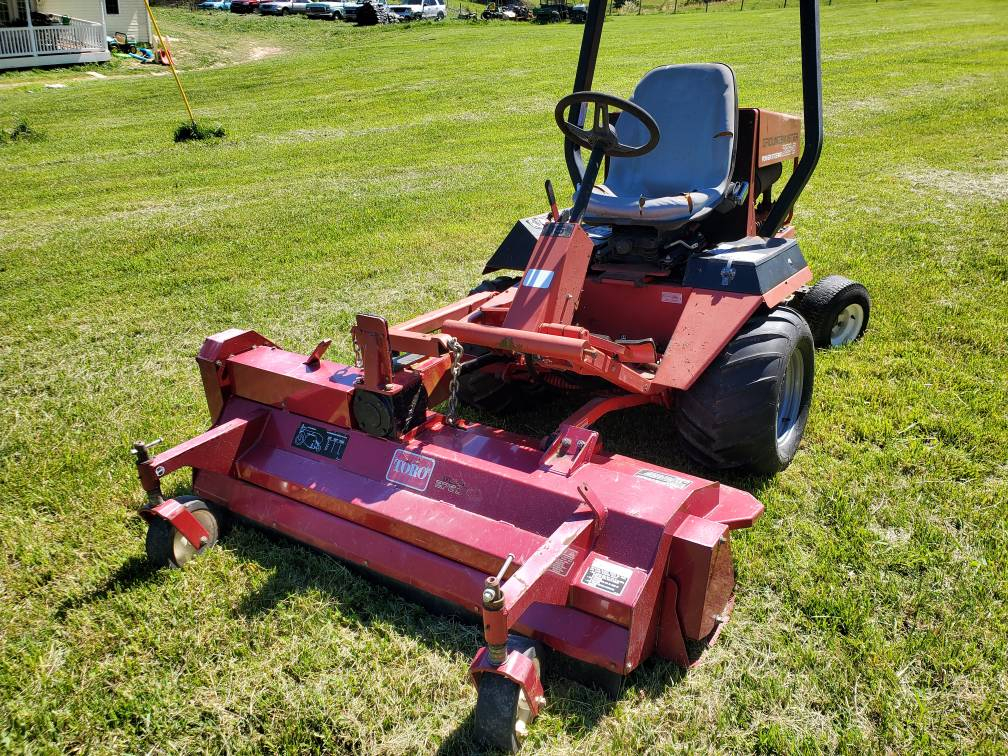

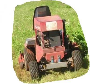

I found a picture of that strange side discharge deck with the removable front lip. It is in fact a groundsmaster deck, the one in this pic appears to be a 60”.
   / any toro groundsmaster fans on here? #480
Yep, rarely noticed it kicking in. I removed the bent driveshaft on the 328D to straighten it and it wouldn't go places with 2WD, that it went in 4WD.
That is mounted on a Groundsmaster 72, the predecessor of the 300 series, so don't think it is 60" deck.
Those are slots on the front, to allow raising for tall stuff:
