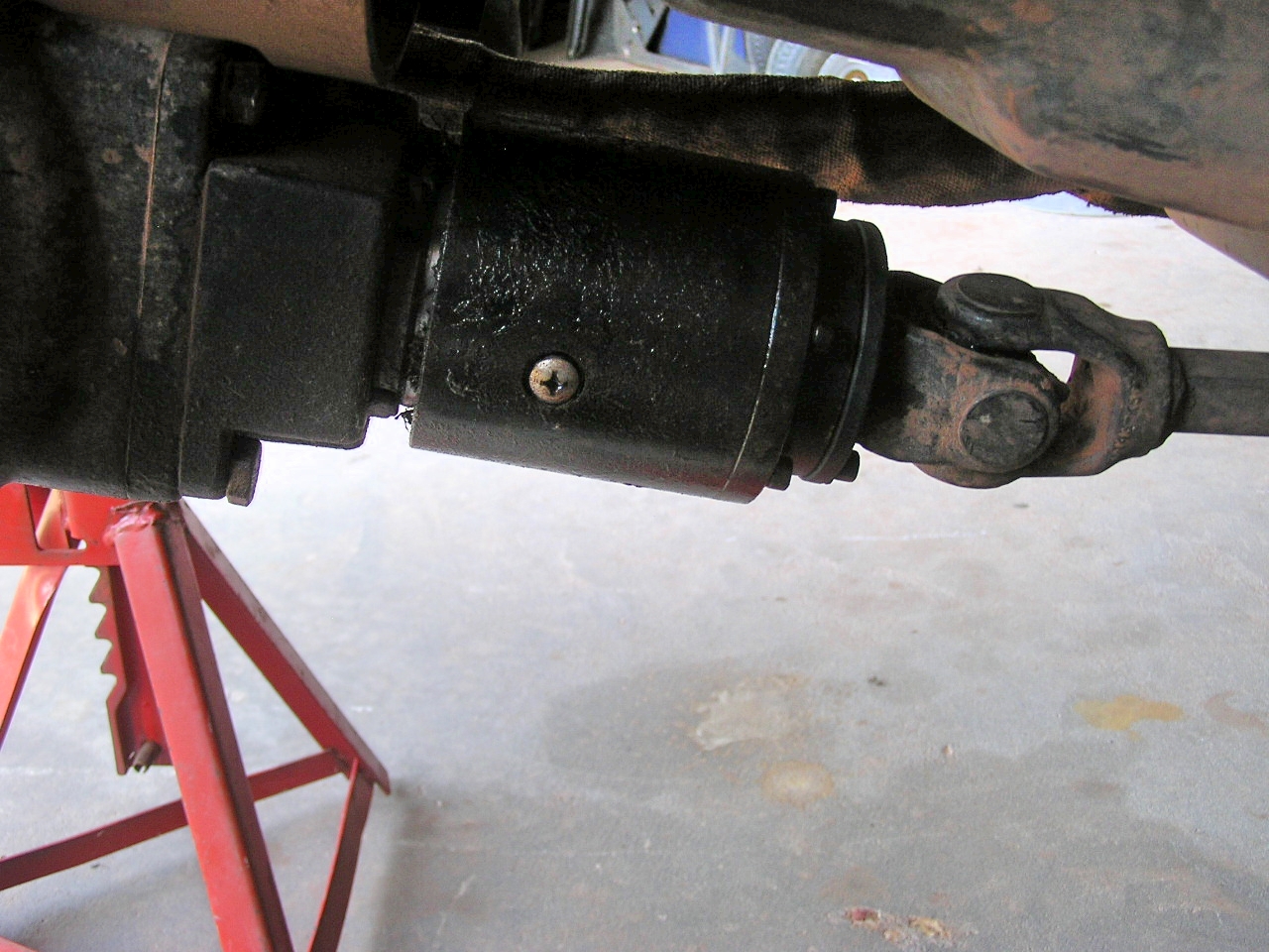

Asymair95, last thing first, it is a forward only overrunning clutch. The full time clutch is cable operated by a lever next to the seat.
First thing last, I can't tell for sure about the decks without a serial number plate, but I know that I wouldn't do the swap, but that is just me.
   / any toro groundsmaster fans on here? #462
The clutch looked different than ones I had seen on here. It has a grease zerk instead of a plug for gear oil.
The thought of having a brand new deck shell is appealing, particularly considering the price he wants (cheap). Why wouldn’t you do it? Too much of a chance things wouldn’t fit?
   / any toro groundsmaster fans on here? #463
Yep, saw that zerk. Hope it didn't get greased, I don't think it will work with grease in it.
I wouldn't do the swap, because I am old and lazy and can afford to buy a new or good deck.
   / any toro groundsmaster fans on here? #464

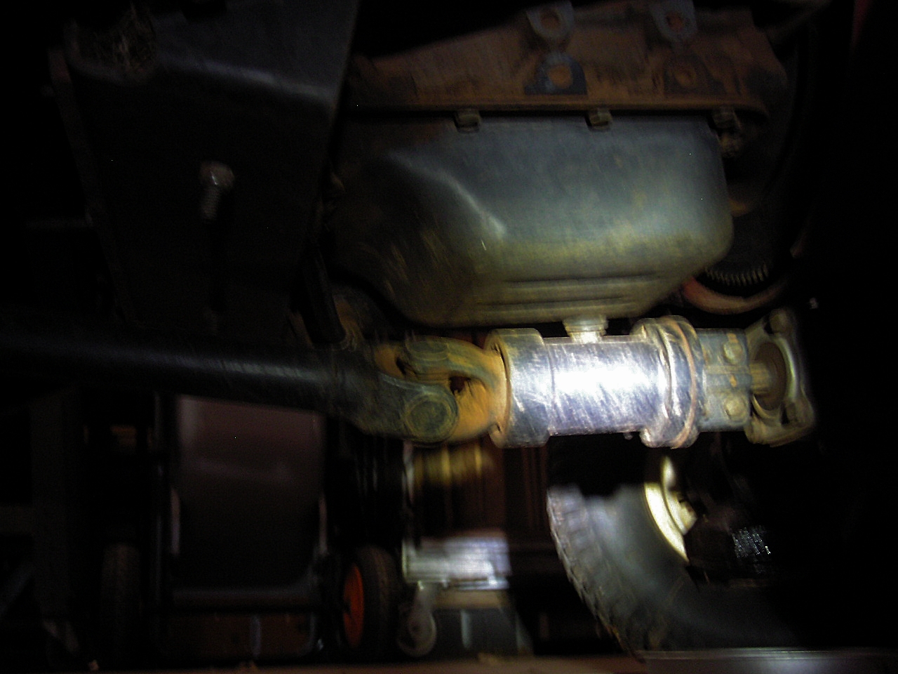

I was hoping it was a different kind of clutch as it doesn’t look as big around as the gear oil lubed type. You can tell the shaft had broken at some point also because there is a dent in the oil pan.

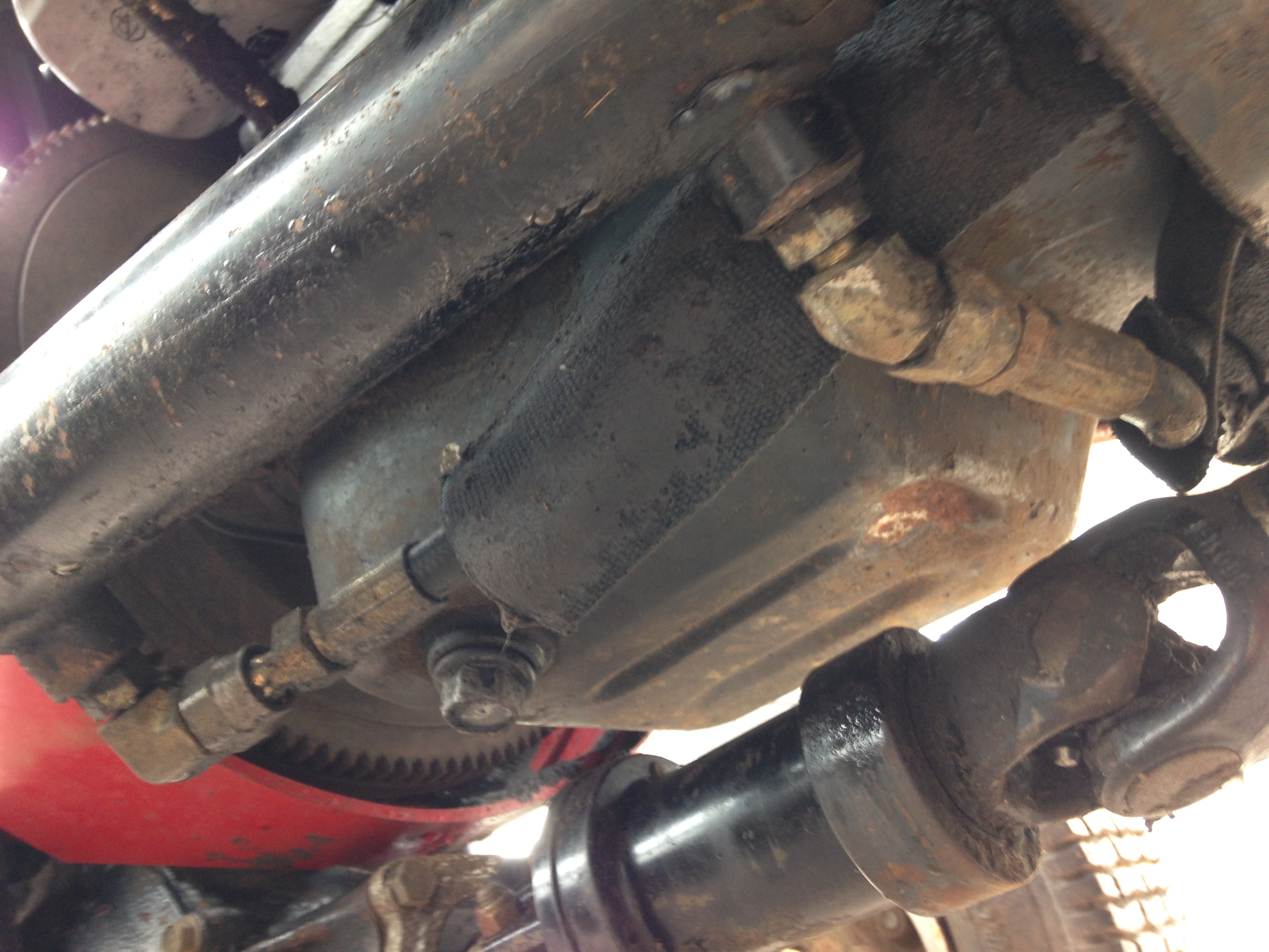

To me it looks like my 325D one way clutch:

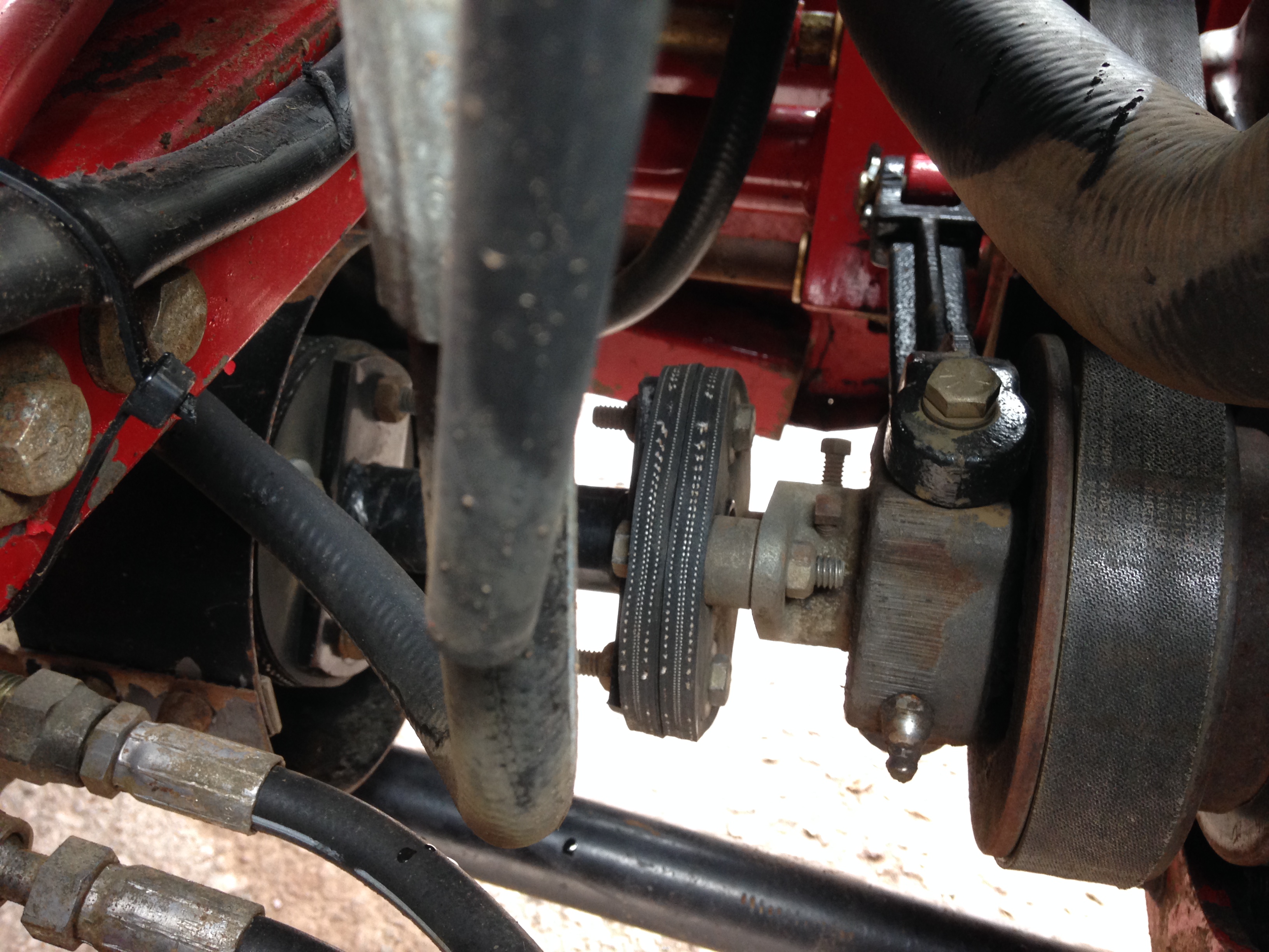

This is the larger diameter bi-directional clutch on the 328D:
But you triggered something way back in the dark corners of my memory. Seems like there is a kit that eliminates the clutch and hooks the driveshaft directly to the rear differential. Probably not recommended for hard surfaces.
   / any toro groundsmaster fans on here? #466
Yup, that bottom pic is the one I was thinking of with the gear oil in it. Does your other clutch pictured above have a grease zerk too?
   / any toro groundsmaster fans on here? #467
Yep, the 325D has the zerk, Rotated the driveshaft and shined the flashlight on it:
Edit: Copied from service manual "Lubricate clutch through grease fitting (Item 32) with No. 2 General Purpose Lithium Grease."
