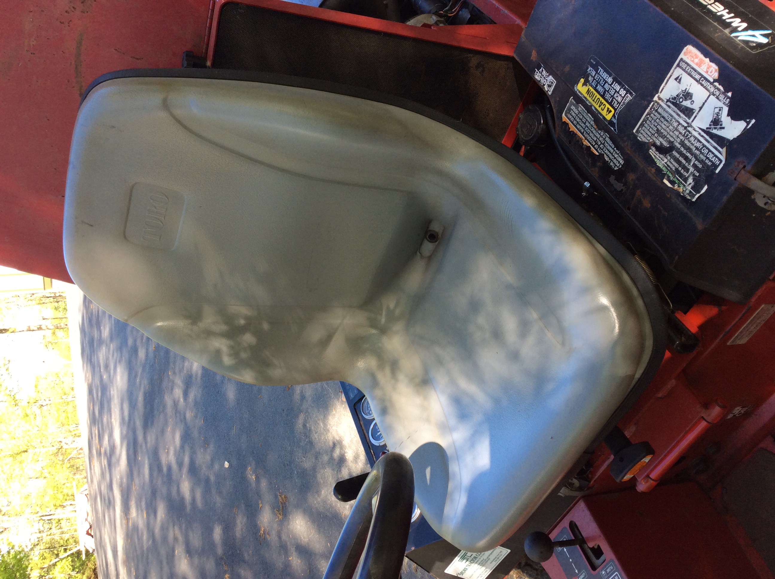

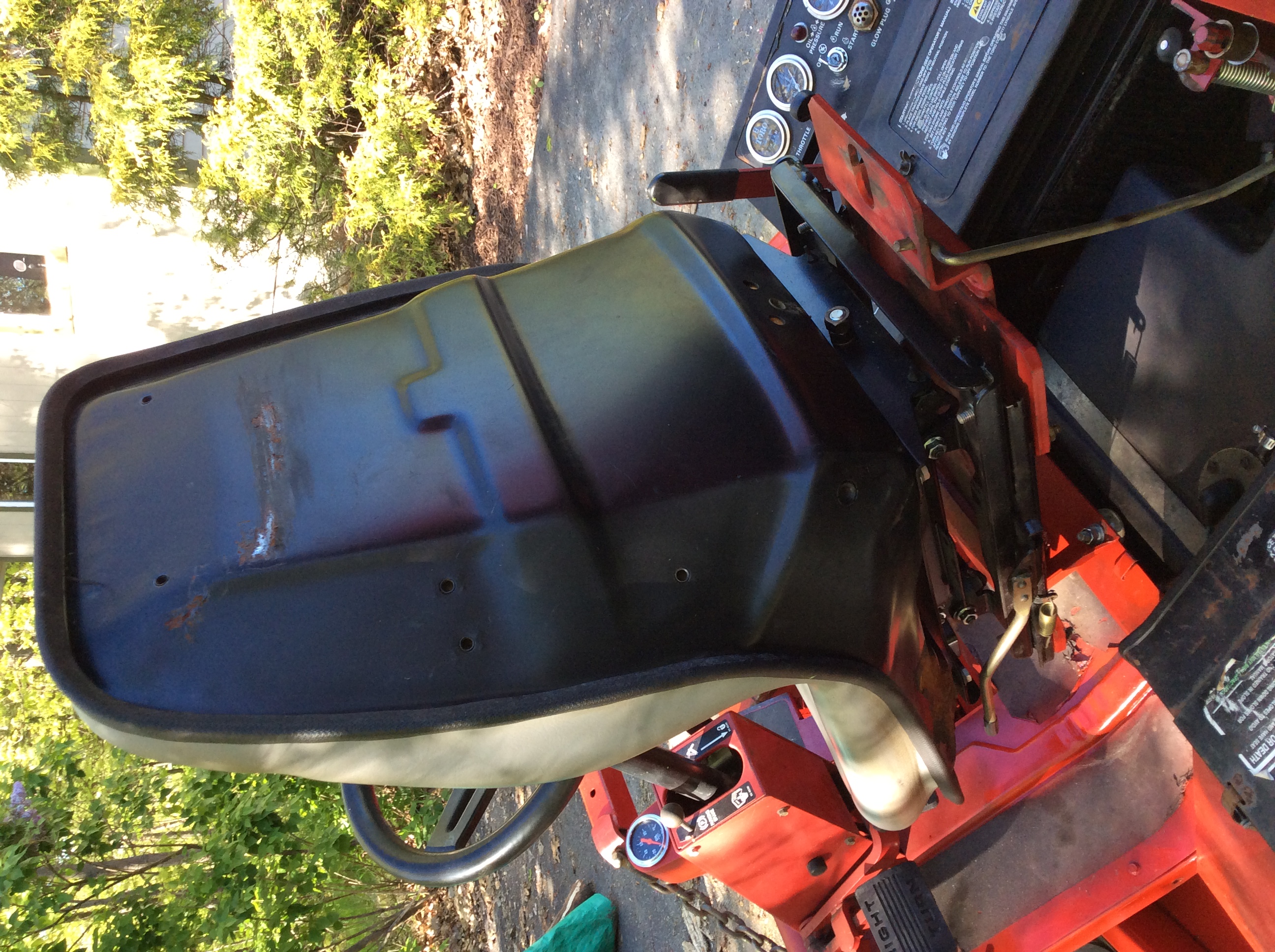

Is there a source to purchase armrests from for my 325? It has the factory toro seat on it.

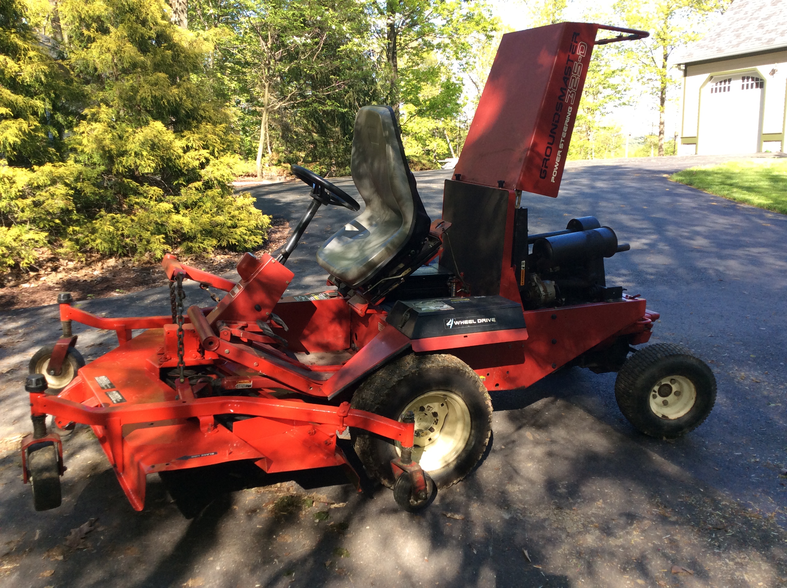

Got to mow for the first time with the 325 and sd deck. What a great mower! I definitely need to adjust my landscaping to make it easier to get around things. I致e found it is slower than my zero turn was, but because of the larger deck, it is a wash. It痴 going to take awhile to get used to the tail end swinging out on sharp turns, I almost clipped a few trees today with the rear tires. The cut is real nice, no complaints there. A hero shot after mowing. The biggest surprise was how much more comfortable the ride was. It was much better than my zero turn.

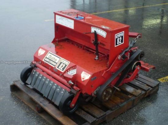

Tomorrow I知 going to look at another 4wd 325 with a model 82 seeder on it. Has 3500 hrs on it, so she is no spring chicken. Do you have any experience with this slit seeder? I guess it is made by olathe.

Xfaxman,
Yes, but I don't know it. See if the seat has a manufacturer's name on it.
armrests for toro seat - Image Search
Got to mow for the first time with the 325 and sd deck. What a great mower! -----------------------------
Looks like the lift chains are not adjusted correctly. The operator manual shows how many links to use.
Tomorrow I'm going to look at another 4wd 325 with a model 82 seeder on it. Has 3500 hrs on it, so she is no spring chicken. Do you have any experience with this slit seeder? I guess it is made by olathe.
No experience.
