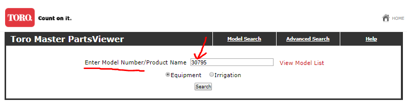

Call some local golf courses and ask where they get Toro parts. There are many Websites that sell Toro parts, just do some searching.
The residential dealers may not be able to order parts from the commercial division.
The best place to get part numbers is here: Toro Master PartsViewer
They put the year made in order, not all jumbled up like the online store did:

The Master Parts Viewer will show if the part numbers are the same:

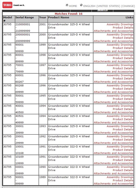

How do I figure out the year of my Toro with the serial number?
you can tell the year of manufacture by the serial number. Just turn the first 2 digits around (49xxxx = 1994)
Not for the Traction Units. The first digit is the last digit of the year, up to 2000. Then the first digit is the first digit of the year and the second is the last digit of the year.
Fortunately I saved a list showing the year from before they removed the year from the list.
Notice that 91, 94 and 96 have a serial number split during the year:

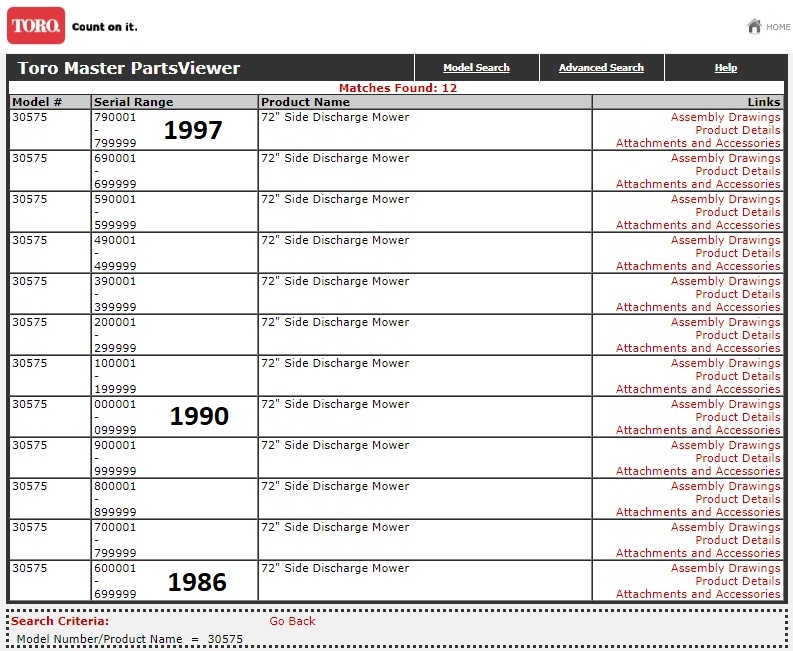

I am looking for a deck - Model # 30575 for my 1996 Toro 223D I didn't keep up with cleaning and coating the past few years and it is rusted pretty bad. It is still rebuildable if I do not find a replacement
I would buy a whole machine for the deck or to replace what I have.
The following machines used the same deck. Groundsmaster 62, 217D, 220 & 224
