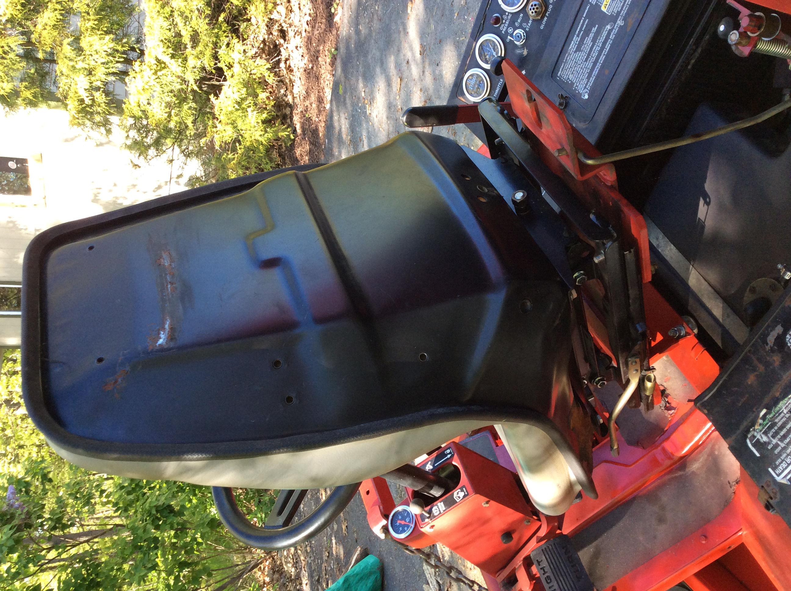

Post a picture of the mounting holes, I might be able to set you up for not much more than the price of shipping...
Aaron Z
   / any toro groundsmaster fans on here? #692

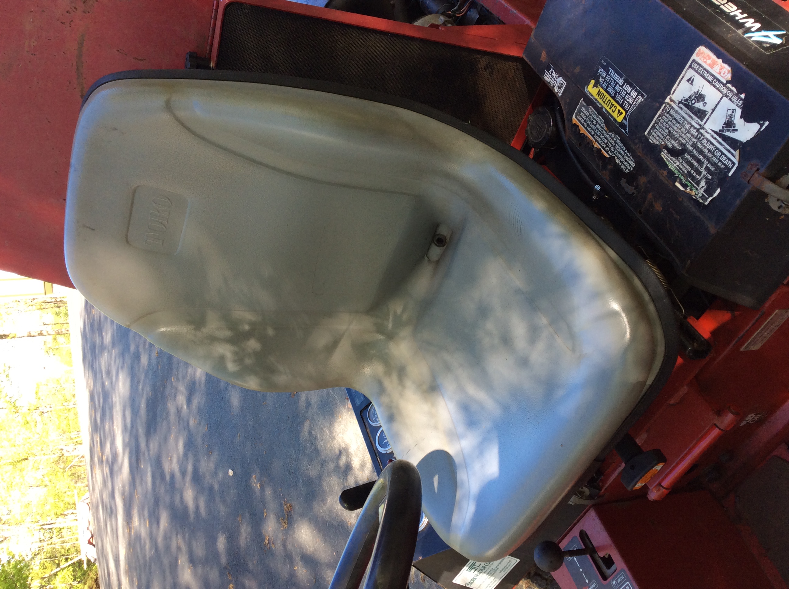

A-Z clan, here is a pic of the seat.
   / any toro groundsmaster fans on here? #693
Not meaning to hijack this thread, but since it has evolved quite a bit since its origin I am hoping it is okay to post a related Groundsmaster question. I am the original owner of a Groundsmaster 52 which I purchased back in 1982. Other than the two occasions when the carburetor Welch plug fell out, causing catastrophic engine damage, everything else is original and working well. I still consider it my daily driver for a three acre lawn. After all these years though, my back is not what it used to be, meaning that the original seat does not provide the kind of protection against jolts that my aging back now requires. So, when shopping around for a suspension seat to replace the original white non-suspension seat, i find that seat replacements available now use a universal bolt pattern for mounting. Unfortunately, this new universal bolt pattern is not anywhere close to the original. I can make an adapter plate, but these new suspension seats are also much deeper (front to back) than the original seats. Maybe they will squeeze into the space available on the GM 52, but I am concerned they may be so deep that once mounted, the rear hood covering the engine will not be able to be lifted open anymore. I am looking at the Milsco V5300 suspension seat, but due to the issues just mentioned, I am hesitant to plunk down over $350 for it, only to find out it may not fit. If there are any other GM 52 owners here who have switched out their seats for a new suspension seat, I would sure be interested in hearing what seat you settled on and how well it fits without any problems. Anybody have any wisdom to share on this?

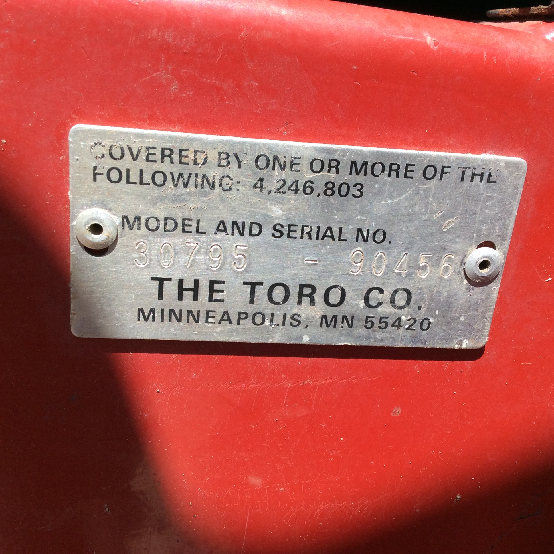

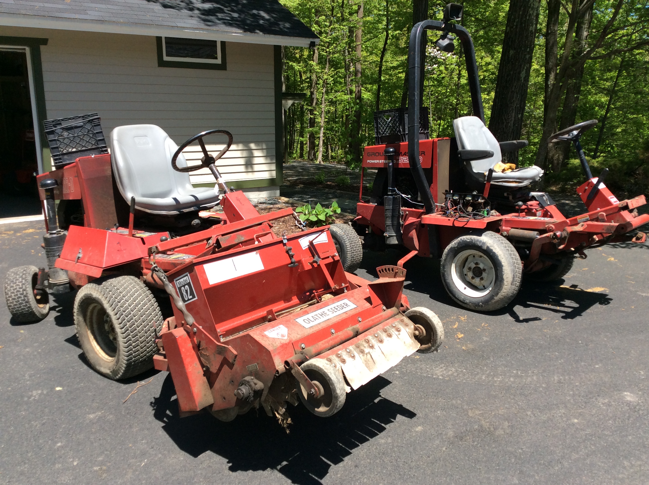

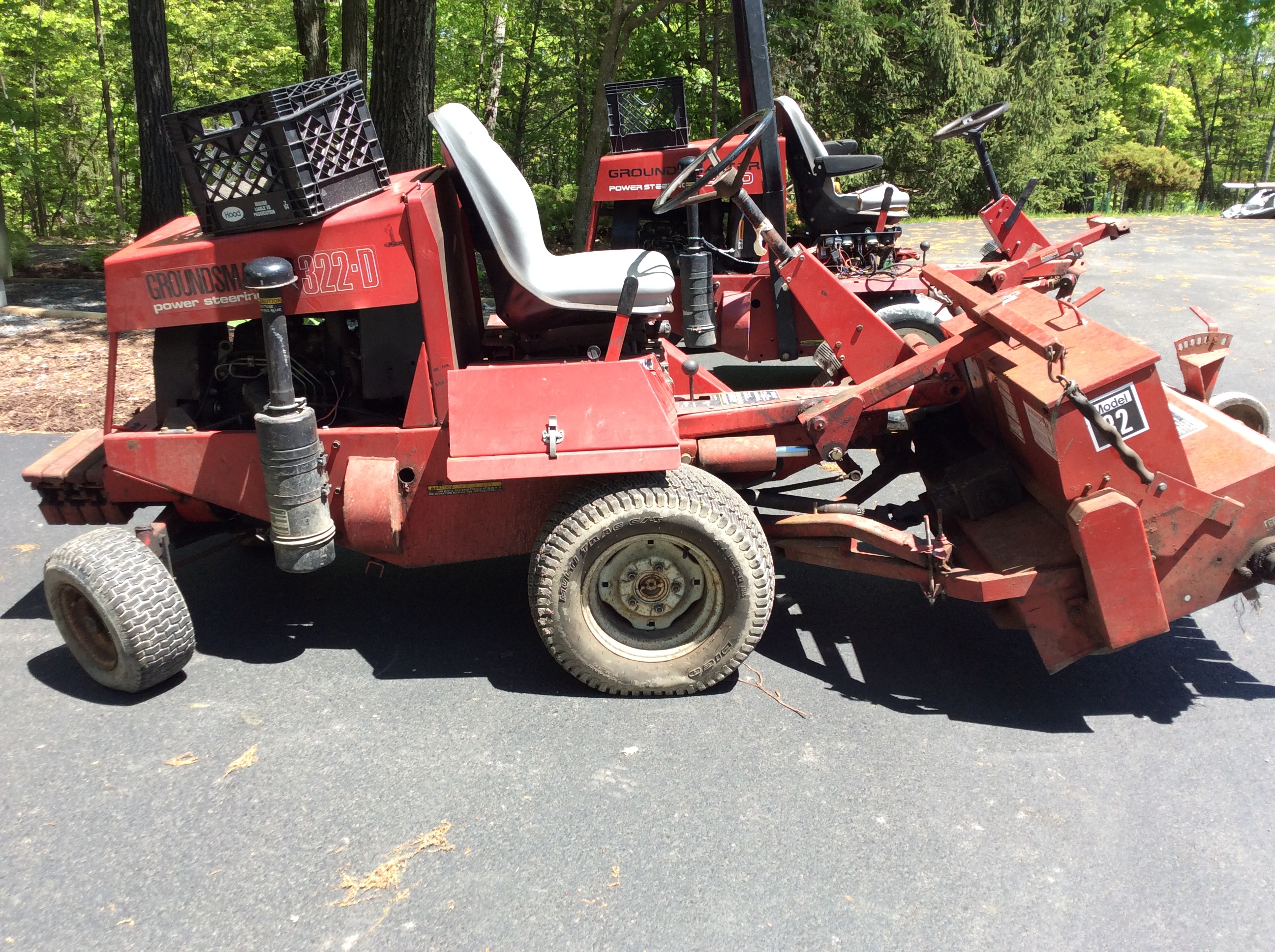

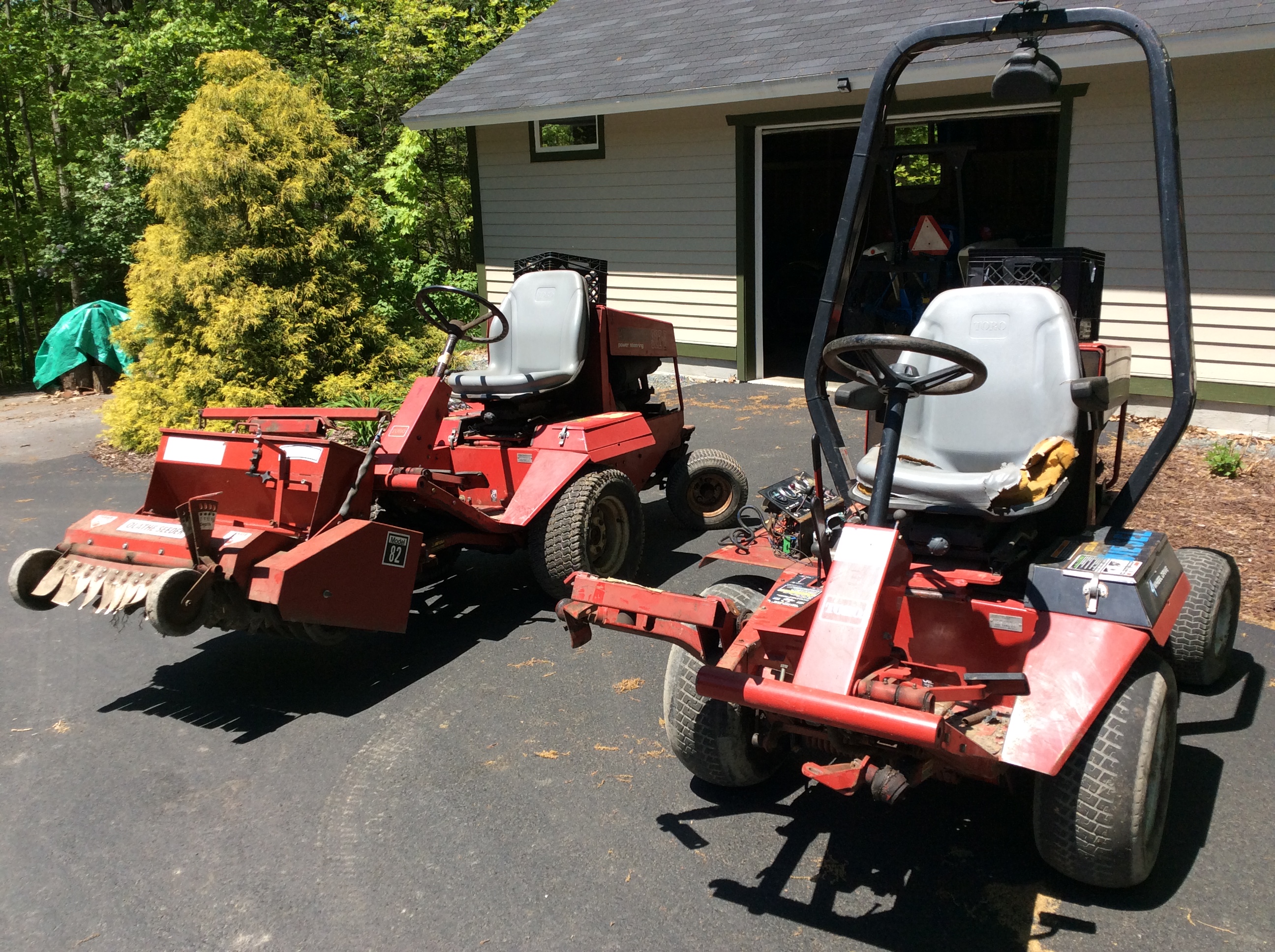

Two more groundsmaster delivered today. A 2wd 322 and a 4wd 325. Pics or it didn’t happen...

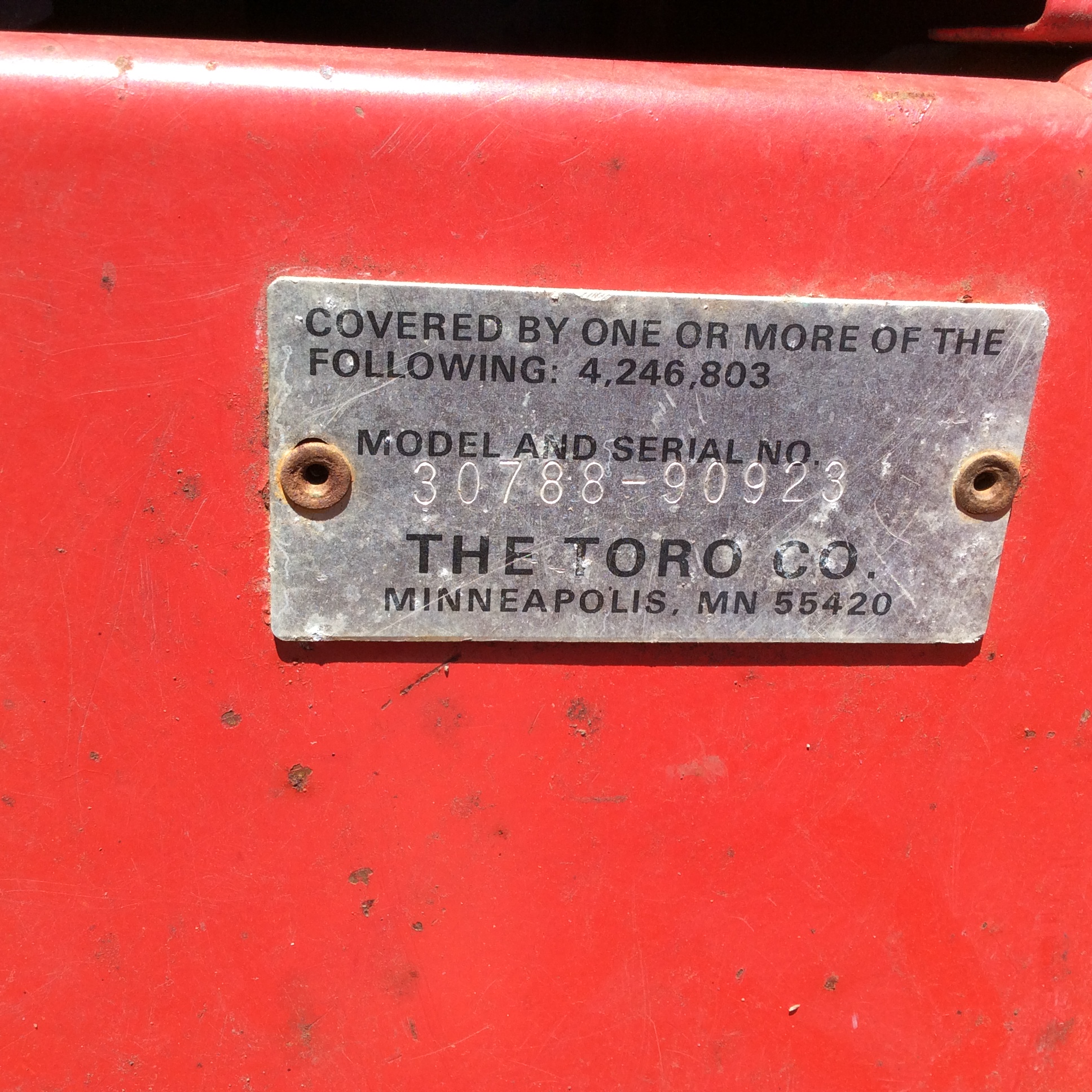

The 322 data plate
325 data plate

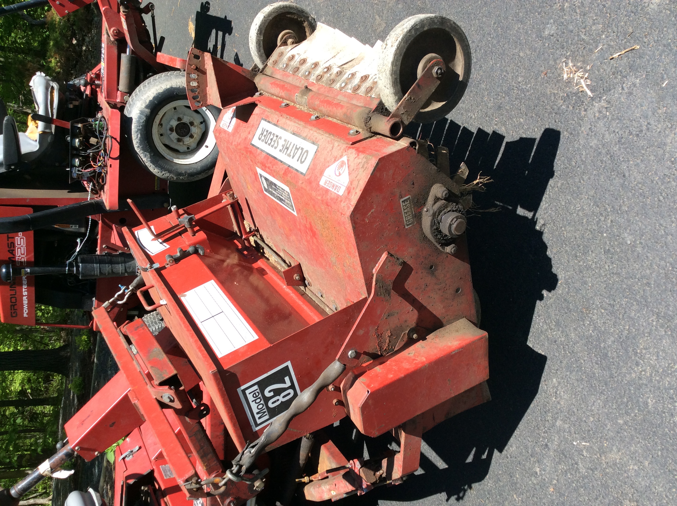

The 322 came with this model 82 Olathe slit seeder. Whoever attached this thing welded it onto the lift arms. I guess it is married tot forever.
Both machines run fine and drive. Hours are 3500 on both. Price was $1500 delivered to my house...not a bad deal.

Xfax,
Am I correct in assuming they are both from 1990? Or, is it 1999? Thanks again.
From what I can tell, they haven’t been used/serviced since 2014.

I have one of these on my 325 groundsmaster and I have no complaints. It bolted right up and works well.
SEAT SUSPENSION FITS BAD BOY,KUBOTA,DEERE,DIXIE,SCAG,BIG DOG ZERO TURN MOWER #FF | eBay
Thanks for the tip. Are you using your original GM seat, or did you use an aftermarket seat as well? The GM 52 seat pan mounting holes will work front to back, but are a bit narrow side to side. A small grinder could add some width to the holes in the pan to allow for bolt heads to sit down in the pan. The GM 52 original seat is rather short to allow riders easier on and off. The better after market seats are several inches deeper, so may get in the way. Will need to do some more searching to find a shorter seat that also is padded well enough, too. My old Wheel Horse 520-H tractor seat would probably fit, so might have to scout around for one of those to mount onto the spring suspension unit that you used.
Vvm
   / any toro groundsmaster fans on here? #698
If I remember correctly it was a direct fit to my factory seat.

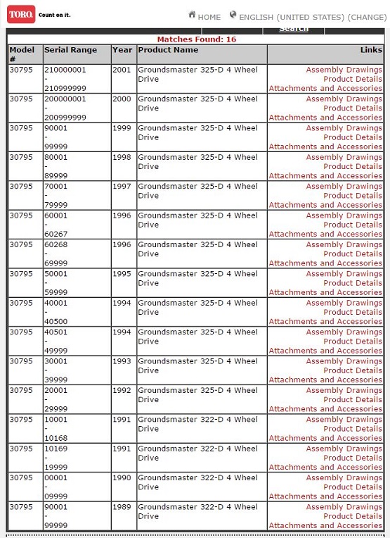

Xfax,
From what I can tell, they haven稚 been used/serviced since 2014.
It is confusing because they are in the same serial number range, but they are 10 years apart.
The 322D ended in 1991, yours is a 1989:
The 325D started in 1992, yours is a 1999:
   / any toro groundsmaster fans on here? #700
Thank you sir, what’s funny is the 322 2wd is in much better shape and only has 200 more hours.
