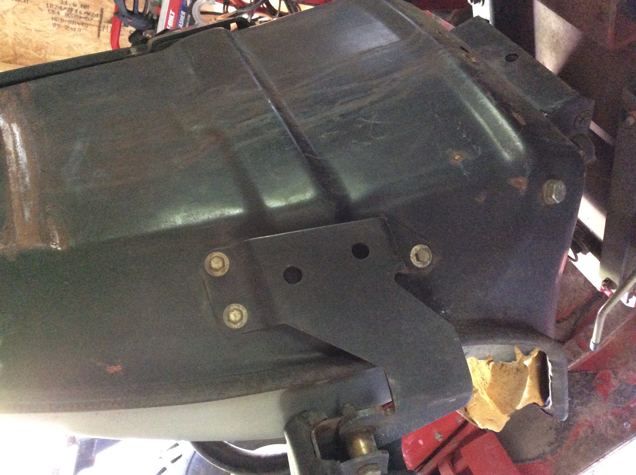

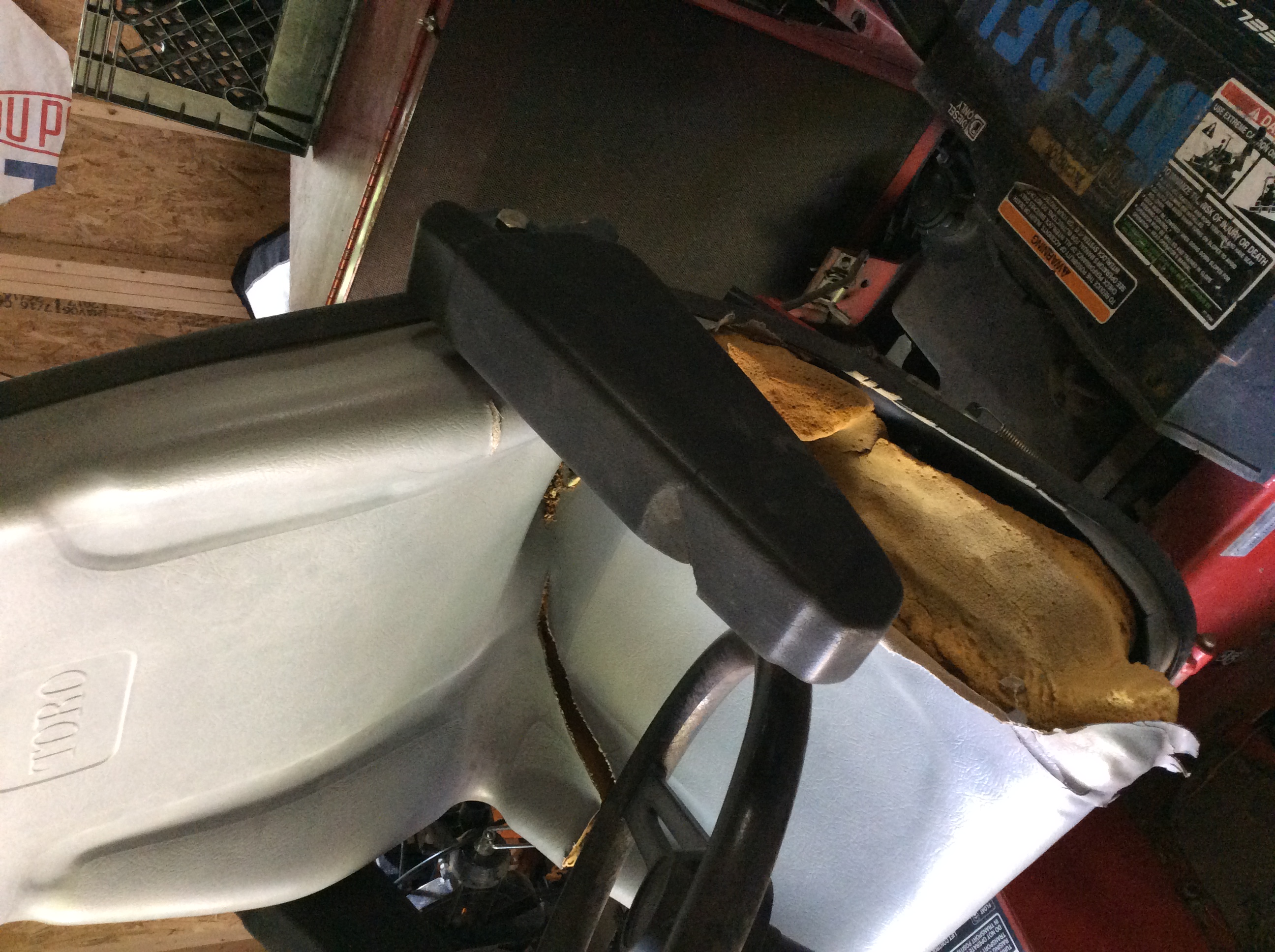

Forgot I had a junk seat with armrests on it. This is the style I am looking for though, still need one more set if anyone knows of a supplier. I plan to replace this seat and I’m pretty sure these armrests will just swap over to the new seat.

The armrest kit is Toro 30707 but appears to be nla.

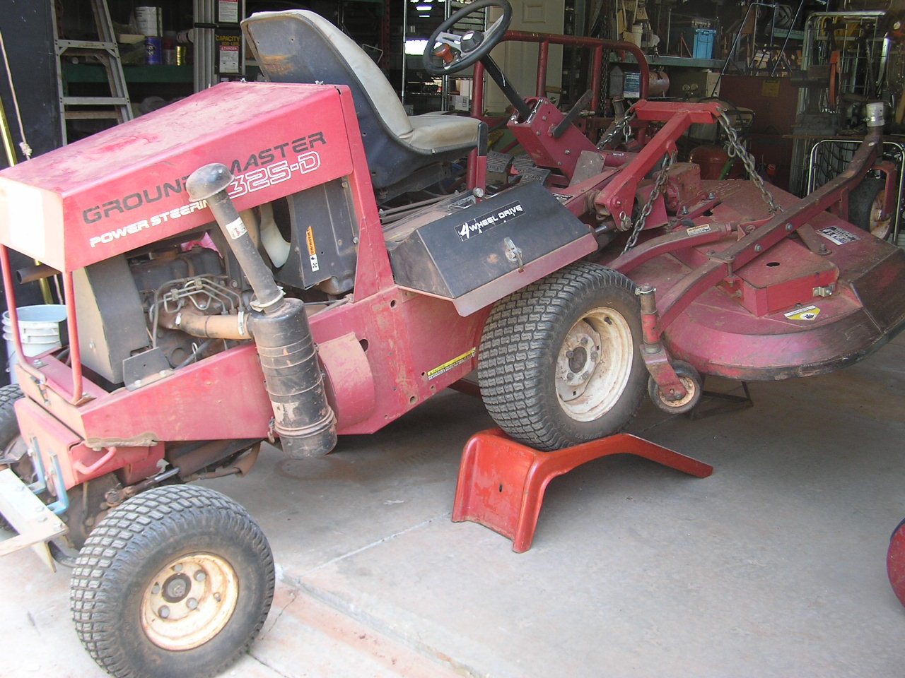

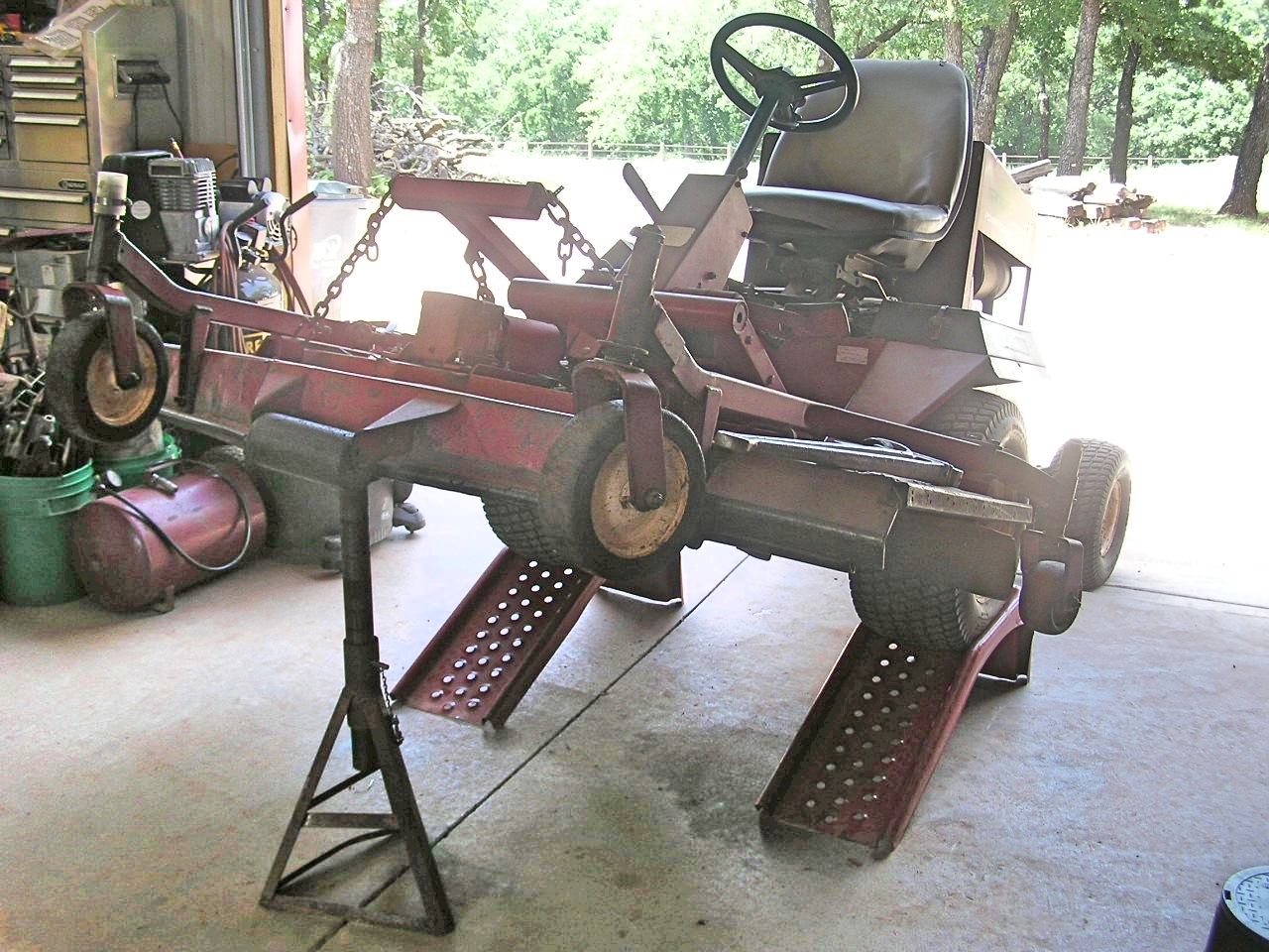

If you have the correct driveshaft for the side discharge deck it can't come out.
I set the front chains for max lift, 11 links, like the operators manual shows.
If you have a set of car ramps, you can back up on them and lower the deck to verify the drive shaft won't pop out.
I use them to access the underside of the deck:
   / any toro groundsmaster fans on here? #719
I feel pretty silly. I couldn't figure out how to get the toro up on ramps with the deck on. Looks like it would work pretty good for cleaning.
   / any toro groundsmaster fans on here? #720
Figured it out. I need shorter ramps. My ramps are too long to fit between the wheels
