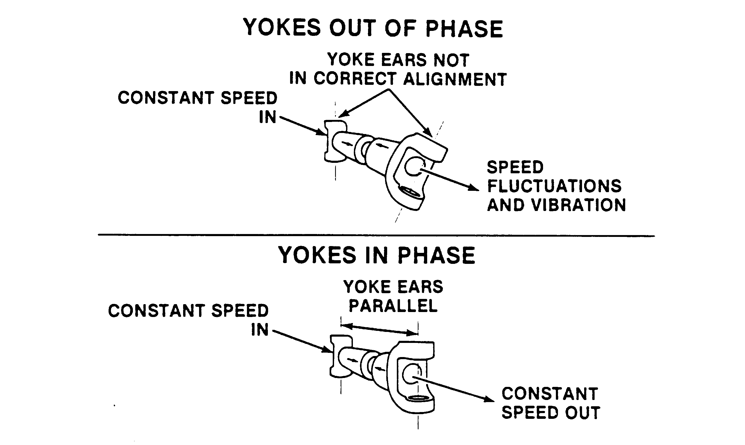

Installed with red Loctite on the bolts. It's important to make sure the yoke ends are properly oriented before install to avoid premature failure of the universal shaft bearings.
For those that don't know about drive shaft phasing, a picture:
   / any toro groundsmaster fans on here? #792
Yup, that’s it. I never really understood the physics behind it, but that helps clear it up a little bit.
