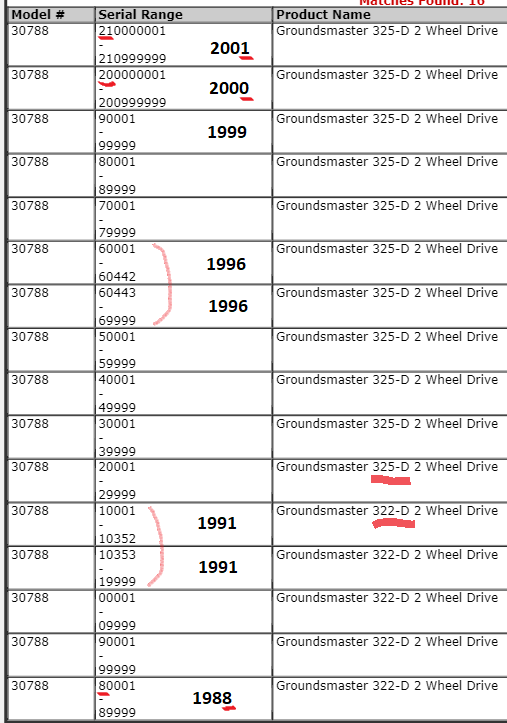

I am new to this forum. I just acquired a groundsmaster 322d. Model/serial 30788 - 91288
The hood says 332d but the numbers may reflect it being a 1999 325d (IDK?)
If the hood is original it is a 1989:

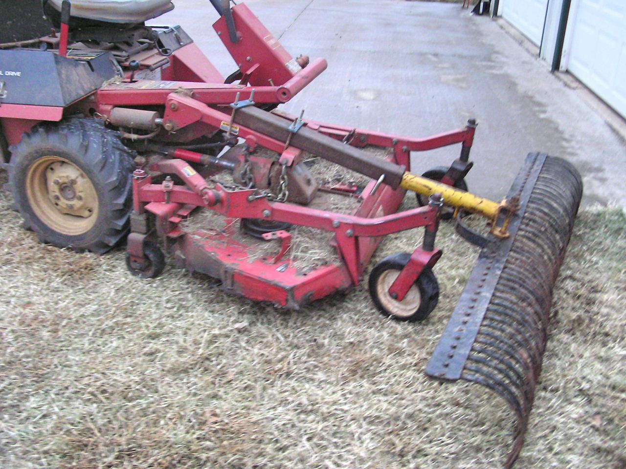

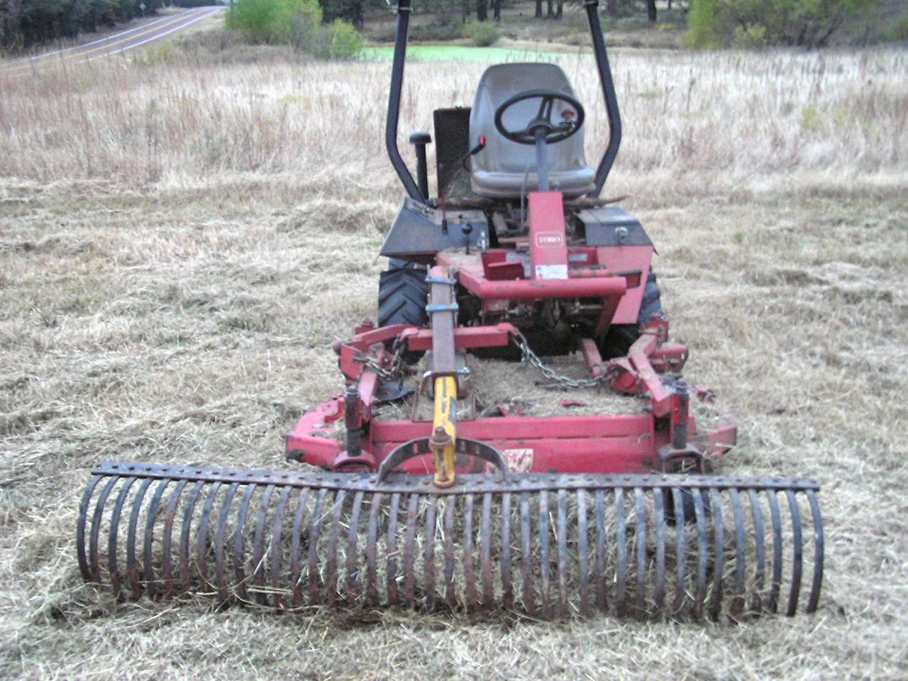

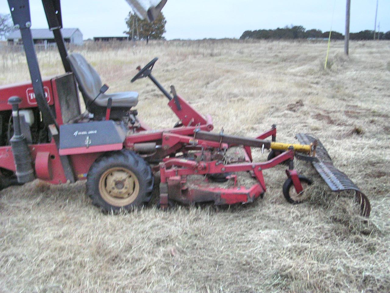

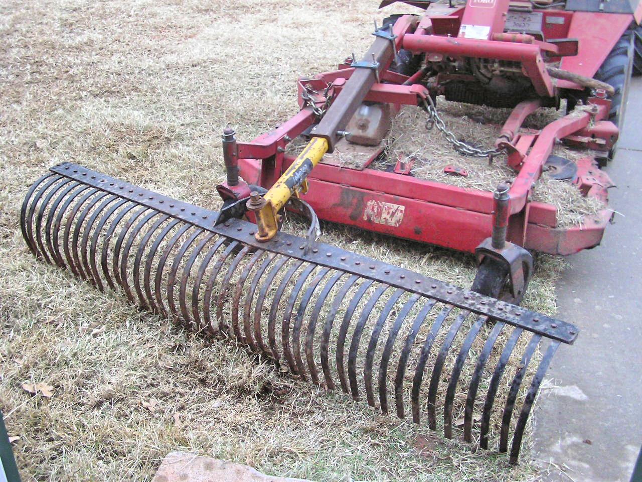

Needed to use the landscape rake and didn't want to get the Toolcat out. Remembered when I got my first traction unit I had clamped a receiver hitch onto the lift arm back in 2004:
Since the rake fits in a receiver, I clamped a long one onto the 328D's lift arm:
And raked some long stuff:

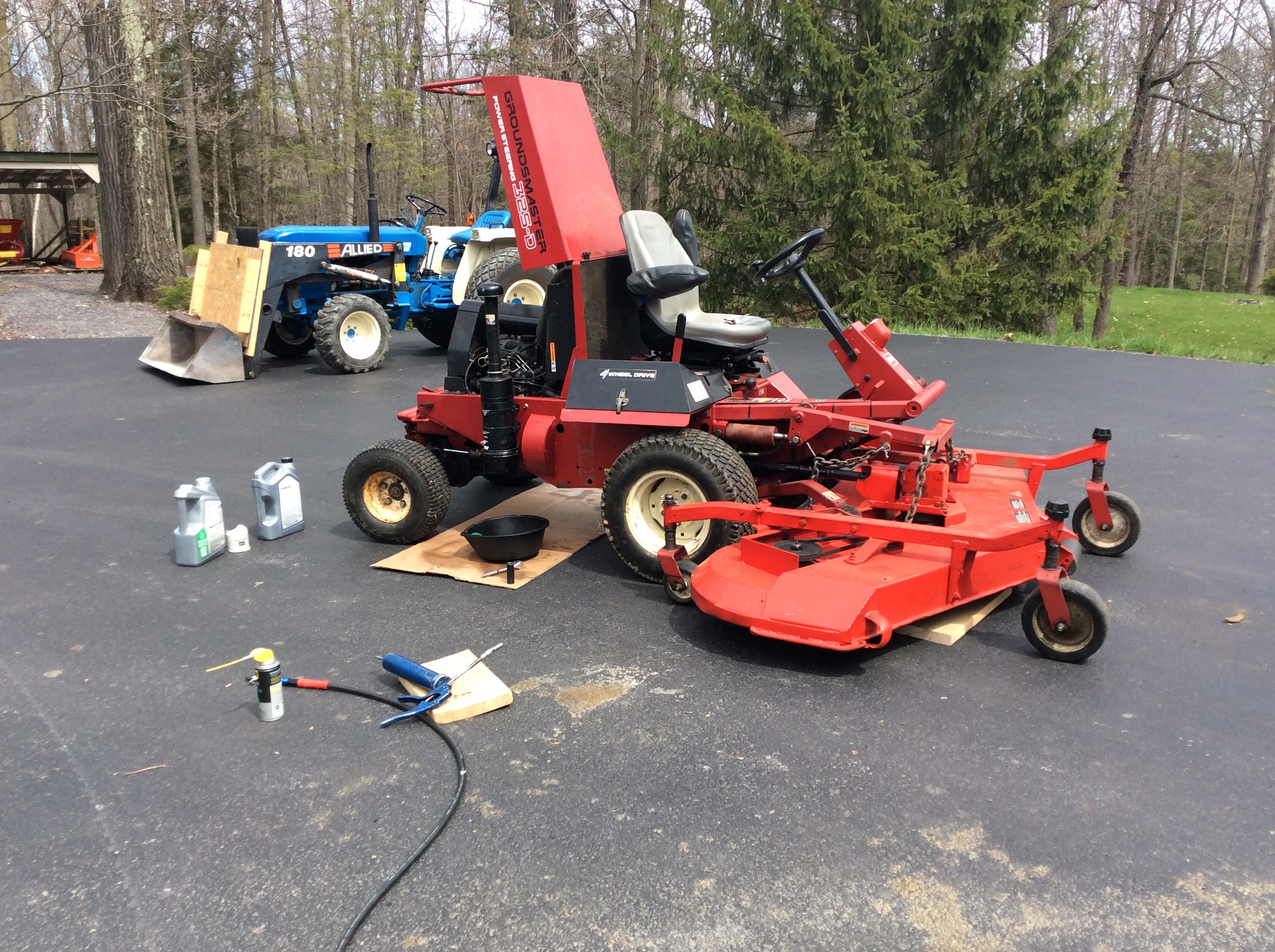

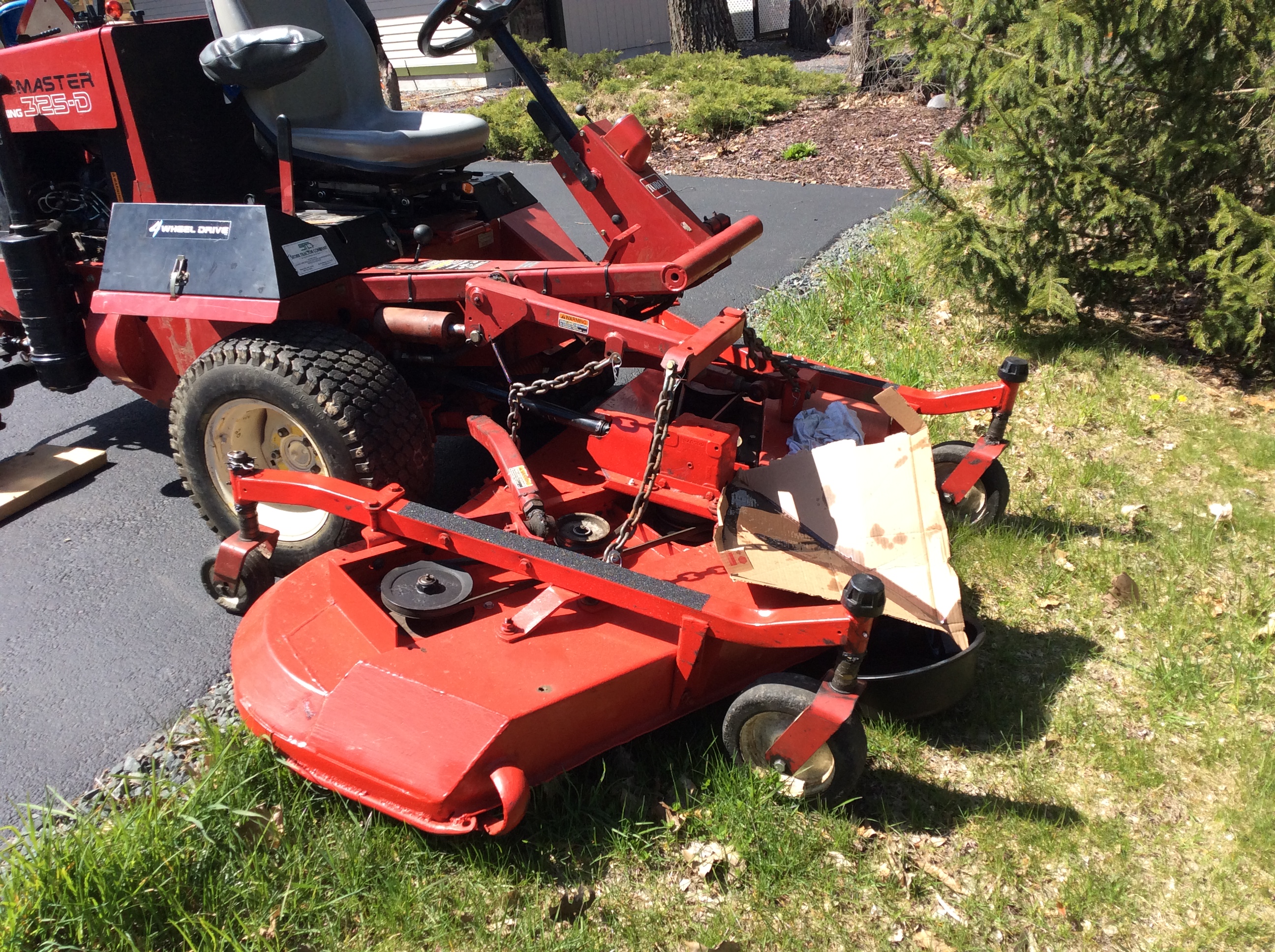

Pulled the Groundsmasters out today after a long Winter sleep. Did a complete service, we’re ready for the season.
Changed the mower gearbox oil today. I figured after two seasons it was time. After draining I could tell it was pretty filthy, so will be changing every season from now on.
