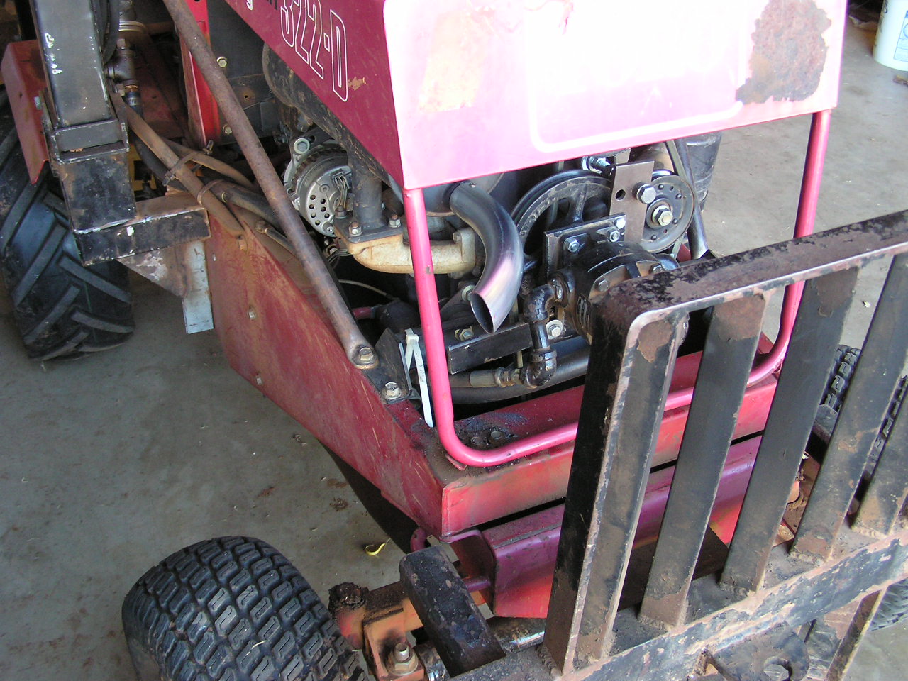

It’s been awhile since I first contributed to this thread about my GM 52 that I purchased new back in the early 1980s. Still have it and use it regularly. Wife now uses it mostly, and would like for me to get another older GM to she can get some help with the 3 acres we mow now. Not wanting to purchase a new one, as there are none like the old GM 52 being made these days. But, there are always GMs to be found online. Most are diesel powered. This is why I am posting this question: Don’t the diesel powered Groundsmaster mowers, like the 223D or 328D, overpower the operator with diesel fumes? I ask because I had to tip the exhaust pipe to vertical on my small diesel utility tractor because the fumes would sicken me. Wouldn’t a tailwind blowing diesel fumes over the rear hood onto the operator of a Groundsmaster be somewhat sickening for the operator? Several GM diesel owners here....what are your experiences with the Diesel engine fumes on these units?

I have several diesel GMs and have never had a problem. I too am sensitive to diesel fumes, but never have a problem. Only time I really smell anything is when I’m turning around at the end of a row or something.

No problems since the exhaust is at the rear and pointed back.
I even routed it to the left side on the loader because of the counterweights and don't smell the fumes:

Good to know this. My yard area has lots of big trees, so there is pretty much constant circling around them or flower beds, buildings, etc. Not many longer straight stretches here. I guess it might be best to give one a tryout before buying to make sure frequent turns won’t be an issue.
