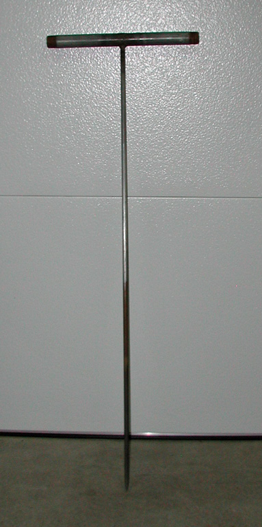

Another way to find it which is less work than pressure testing is to use a probe. Probe about every 2'. The probe will go into the ground much easier in the proximity of the leak.
You can probably probe the entire length in less than half an hour.

I've used a probe like the one in your attachment to locate water pipes, as well as to find the softest spot. And I've used a mechanics' stethoscope to hear a leak; just keep moving closer to the sound.
