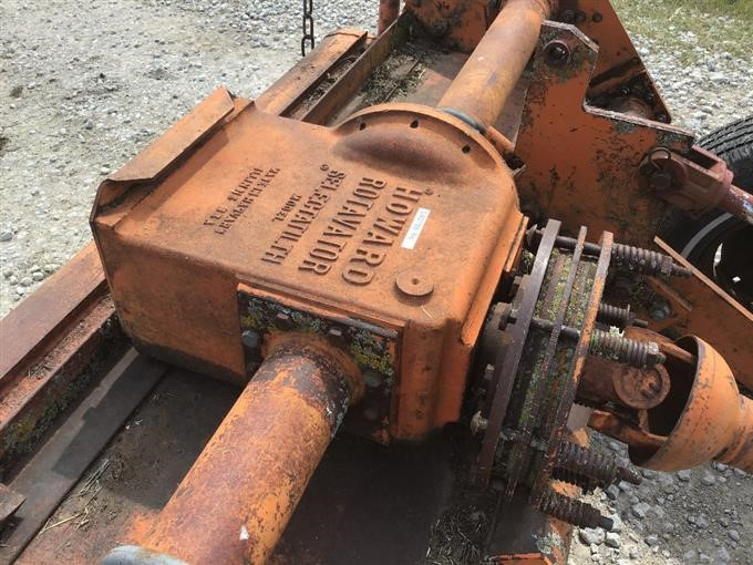

That's most likely something someone put together to make it work. The factory setup has a built it slip clutch as shown in the picture below.
Awl right. Thanks for your posting that picture. You may be right. At least now it begins to make more sense.

OK. I'll play. Why in the world would someone take the trouble to invent a coupling like that instead of using any of the spline & U-joint couplers that are available as a standard part?

The Howard pictured, was invented before those "standard parts" you talk about were invented.
Many years ago, nothing was standard.

I think that's true of a lot of things. People forget that there was a time when everything mechanical was made "in house" and very little was mass produced. And probably true of the Howard parts as well. I didn't start working with mechanical design until the late 1960s. So that's as far back as I go with standard parts catalogues.
You make a good point. A book on the history of mechanical design would be an interesting read. Not much has changed in my lifetime in the world of joints, gears, bearings, and couplers. Some materials are different now, but not much change in the way they transmit forces or basic dimensions and geometry.

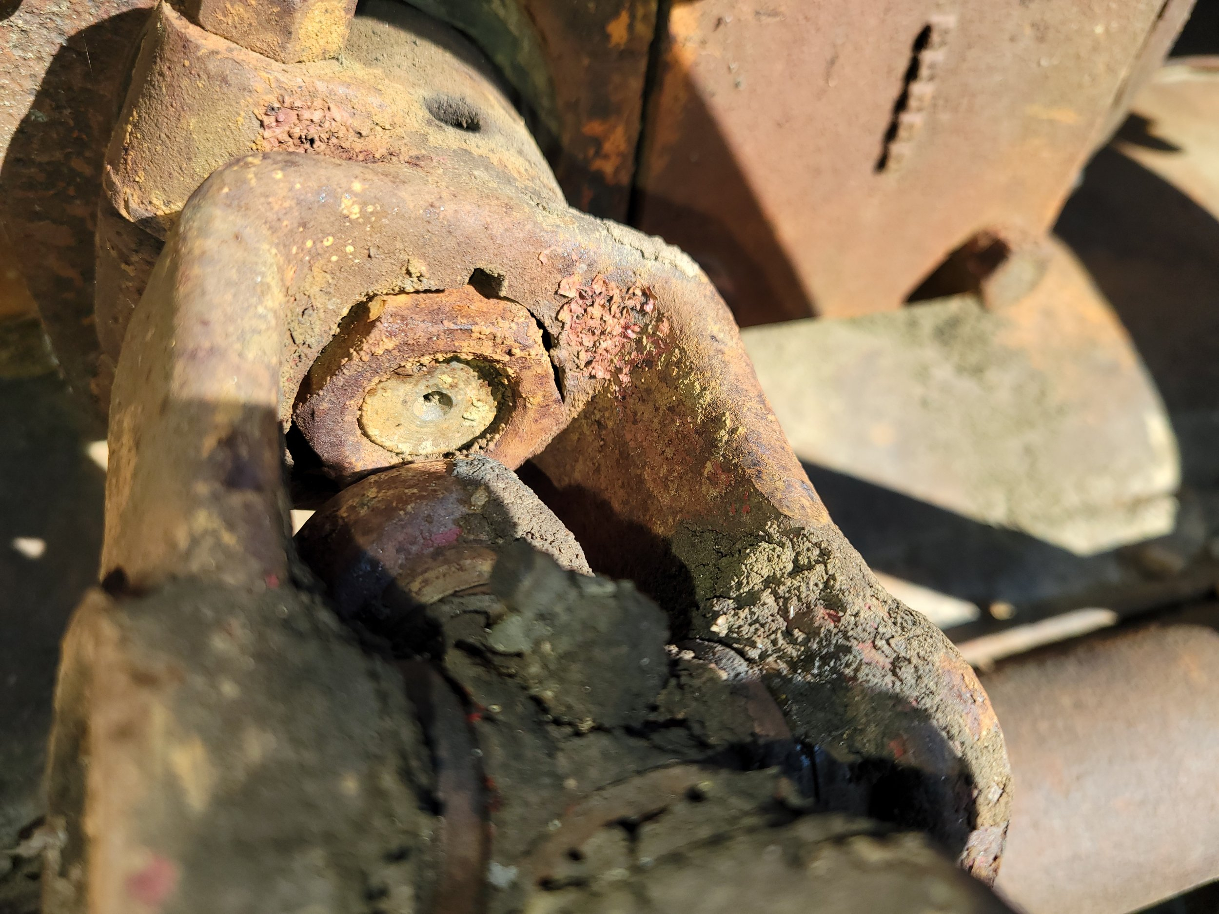

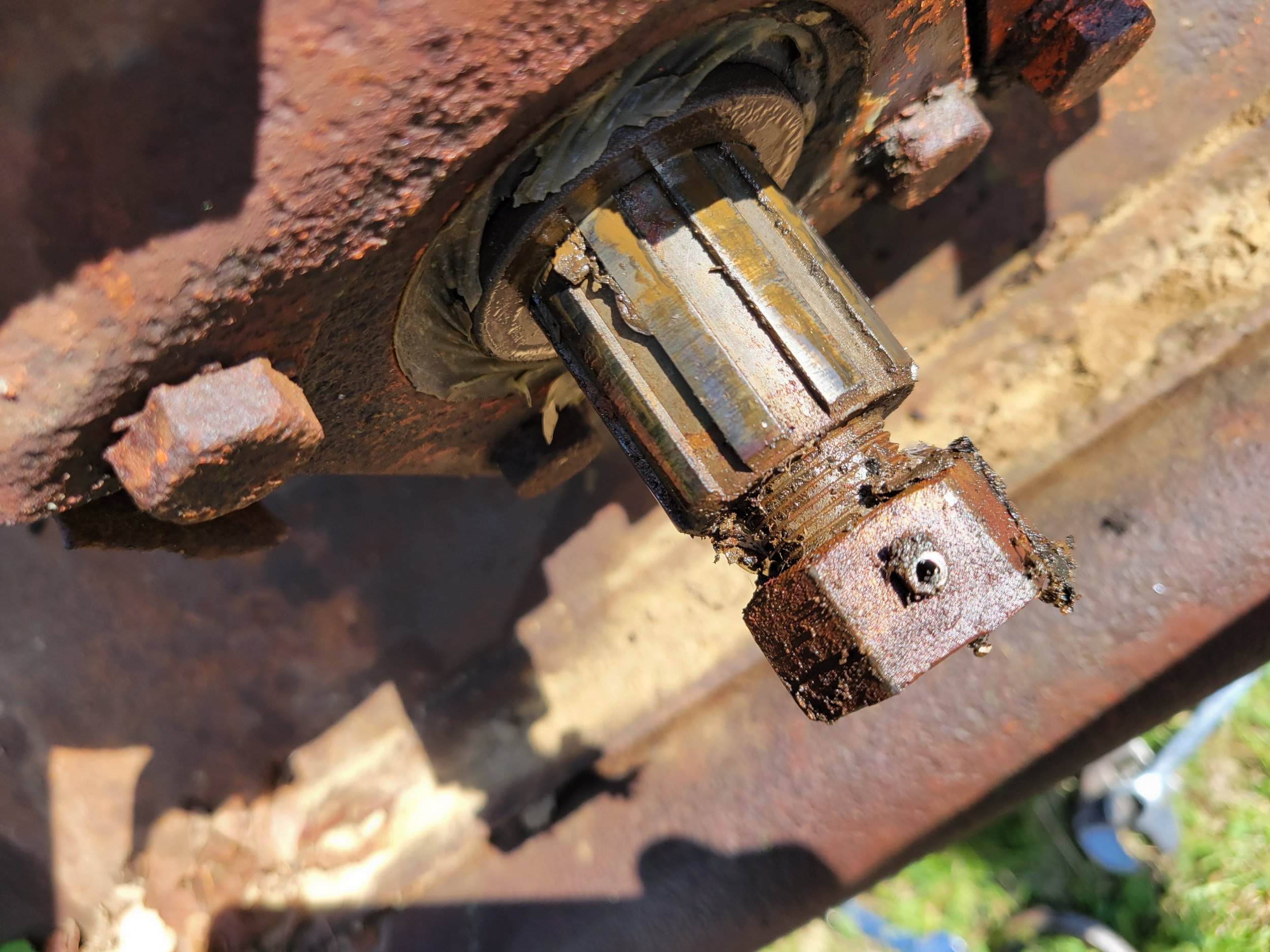

It's a male 1.5" Dia by 10-spline the mating part I suppose came from the maker in the 1960s is not a female spline it uses two removable keys and a squishy-nut-&-bolt to compress the connection the yoke is split for the squishy.
But it gets better.
There's a honkin big hex nut on a threaded component on the end of the male spline. The nut is pinned to the threaded member.
View attachment 763445View attachment 763446
That almost looks like a one off someone did because the decided that shaft was never gonna slip off again. How did you get the pin out? I don’t see a hole on the coupler you could push it through from the top.
