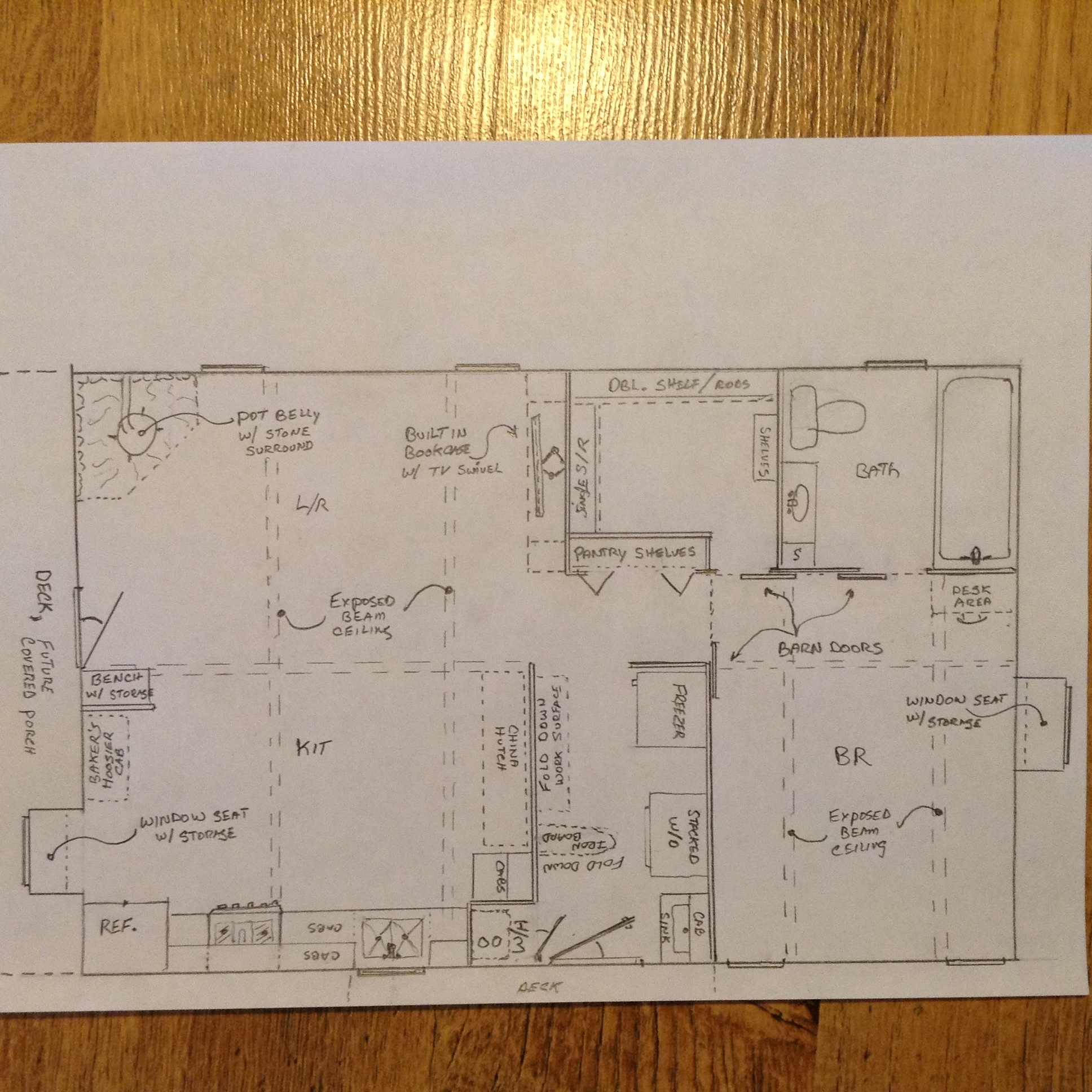

Yes, we have and live in a 'tiny house' ....well, basically 2 of 'em put together like a doublewide. It's just under 600 sq ft.
Full eat-in kitchen, full laundry room, bedroom w/ walk in closet, living room, full bathroom.
The bathroom is 5' x 7' and is more than ample. Sink, full tub, real toilet (real plumbing to septic not a composter)
Tub across the 5' width, sink and toilet opposite 5' wall. Barn door in the middle.
I was trying to attach the drawing I have, if you want, I can retake a screenshot tomorrow.
/ Anybody built a Tiny House? #5
Found a copy of the tiny house.... it shows the bathroom layout

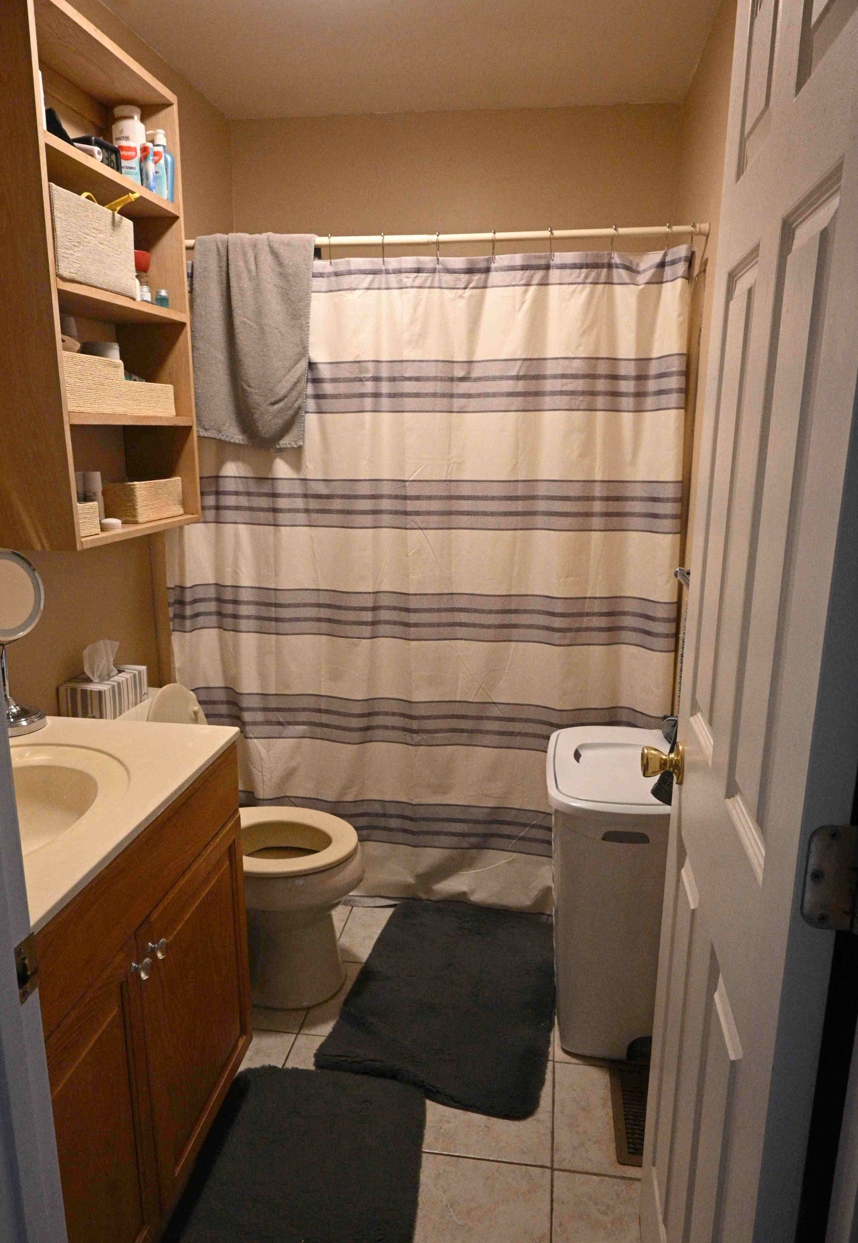

Here is our 5' wide x 8' deep bathroom. The doorway is 28". Distance from vanity to wall is 36". Distance from toliet to wall is 30".
Working with a 4' wide space would make it tighter. Is there any way to stretch it to 5'?

Really tight on width using just 4 ft (internal dimensions or ?). A shower stall on one end and a toilet on the other would be possible. In between on the back wall could be your sink/vanity. Not the best plumbing layout but sometimes you have to work with what you got.
/ Anybody built a Tiny House? #13
Wonder if the op would compromise on a toilet under 30" depth? I think that will stick out the farthest in that 4' wide room and you can run all the vent, and supply lines in one wall.

^good assessment. Standing in our 5x8, I wouldn't want it any narrower if it could be avoided.
