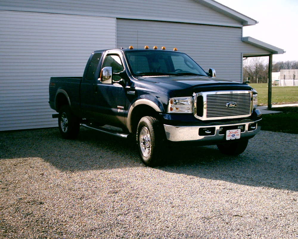

We actually finally agree on something. My dream truck would be my 2006 F-350 SRW 4x4 with the high gvwr setup I have. I would love to see it packed with the old 5.9L Cummins and a rear end with a locker even if it were the GM 11.5" I am not sure what tranny I would want. I did like the Allison in my 05 GM D-max 3500, it was the only thing on that truck that did not give me problems, but I feel the Torque Shift in the Ford does a little better job for my needs towing trailers in the 12K-16K range with surge brakes. The Allison did not seem to like or handle the surge brakes as well. Everything over the 15K-16K I tow has electric brakes so it was less noticeable.
Chris

I'm just wondering about these guys online claiming to get 25 mpg with a crew cab 1 ton dually 4X4! I mean, c'mon now, isn't that fudging just a bit?? I don't think I could get 25 mpg with either of my trucks if they were being towed on a trailer, going downhill with a strong tailwind! :p
I do not own a dually and probally never will but do own two 6.0L Fords. One is a 2004 F-250 4x4 SRW short bed extended cab with 3.73's and the other is a 2006 F-350 in the same configuration. I have 4" exhaust on both along with a Quadzilla chip and AFE intakes. I average 17 mpg around town and 23-24 on the highway. Drive it smart, keep it at 1900 rpm (the sweet spot on the 6.0L), and get a chip that locks up the torque converter earlier and you will see the same.
Chris
