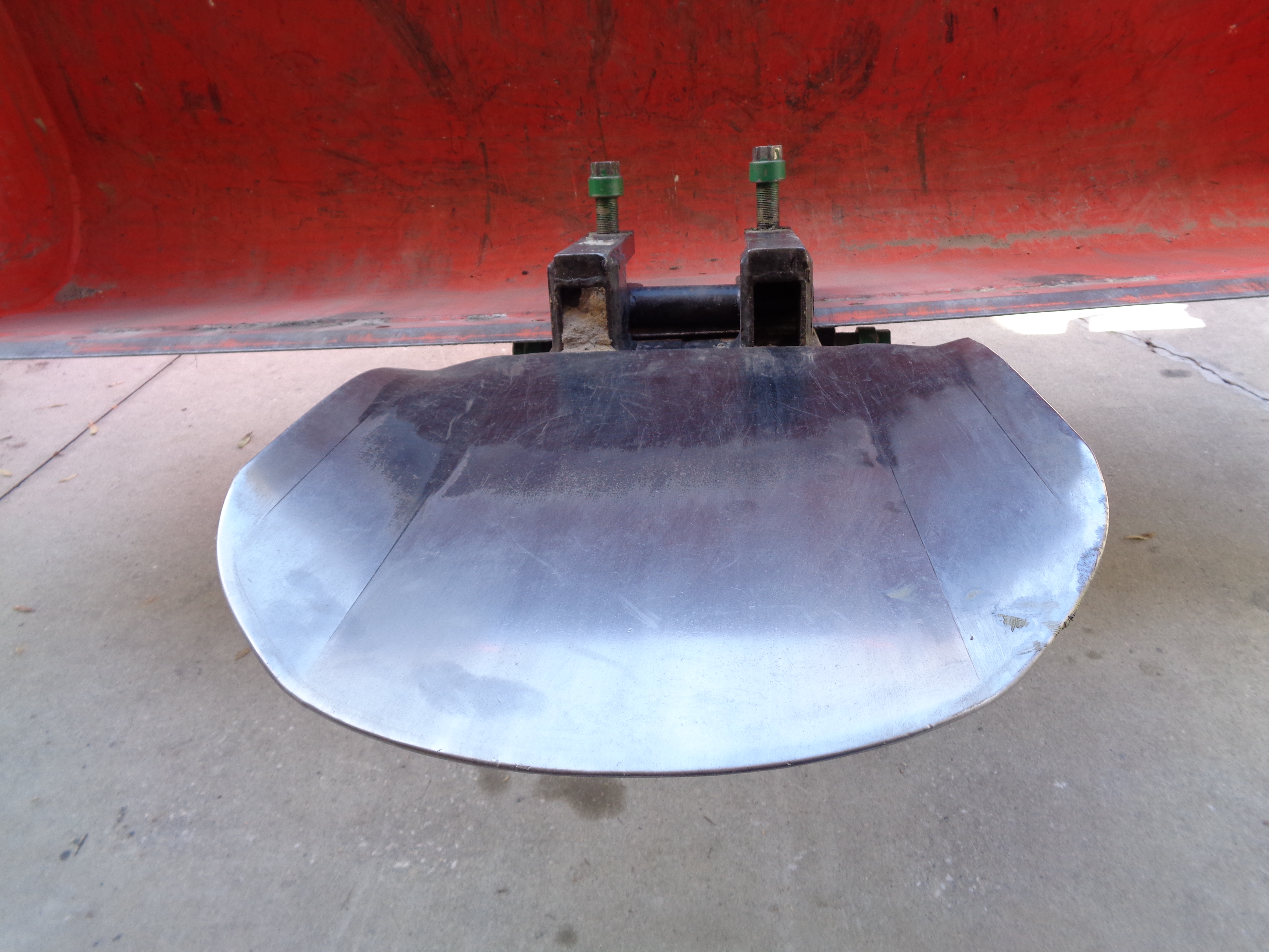

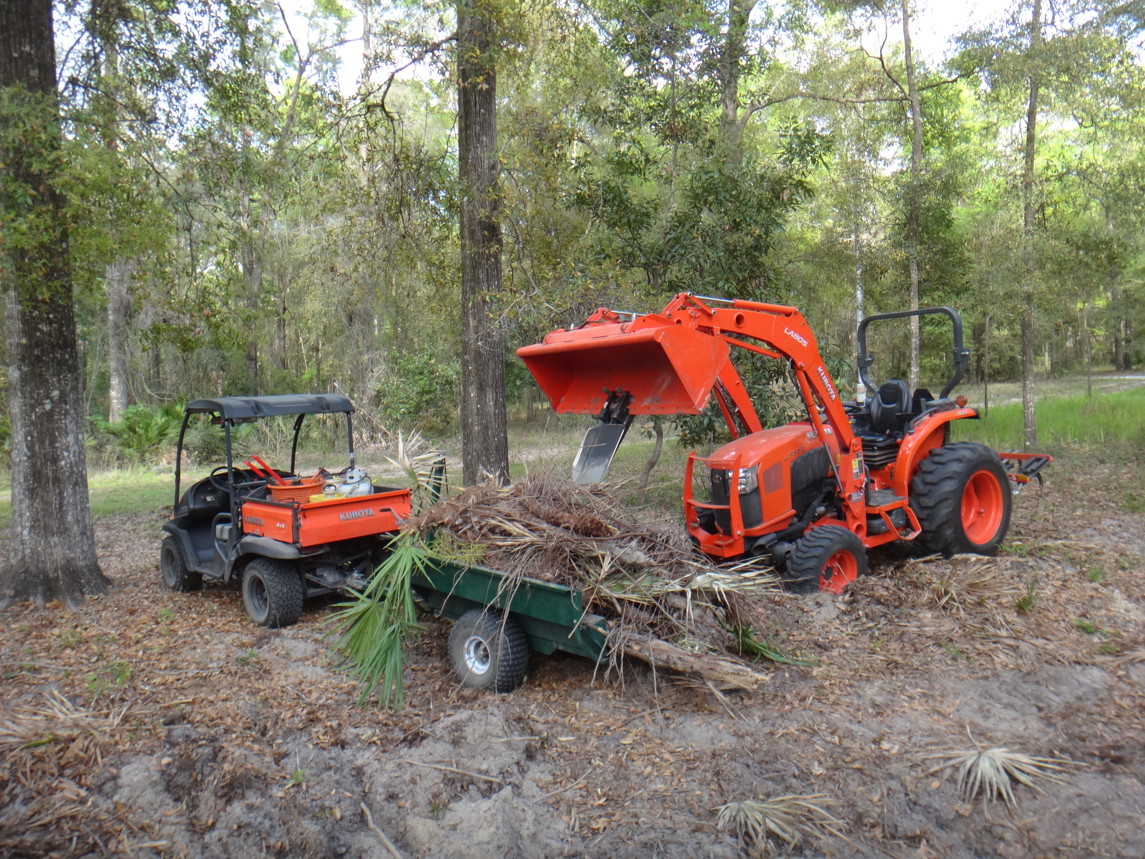

A Bucket Spade is ideal for removing Palmettos. I have excavated thousands. Good for utterly deceased tree stumps up to 3" diameter as well.

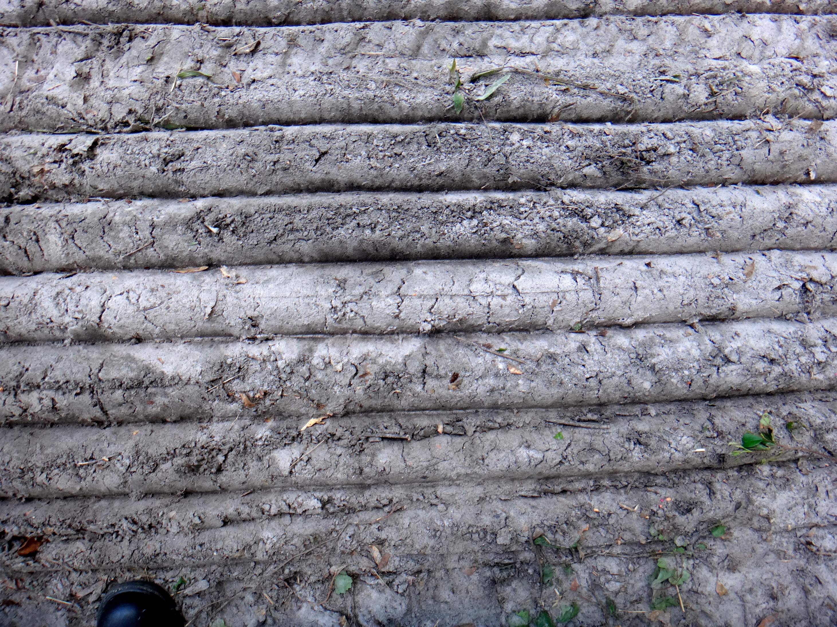

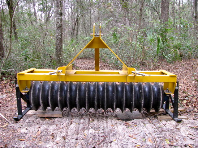

Many Florida food plots are created with only a Disc Harrow and a Cultipacker . PHOTOS #3-#4-#5. Those are the two implements I use for my small food plots totaling perhaps 2-1/2 acres. I also own a framed, "lift" Chain Harrow which I use for trail grooming but not food plots. Either will serve. Be sure to get your soil tested before planting. If your soil pH and nutrients are not correct you will get very low or "0" green germination. I plant fall/winter and spring/summer food plots, discing in the crop residue as green manure. Sandy north Florida soil improves each year.
