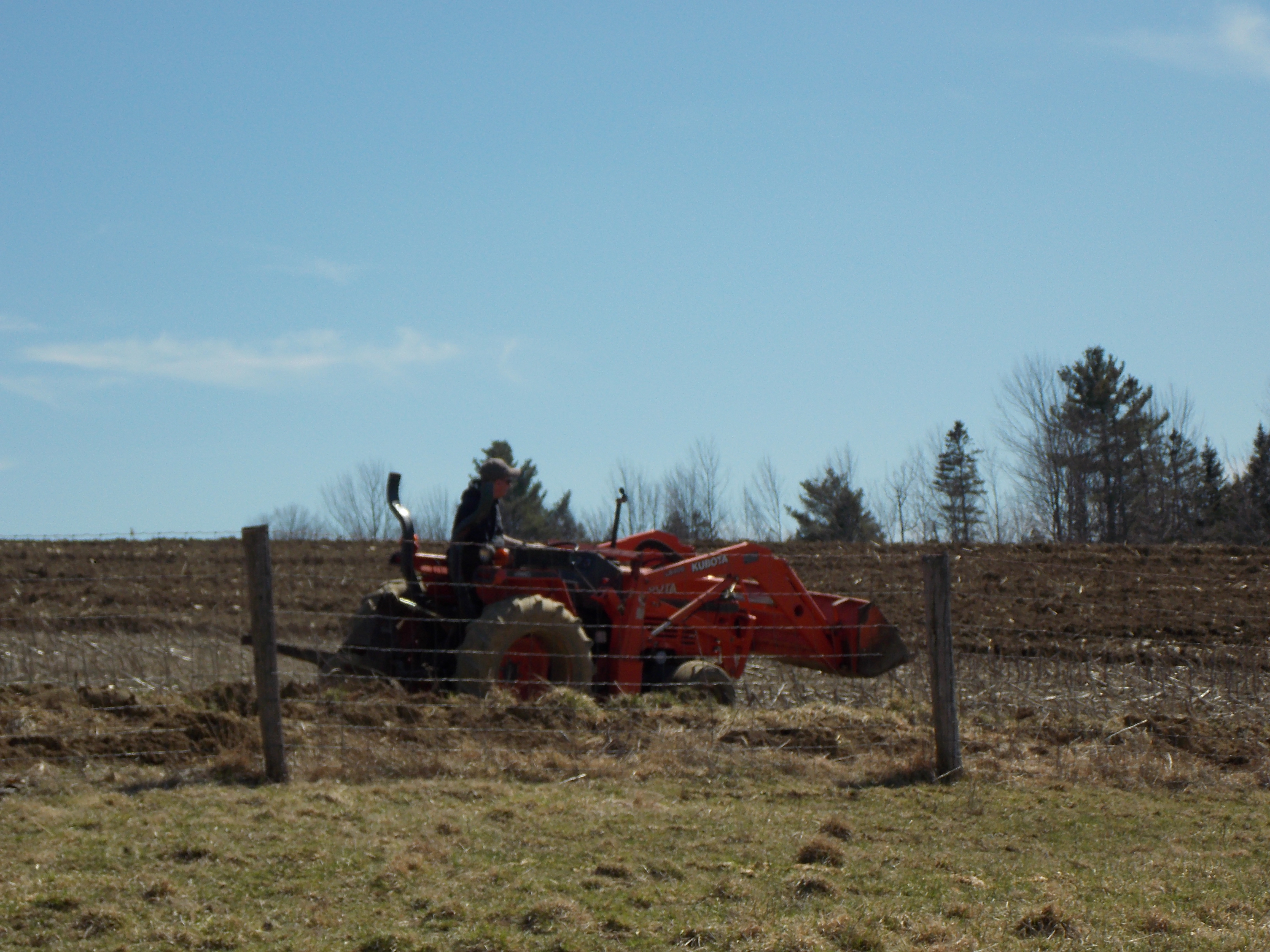

50HP = Plow 2 acres in a little less that two hours, (1-1.25ac/hr.)
30-40HP = Plow 2 acres in a little more than 2 hours (3/4ac./hr)?
So....for 2 acres, maybe the total time difference is 30-40 minutes?
I am retired, so I really don't see much difference.
For 100 acres it WOULD make a big difference.
Yea, not much difference.
But I didnt specifically jump to a MX from my L3400 just to plow two acres faster.
The most recent conversation in this thread is Darmstadter wanting to buy a MX to plow 4 acres.
With a MX, and a 3-bottom that would be a ~3.5-4 hour job
With a 30-40hp and 2-bottom that would be a 6 hour job.
Significant to him??? Maybe? Is it worth the extra cost and more compaction? MAybe? Only he can answer that. I'm just laying out the facts

HP is important for speed while plowing. But if you are considering a HST tractor that may be a moot point.
I plow with a 3-14 plow and a MX5100.
Medium range just doesnt have the power. Must stay in low which limits to ~3.5 MPH.
The 3-14 is a good match, traction wise, with loaded ag tires.
The OP needs to know that a 14" plow has about 20% more draft resistance (resistance to being pulled through the ground) relative to 12" plow(s).
A 16" plow has about 50% more draft resistance relative to 12" plow(s).
This is due to wider, higher plow contact with a wider plow, sunk deeper, moving a greater volume of dirt.
For breaking sandy Florida soil for a food plot a 12" plow of two or three bottoms should be ample. I recommend a two bottom plow to a plow neophyte. In north Florida most only plow once every ten years.
